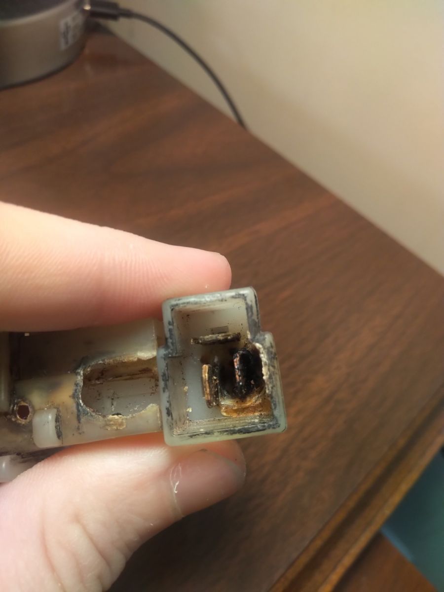

Heres an update, since I can't just leave a thread without saying the solution.
I believe I found the actual problem. I rode it around a little with the new plugs and it died again after a few blocks. The lights were faint and the turn signals stopped. blinking, so the battery was dead/nearly dead. I was most of the way to class, so I just walked the rest of the way. After class I pulled the two 10Amp fuses leaving only the important one and rode home with as few stops as possible.
I charged the battery, put it back in. My multi-meter was showing 12.5V off and 11.6V when running, which meant the charging system was shot.
WIth much difficulty I disconnected the stator from the reg-rect. This is the connector.
Yikes.
Tested stator, it was giving some AC voltage.
I bought a "new" reg-rect and connected it. Charging system was working now.
Since I broke those glass tube fuses and they are a pain in the ass to find, I replaced the fuse holder with an automotive blade style one.
I still will adjust points and jetting soon.
Yikes.
