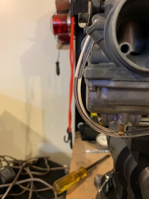

Thanks for the article Your_Boy_Yuriy. Lot of good stuff in it. Going through a "wet test" of the fuel bowl level is having the level about even with the bottom of the carb body acceptable or too high? All the fuel levels about very close to the picture I have attached. Thanks...

- Posts: 8024
- Thanks: 2562
Re: Another VM26 Question(s)
05 Oct 2019 17:33
Generally, the fuel level is near the bottom of the carb body, as yours is. However, the factory service manual has the correct height listed in it. It would be much less frustrating to get it exactly right now, than to have to pull the carbs again and redo the adjustments.
05 Oct 2019 17:44
The level should be 3-4 mm below that edge. They tend to be high for some reason though. Maybe the float needle spring gets weak? Anyway, I adjust them to be in spec because nothing worse than gas spilling on the engine and ground.
06 Oct 2019 06:08
So they are all a bit high I take it. I was trying to find a good reference point for the level. I will bring them down a bit.

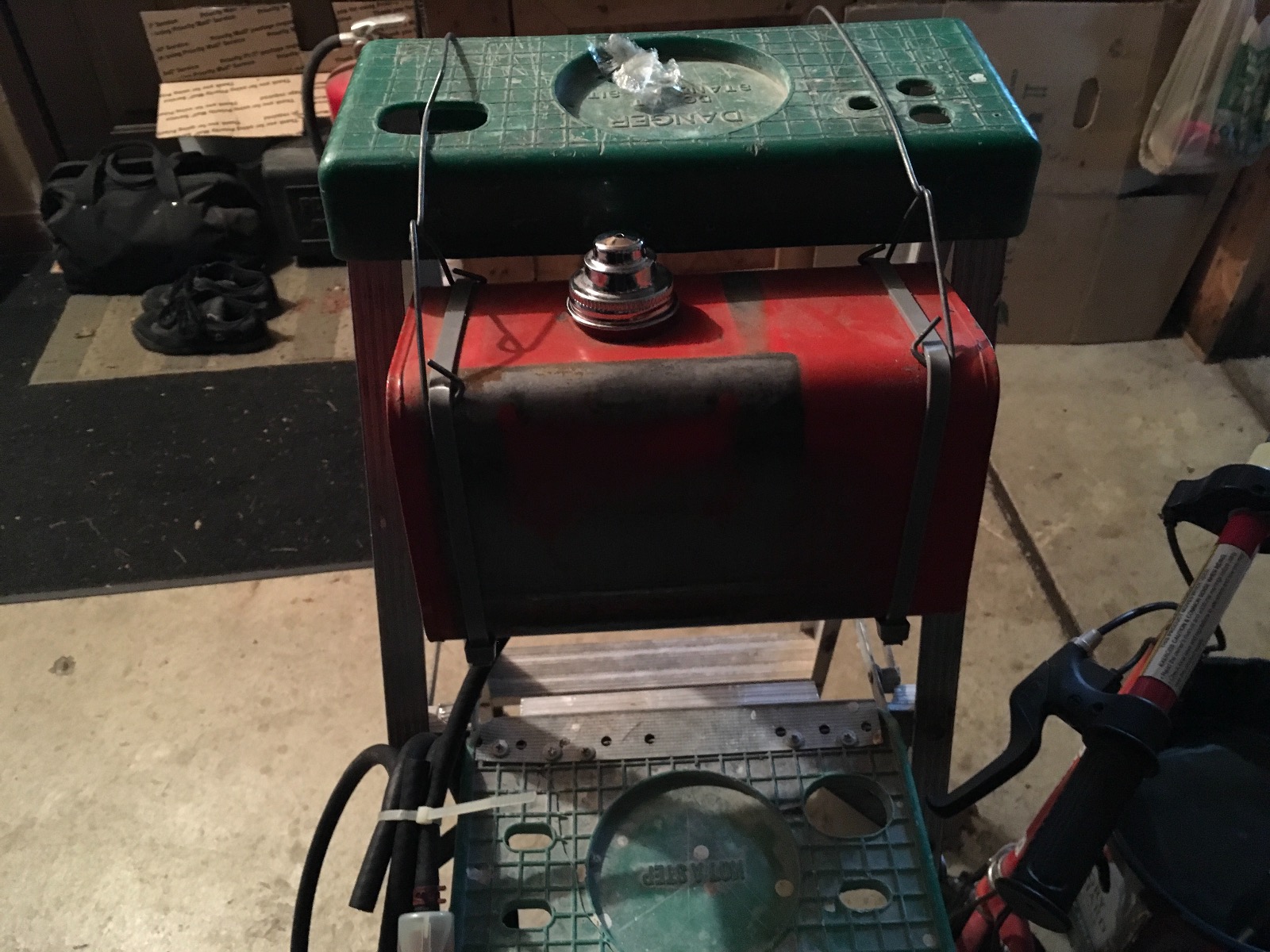

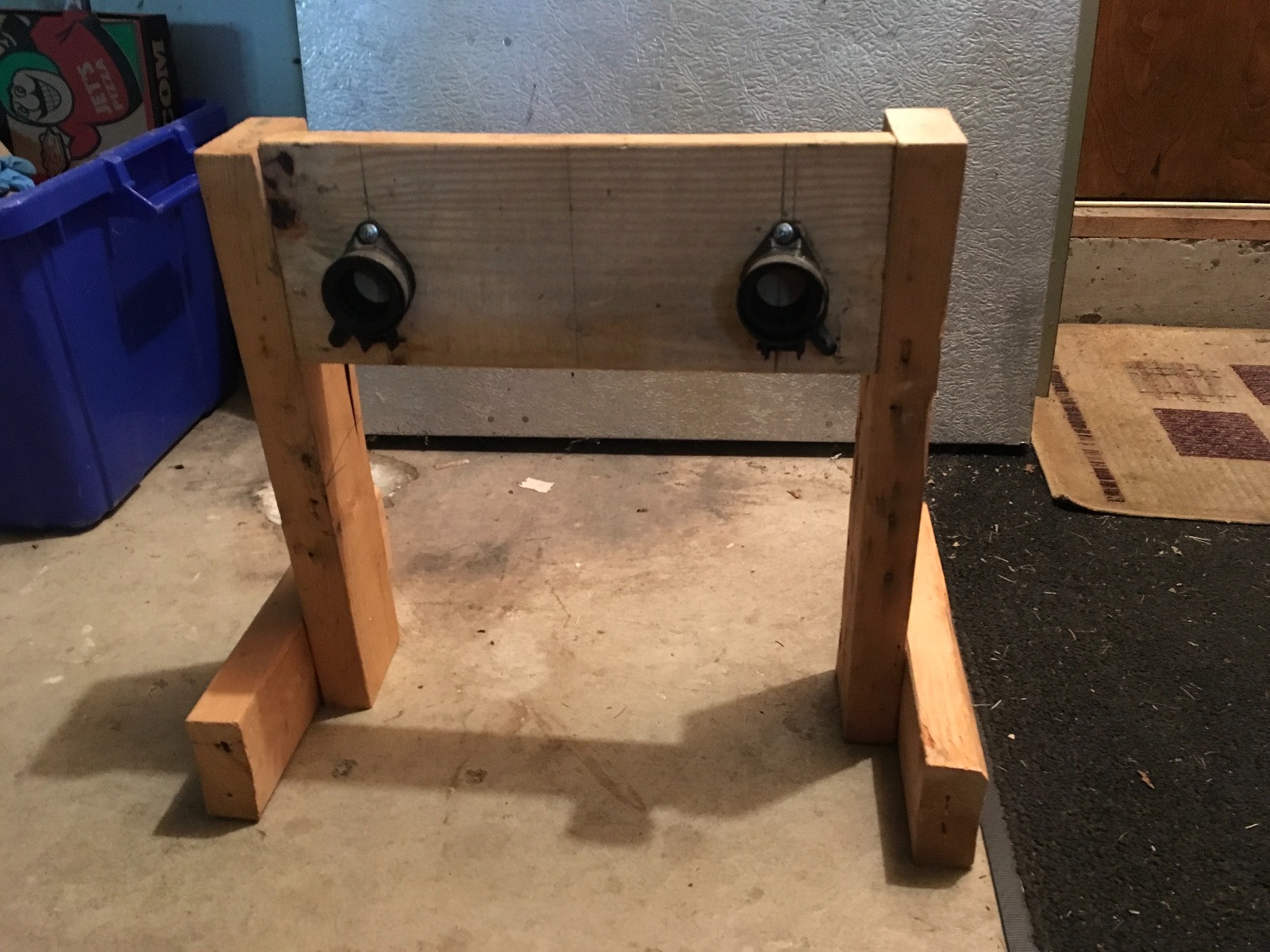

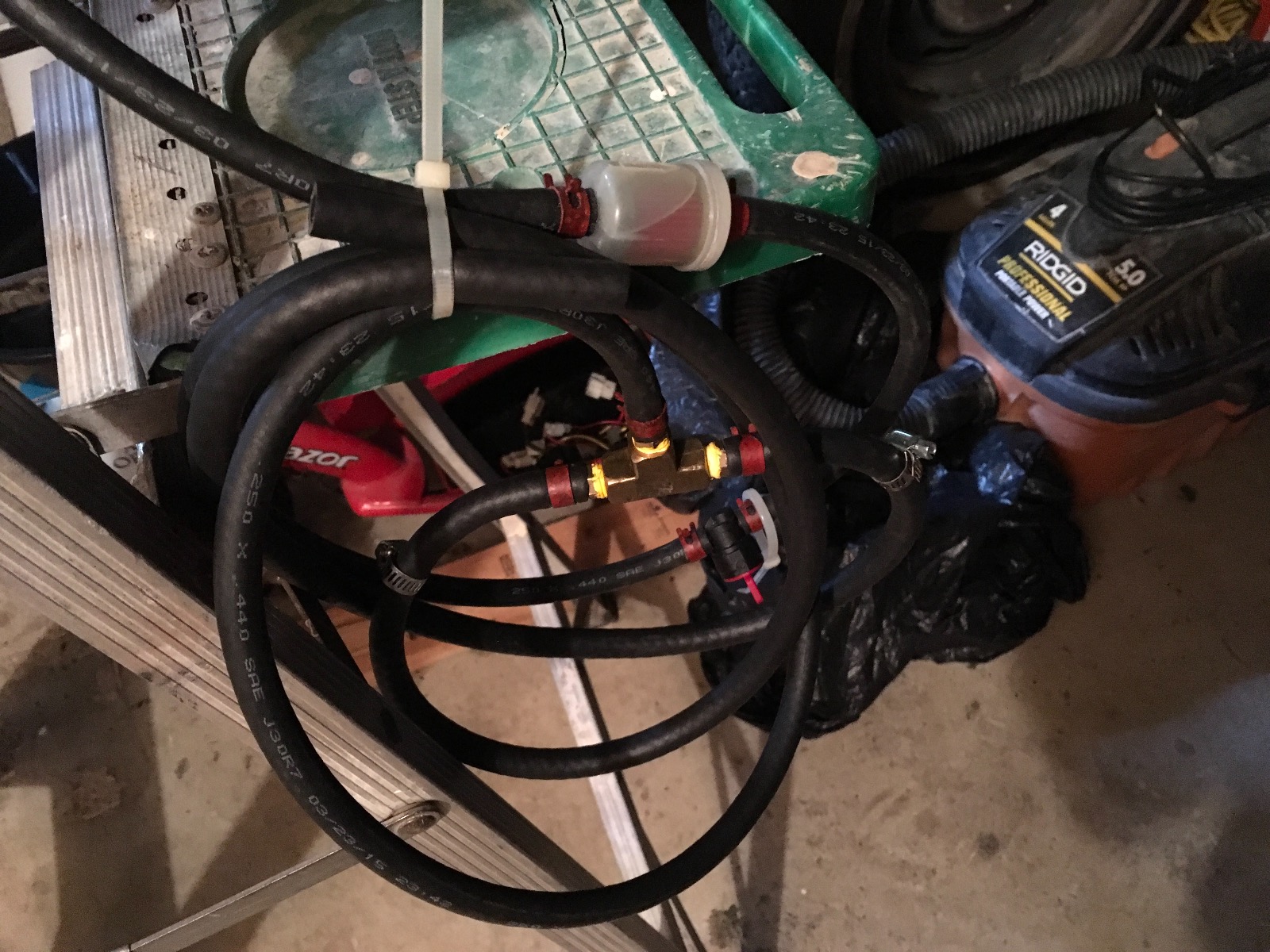

06 Oct 2019 11:17
Rick h I recently built this in about 20 minuets. Mounted the carb rack to it then I set it on my bench and used bar clamps and shims to level the carbs. I just went thru a float level adjustment. Used an old lawnmower tank for fuel supply. And the clear tube to set the floats. Have patience and be extermly careful with fuel. I put a shutoff in the fuel line and filled the bowls, checked the level, drained the bowls, bent the float tang and repeated till all were set. It’s a PITA.
