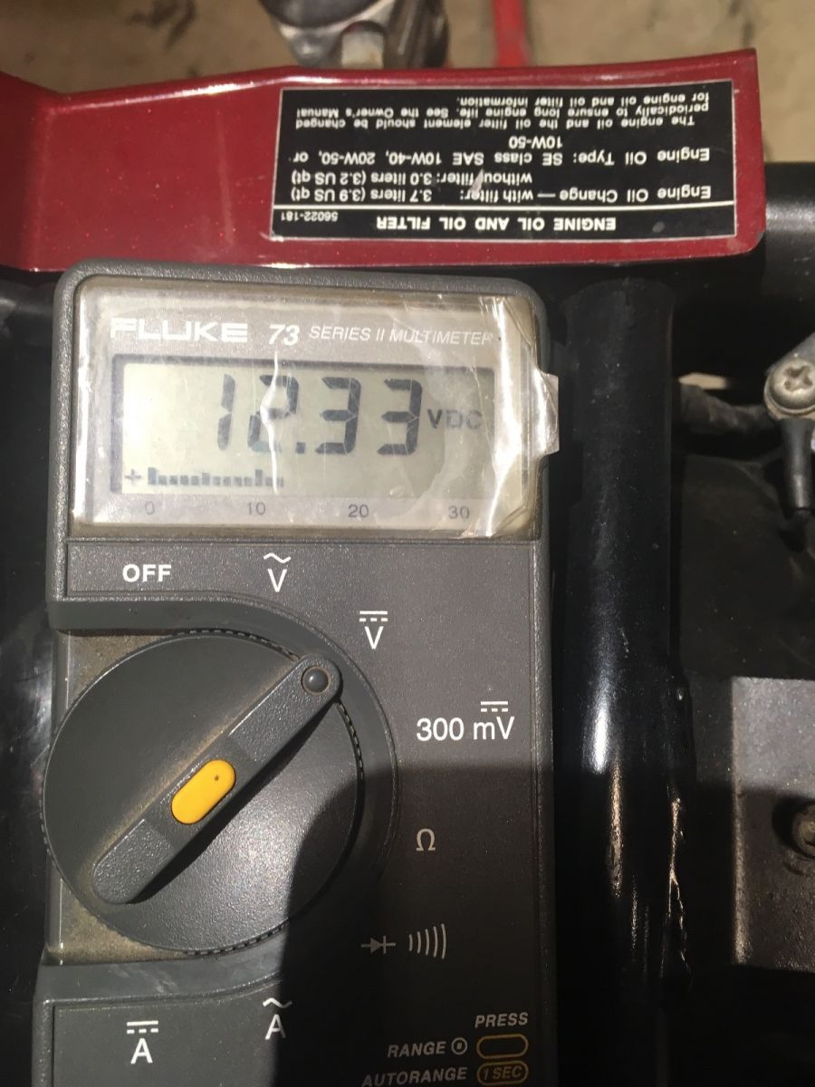

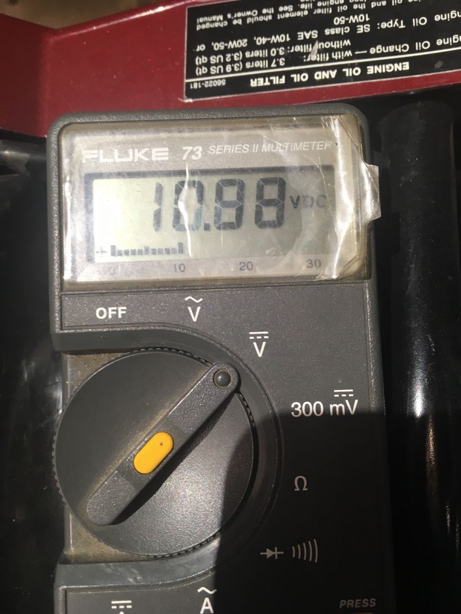

Brand new AGM battery. Changed it at 2 amp overnight. Then charger automatically turns to a trickle charger for maintenance. I will test voltage is evening
Steve no testing I’m doing is not running. I’m confused as to why voltage drops so much when the dyna pick ups are powered.
I’ve gone through and cleans as many connections as I can find. Including all bullet and the pin connectors at the electro plate. Checked the fuses and tested voltage across them also. Everything test out within a half volt. Until I Power the dyna pick ups. Then voltage to coils drops about 1.60 volts

Maybe that’s the norm and I don’t have a problem. What voltage do you get at the coil primary’s
Mine at rest ignition on, the coil primary voltage is about 1.60 volts less than battery
