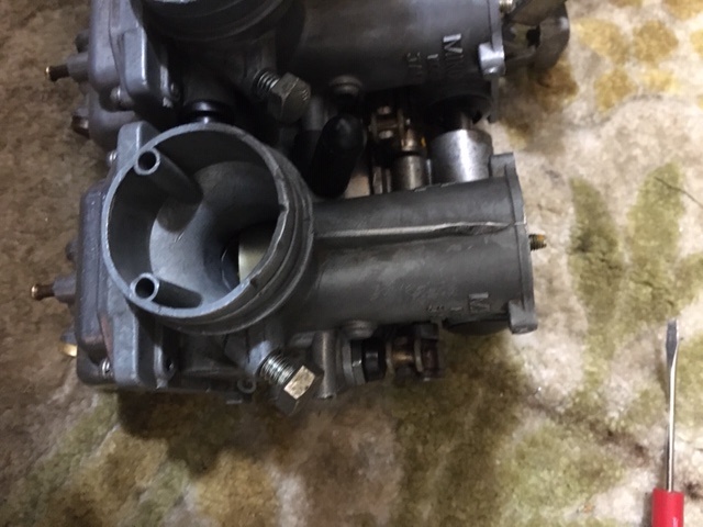

Hello,
I have a set of VM26 carburetors at home, that have both fuel and air mixture screws. Sadly the air screws threads are destroyed. So I re tapped the threads to a different size and closed off the hole with a larger bolt. Will this work? Because I know that some variants of the VM26 carburetors only came with the fuel screw.
When I get home today, I should have the carbs ready to be installed back onto the bike. but I am wondering if this is even possible?
FYI: Its for a KZ750, 4to1 and pods
Thanks
Yuriy

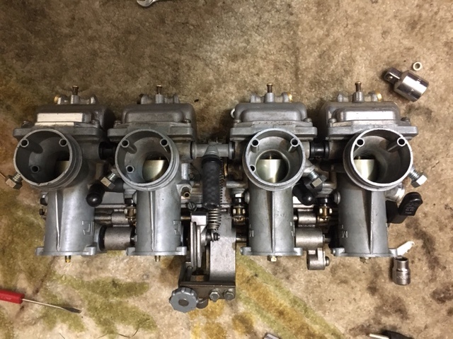

Pictures of carbs please

I'll add some pictures when I get home.

Here what I did, The bolt isn't long enough to block the air passage. I haven't had time yesterday to put the carbs back on.

What you did is equivalent to having the pilot air screw wide open, leaning the mixture.

I know, I had no other options besides completely closing the passage. However, it should still work though, HOPEFULLY.

When faced with a similar stripped thread problem I was able to repair the carb body using a custom made brass bushing. The carb body was first reamed to make the hole round and then the bushing, with internal threads for the pilot screw, was pressed in place. Worked perfectly.
