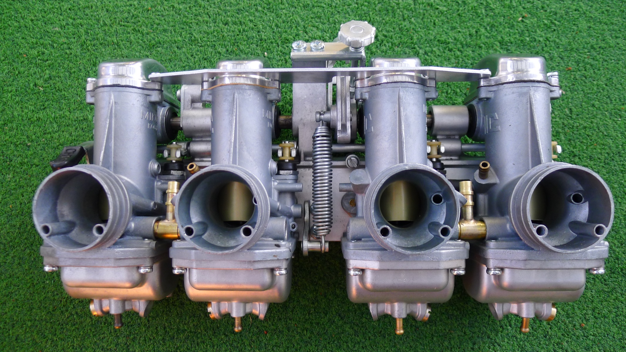

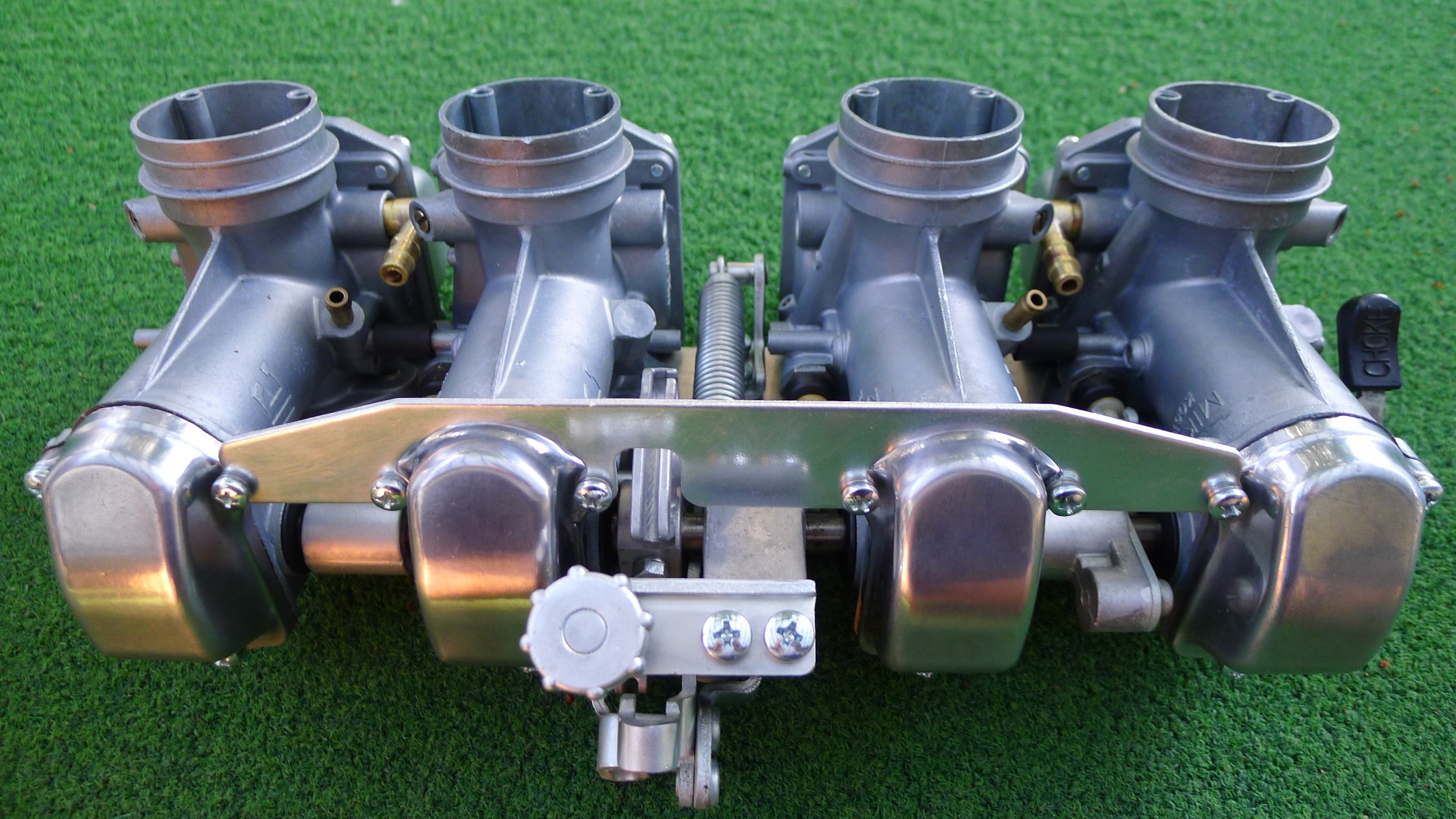

I've got two sets VM26's for refurbishment and would like to identify the year. I'm assuming they are 1979 but would appreciate either confirmation or correction.
These have a pilot air screw but no pilot fuel screw. 26mm, not 28. No accelerator pump.
Thanks in advance.

Re: VM26 Year Identification
04 Sep 2019 16:55
1976 KZ900 & 1/2 year early 1977.
1978 had the standard KZ1000 26mm, they had the air screws under neath the bodies. And Factory had a small white plastic limiter cap on it to limit playing with them.
Z1R's had the accelerator pump and where 28mm. (good carbs)
79-80 MarkII Had 28mm acc. pumpers. Ltd's had the 26mm, pumpers. 26mm acc. pumpers where crap carbs.
That is some nice work on the 26mm in picture. Stock for 76 KZ900. Easiest stock carb to tune for stock engine bikes.
Just what I remember.

Thanks for the update z1kzonly. I forgot to check the 900 model bikes.
I figured these would be easier to tune with only the one adjustment. The jetting on this particular set is 17.5 pilots and 115 mains so I assume they were set up for pods and a header. I've got an identical set in work but they need some parts so they will come later.
Thanks again.

04 Sep 2019 19:58
Oh by the way NICE job!! I know the time it takes to make these carbs look that good. It's always a battle, on my end, replicating original without being too flashy. I have spend a lot of time/actually years/ to duplicate the original "look" on carbs. I see persons that Way-over do the "flashy", and it looks phony. So kudos to You. Need anything Let Me Know, Clay

I have the 1977 VM and has the mixture screw in front of the bowl, as far as I know is the mixture screw is in the front that control gas mix, if the screw is in the back on the side of the bodies are air mixture.
Correct me if I am wrong but your post says air mixture in the front of the bowl

I've seen mixed verbiage between the service manual and parts fishe before so what to call the mixture adjustment screws can be confusing at times.
The pointy pilot screw that pokes up from the bottom of the carbs is the pilot fuel screw and it controls how much fuel air mixture enters the carb body at low speed and just off idle. These are typically set at 3/4 of a turn open. Open further and the mixture becomes richer.
The blunt tip pilot screws that are located on the side of the carb body are pilot air screws. They control how much air mixes with the fuel coming through the pilot jet. These are typically set at 1.5 turns open, and the further open they are the more lean the mixture becomes.
