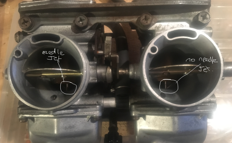

I have a 1981 KZ440 C1(?) that has been in the garage for a few years. Been working on it off and on over that time, but after an extended hiatus, I am now spending more time on it.
When I got it, it was completely in parts and the parts were unlabeled, but hey, we all like a challenge right?
So at this point in time, I have a problem with the carburetors.
Just over a year ago, I sent them off to a local Kawasaki repair shop to have them cleaned up / inspected. They needed new diaphragms, but it seems no cleaning was done. The shop, strangely, wouldn't fit aftermarket diaphragms because of the risk of tearing them during installation, so I took the risk and I replaced them myself. No rips and compressed air into the carb's shows the diaphragms lifting the sliders as expected.
The carbs were in one piece when I got the bike, so had presumed that all the internal components were there.
After finally rectifying some electrical issues, I turned the bike over but ended up taking the carbs off again because fuel was just squirting out the overflow's. A quick tear down of the bowls and an inspection showed me that the float needles were gunked up, so a good clean and polish later, carbs back on the bike and no more gas coming out the overflow. Cool! However, also no fuel to the engine. But this, I think, was a pre-existing condition.
So, carbs back off again, and it was while I was stripping them down that I noticed one of the needle jets was missing from one of the carbs.
These just don't fall out right? Ref part: www.partzilla.com/product/kawasaki/16017-1059
I'm assuming it is an important part as I think they are there to ensure that the correct amount of fuel is released into the body when the throttle is twisted?
Anyhoo, my other question is (while waiting for a new needle jet to arrive), is:
Would this missing component prevent fuel from getting through the carbs to the engine? In my mind, and not necessarily logically speaking
, I would again assume that with no needle jet, the fuel flow would be unrestricted.

I think the answer to your question is no. When starting the engine there isn't enough air pressure differential (between the carb throat and the bowl) to draw fuel up the main jet. The throttle needs to be opened up to about one quarter before the jet needle/needle jet becomes the main fuel control.
Your starting problem is likely due to a blockage in the choke circuit or in the pilot circuit.
