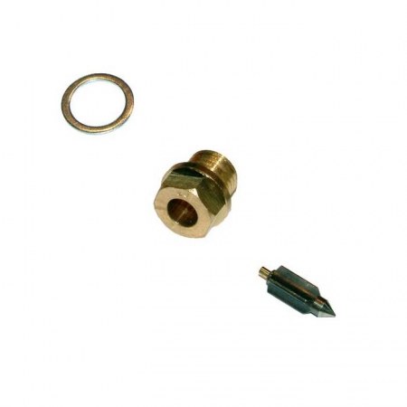

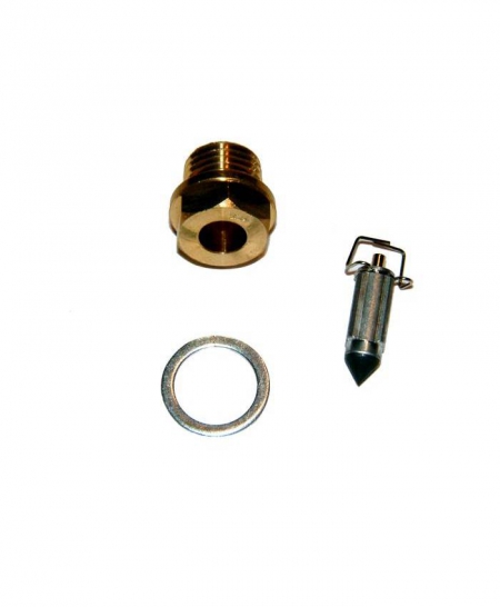

Looks like your float neele valve did not seated right, it´s time for some new
Mikuni
www.motorradbay.de/z650-kyv-03r25_5-floa...d9c3981d8279995eaf91
Keihin with a rubber cone
Mikuni
