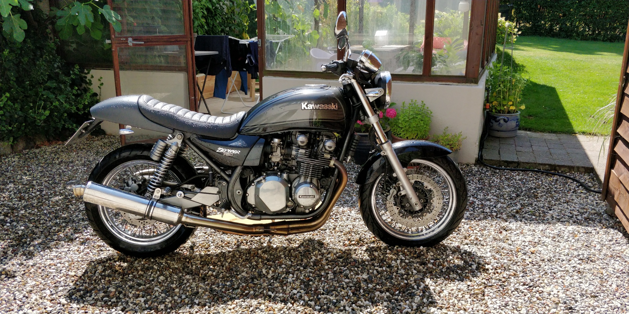

Welcome to the forum. I have always liked the Zephyrs, and I especially like the custom touches you have added.

Glad to see you here, and glad to see your Zephyr with kit installed!

Thanks Gazzz
Yes it looks nice
great job you have done there
