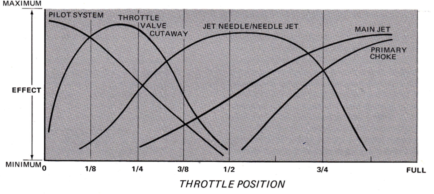

I’ve got some other bikes with some OTHER carbs. :)
Sudco sent me a throttle to jet map visual. It was really helpful diagnosing the jetting.
Curious if anyone has a chart that has this for the Mikuni carbs. I’ve got a few kz650s with the VM24s

This is a generic one from a Kawasaki carburetor training manual.

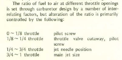

Also - from the 1977 KZ650 Kawasaki Service Manual for VM24 carbs. Notice how it matches the above chart. Ed

Exactly what I’m looking for. Thanks all
