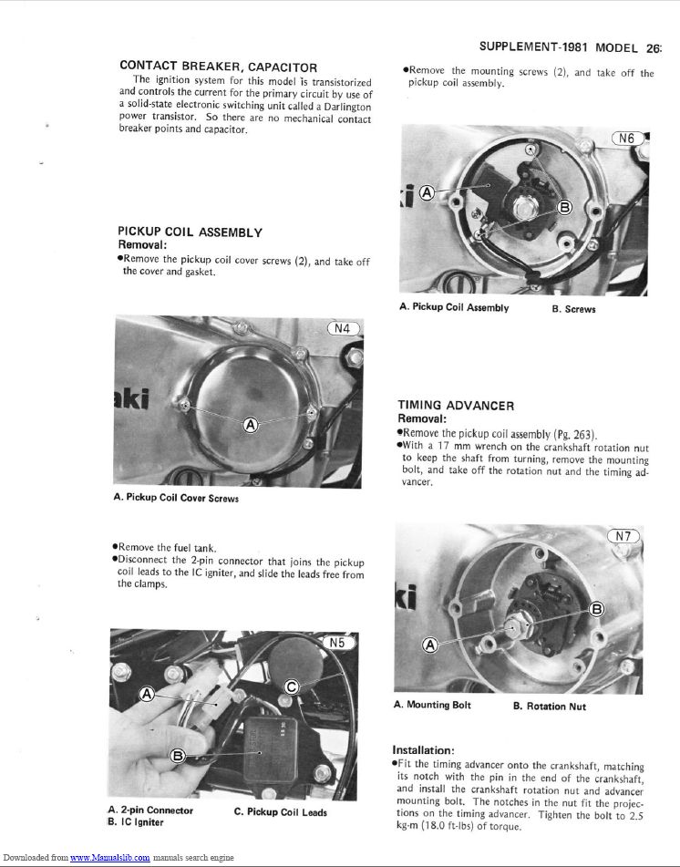

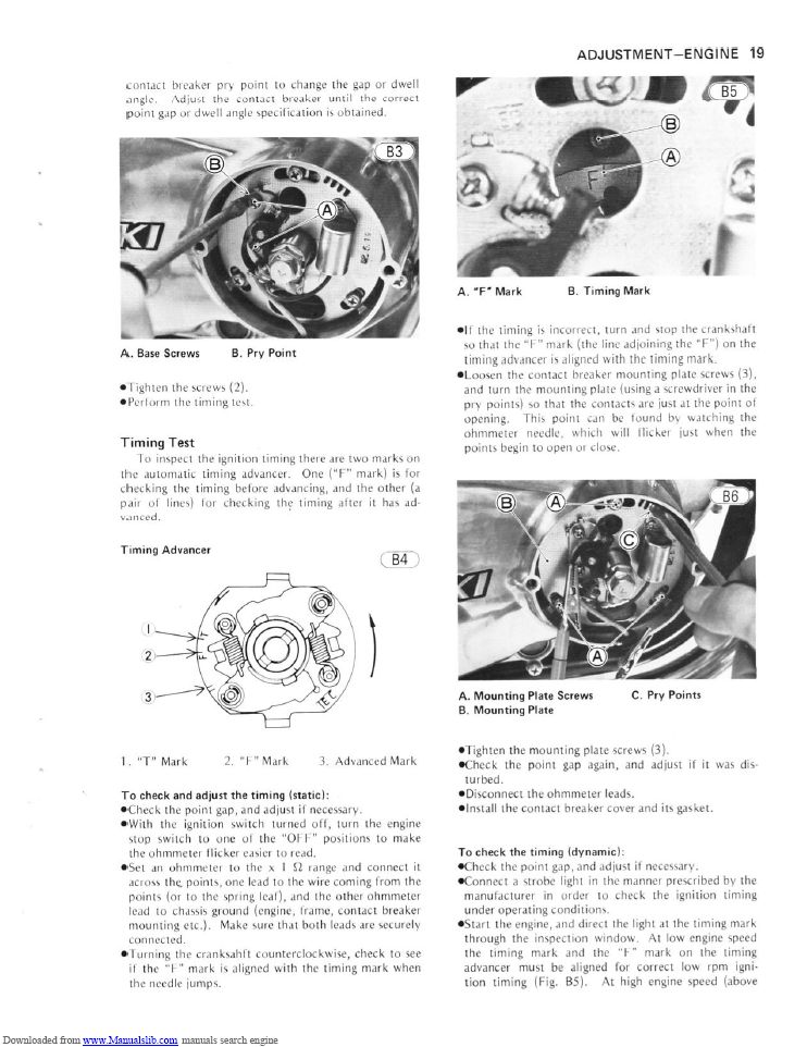

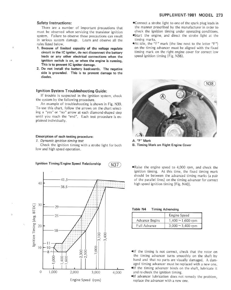

I think it is a timing issue but can't find that "f" mark. If anyone could point me where to look I'd appreciate it

- Posts: 4420
- Thanks: 2269
Re: 81 kz440 won't start
10 Aug 2019 14:44 - 10 Aug 2019 14:50
Last edit: 10 Aug 2019 14:50 by Scirocco.

12 Aug 2019 11:00Cbguy wrote: I haven't had much of any time to work on the bike as of late.
It's on the timing advance unit behind the small circular cover on the main right-side (clutch) cover. The timing advance is the small disk that spins, in the very back of the timing compartment. If yours is an '81 it *should* have electronic pickup ignition, not points (unless someone changed that...).
With electronic ignition it's very easy to see the timing advancer because the pickup unit is much smaller than the points plate. The rotating part in back is the advance, and the stationary part in front is the pickup. Check around the perimeter of the timing advance for the marks; there should be one double tick mark, one F mark, and one T mark (in order going clockwise around the advance). If you don't see any marks, remove the spark plugs to remove compression from the engine, then using the inner 17mm nut turn the engine *counter*clockwise until you can see them.
With a timing light and the engine at idle (below 1400 RPM), the F mark should perfectly line up with the reference mark on the case (right below the top screw on the pickup).
