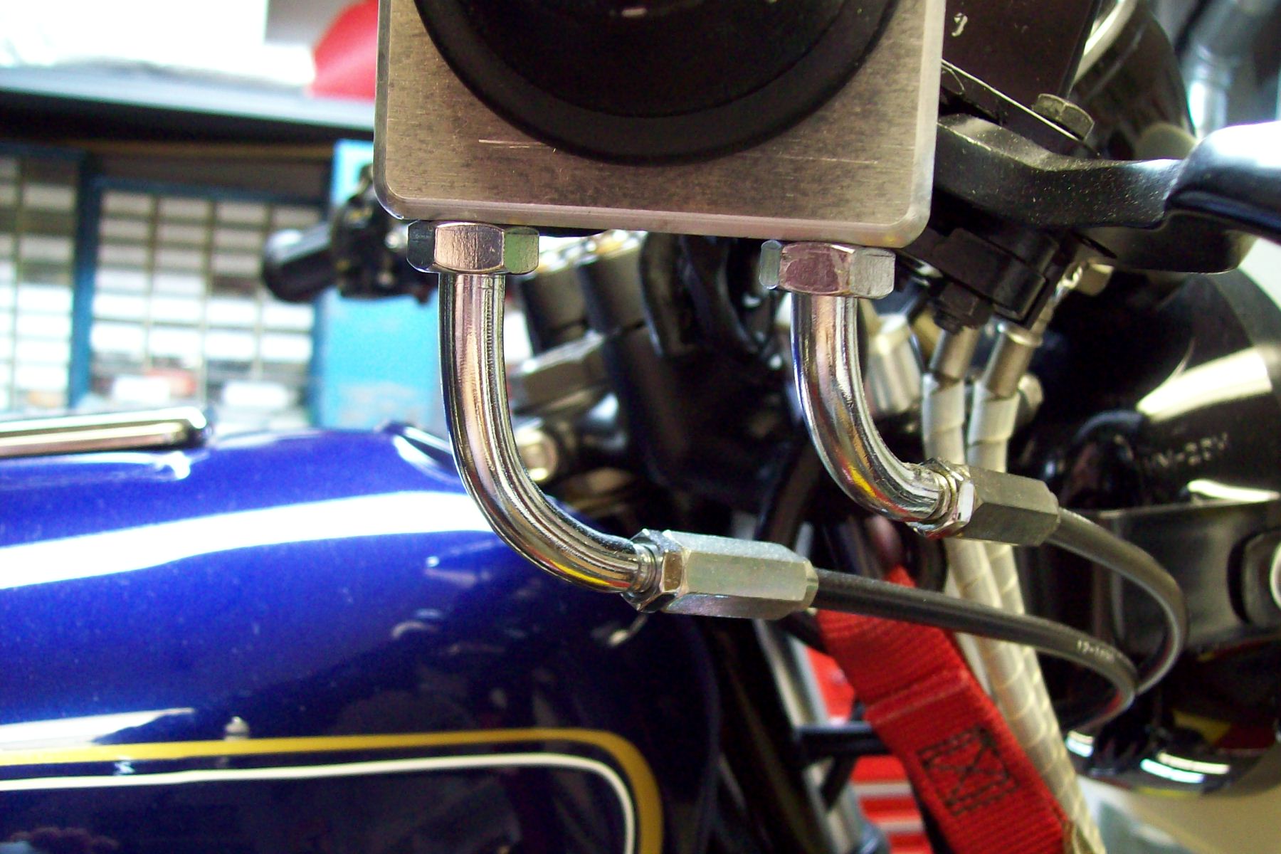

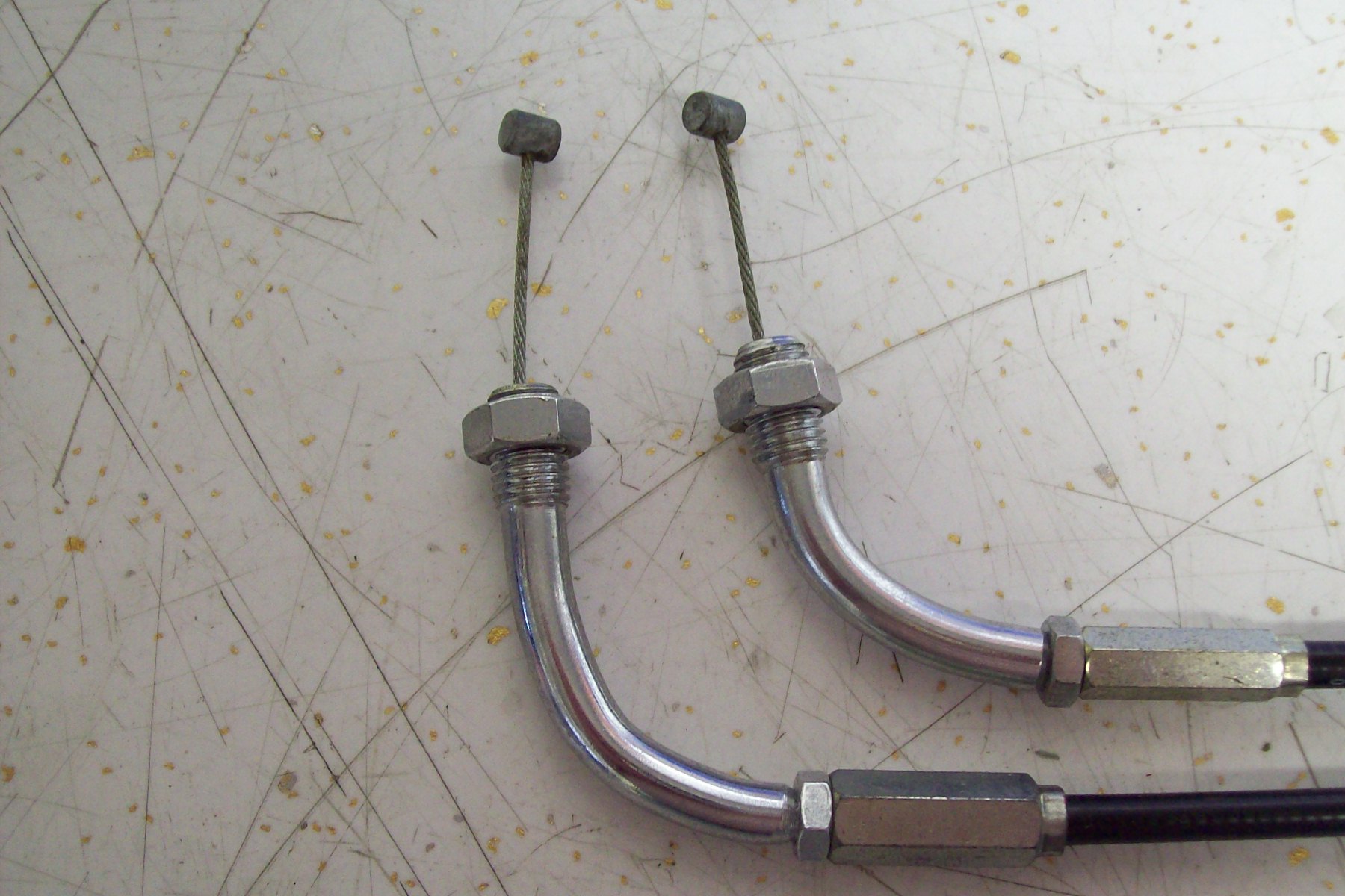

On Kawasaki bikes with an opening and closing cables. The higher part number is the closing cable. 54012 just means its a throttle cable. -149 is opening cable. -150 is the closing cable. The main difference is the radius of the curve of the metal piece that threads into your right hand switch body. If you have two cables with the same radius metal piece you cannot thread the second cable into the switch body without running into your opening cable.. That is why the closing cable has a wider radius curve so you can thread it into the switch body without running into the metal piece on your opening cable.
I think the photos below will explain what I am trying to explain!!
Bad news for you, I just ran a parts check on your two cables. Both show as NLA from Kawasaki Motors!!!!!
All you can get is cheapo aftermarket Motion Pro cables now!!!
