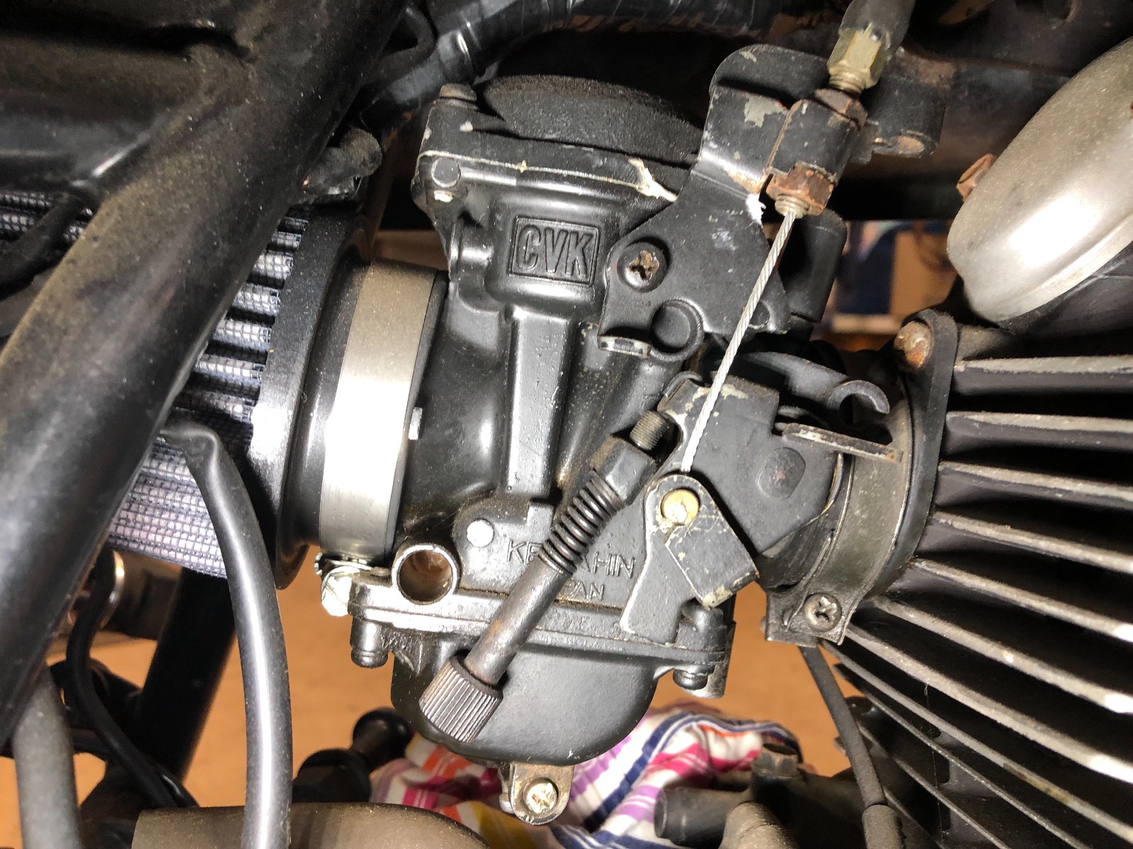

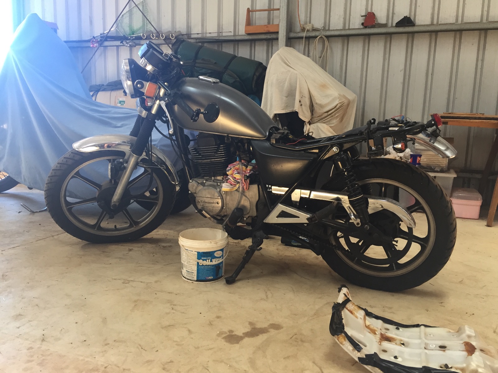

Any pics of the bike and your carbs would be helpful.

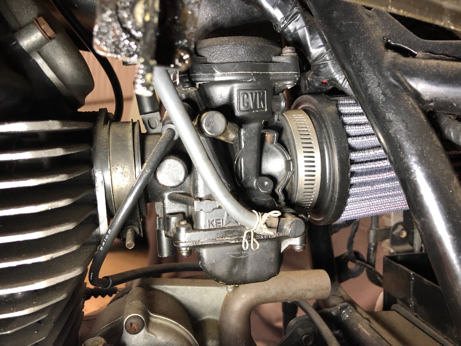

20 Jun 2019 03:43 - 20 Jun 2019 04:03Attachments:

- Posts: 8028
- Thanks: 2566
Re: KZ 250 Carburetor
20 Jun 2019 04:54
The CVK is a much later series carb than what came on the bike. It is a good piece, but jetting and such are going to be unique to this situation. The pilot circuit on them is very susceptible to the tiniest little specs of dirt, and the only way to insure that all those tiny passages are perfectly clean is to completely disassemble tha carb, soak all the metal parts, including the body, blow out the passages with compressed air and finally follow up by pushing a tiny wire through each passage and blow again. I highly recommend using a top notch fuel filter Like the Golan Micro-mini. Most cheaper filters only catch down to 40 microns, while the Golan goes down to 10.

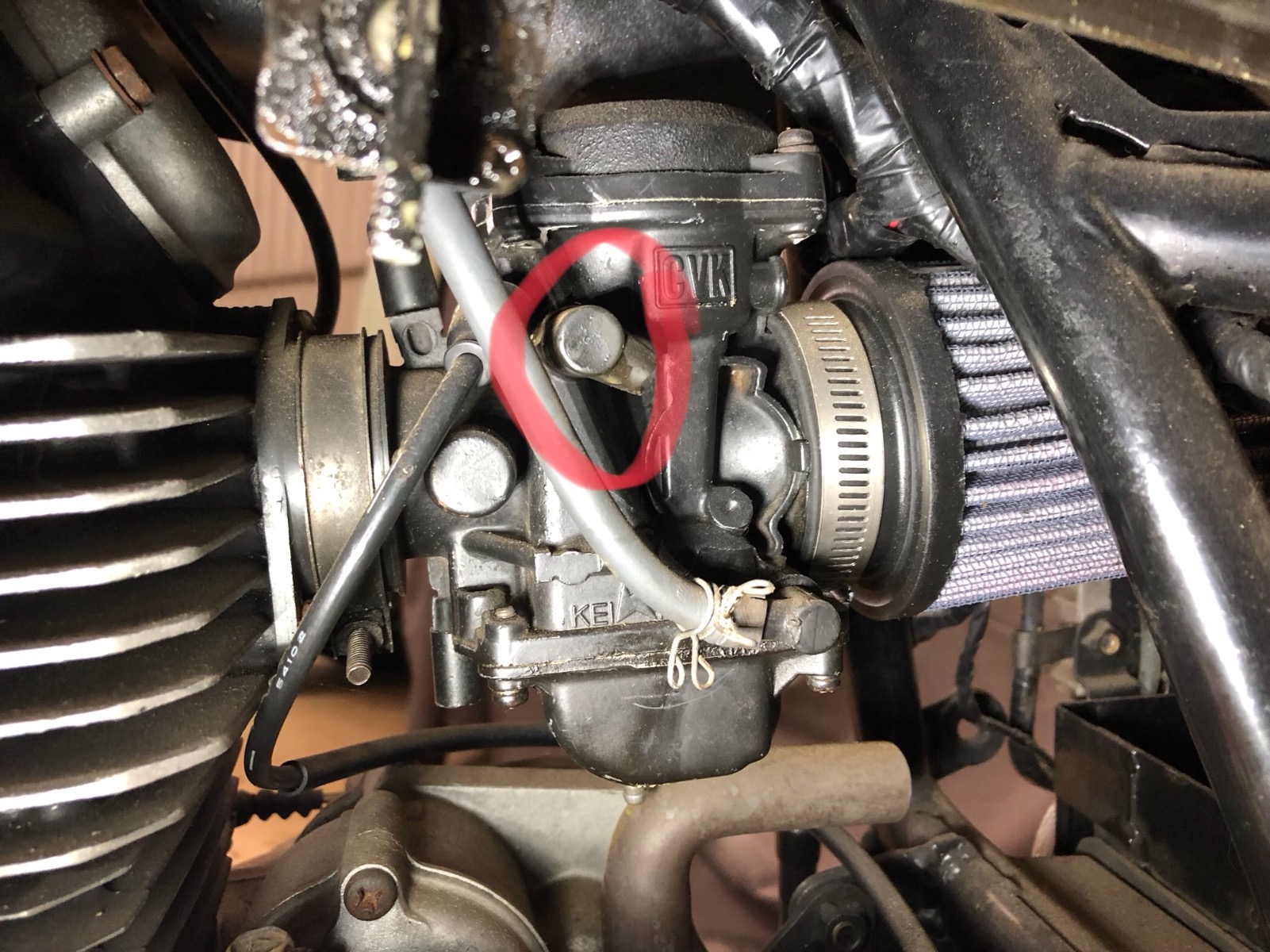

Can you tell me what this piece circled is for? Appears to be broken but unsure if it goes anywhere or if it is even blanked off. I’m currently away for two weeks so I can’t have a look.

That looks like a cap over the bowl vent. If that is the case, you will need to fix that . The bowl vent is crucial to proper operation.

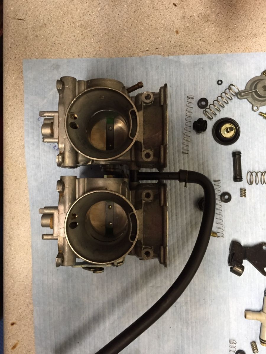

There once was a plastic t-fitting there that connected to the carb that is no longer beside this one, and had a hose that ran over the air filter box. I will load a pic shortly.

20 Jun 2019 17:05

If I wanted to keep the pod filter what would I need to do to fix this, seperate filter or run it into the pod somehow?

You will just need to find a way to hook up a vent hose. The hose vents to atmosphere, not into the air box.
The plastic tube that goes in the hole has an oring seal on it. If you are handy with tools, you could probably take a short bit of plastic tube and cut a small groove for an oring. The open end of the hose needs to be in still air, away from turbulence. On my ZRX, I have the ends situated behind the side covers. Turbulence will mess with the pressure in the float bowl and make for wonky running.
