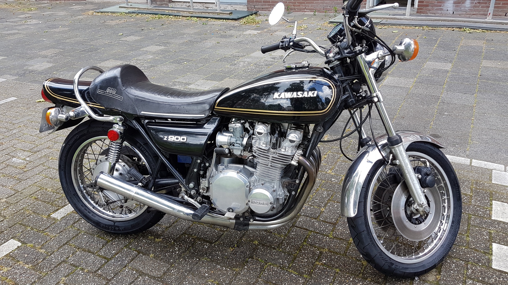

Hi all,
If I don't have any power below 55 00rpm would that mean my carbs weren't rejetted for the velocity stacks and 4-into 1?
I'd be happy with that because I'd like to get it back to stock. ( except for the rare as rocking horse ?*&^#, i've been told)
She start and runs well except for the lack of power. No smoke carbs cleaned etc.

If the pilot jets are still stock I'd expect it to be well lean at low revs. Try cleaning the plugs then take it for a ride only using the low rev range then check your plug colour. Chances are they will be whiter than Doc Emetts hair.

- Posts: 3091
- Thanks: 1187
Re: carb jetting
18 Jun 2019 17:19
Those are Z1 or early Z1A carbs on what looks to be a KZ900 engine. Your pipes are badly blued, suggesting your pilot fuel/air mixture is very lean. What pilot jets are you using and what position are your needles? Also, how far are your fuel air screws backed off?

Th. I've enlarged the mains from 120 to 150 and it still won't pull strongly. But it runs better than before. and idles great.
It start first try, electrically or with the kickstart
Would going to 180 or so be normal for just velocity stacks?
