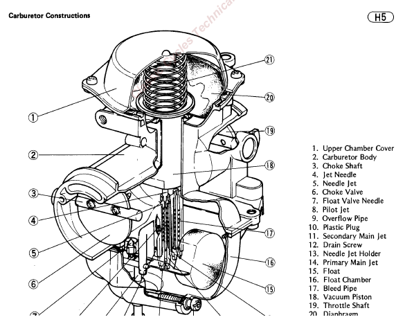

My PDF manual is cutoff so that I can't see the entire carburetor diagram. Does anyone have a better image that they could share with me?

Is this carb (CV 34 I think) supposed to have an overflow pipe?
