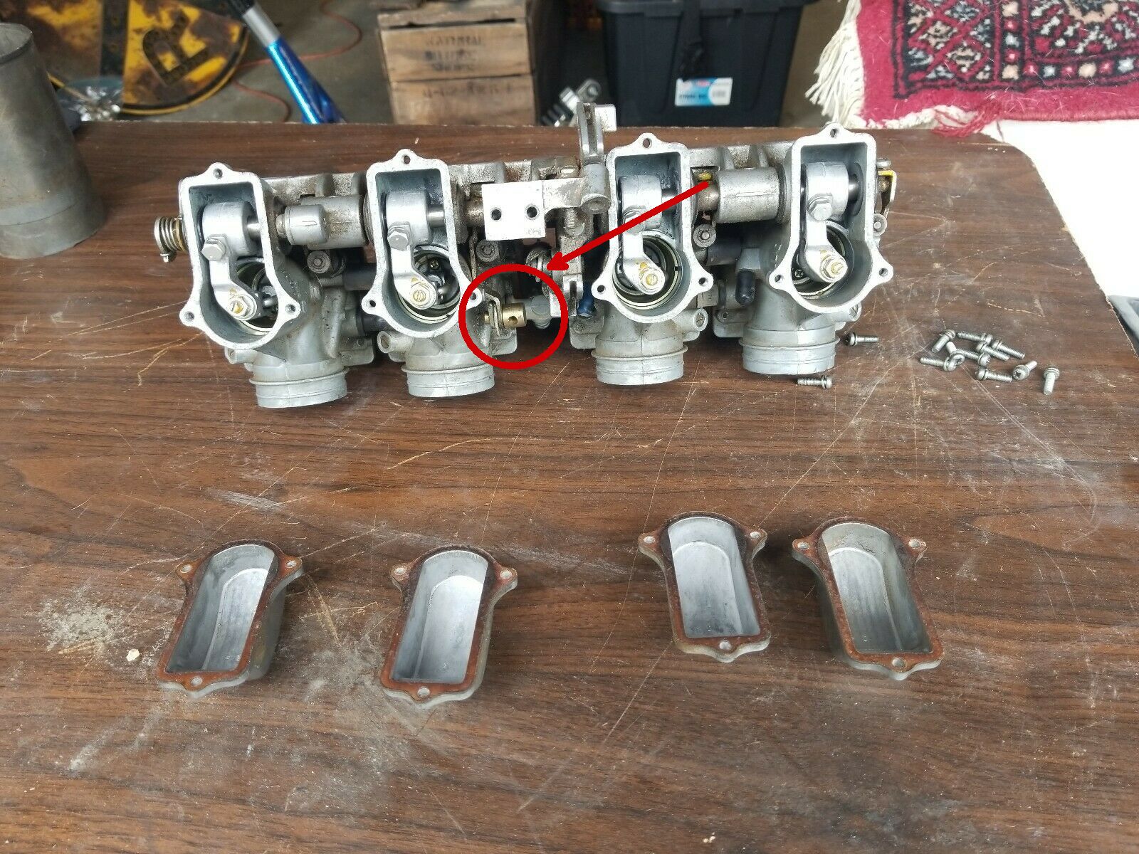

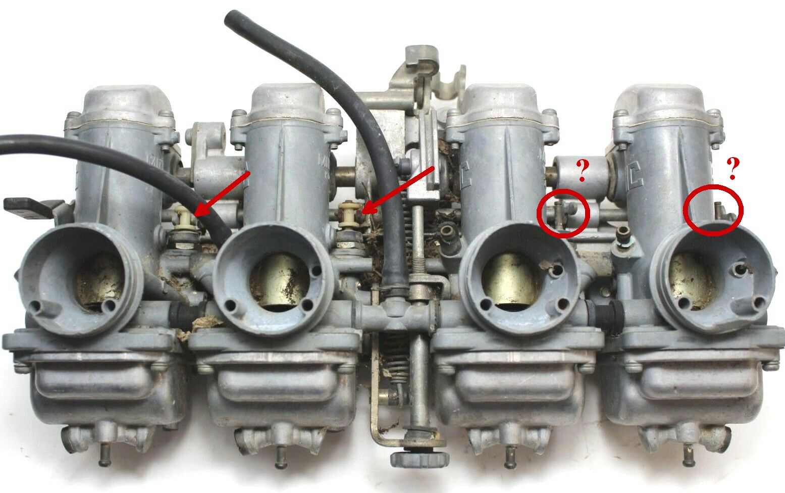

Re: KZ750 What Carburetor should I Go With?
07 Jun 2019 15:04
I wouldn´t bet on this carbs. Two of four enricher plunger pullys a missing.
How knows what else is missing under carb bowls??? I would say money pit.
08 Jun 2019 13:10 - 08 Jun 2019 13:12
Last edit: 08 Jun 2019 13:12 by Scirocco.
