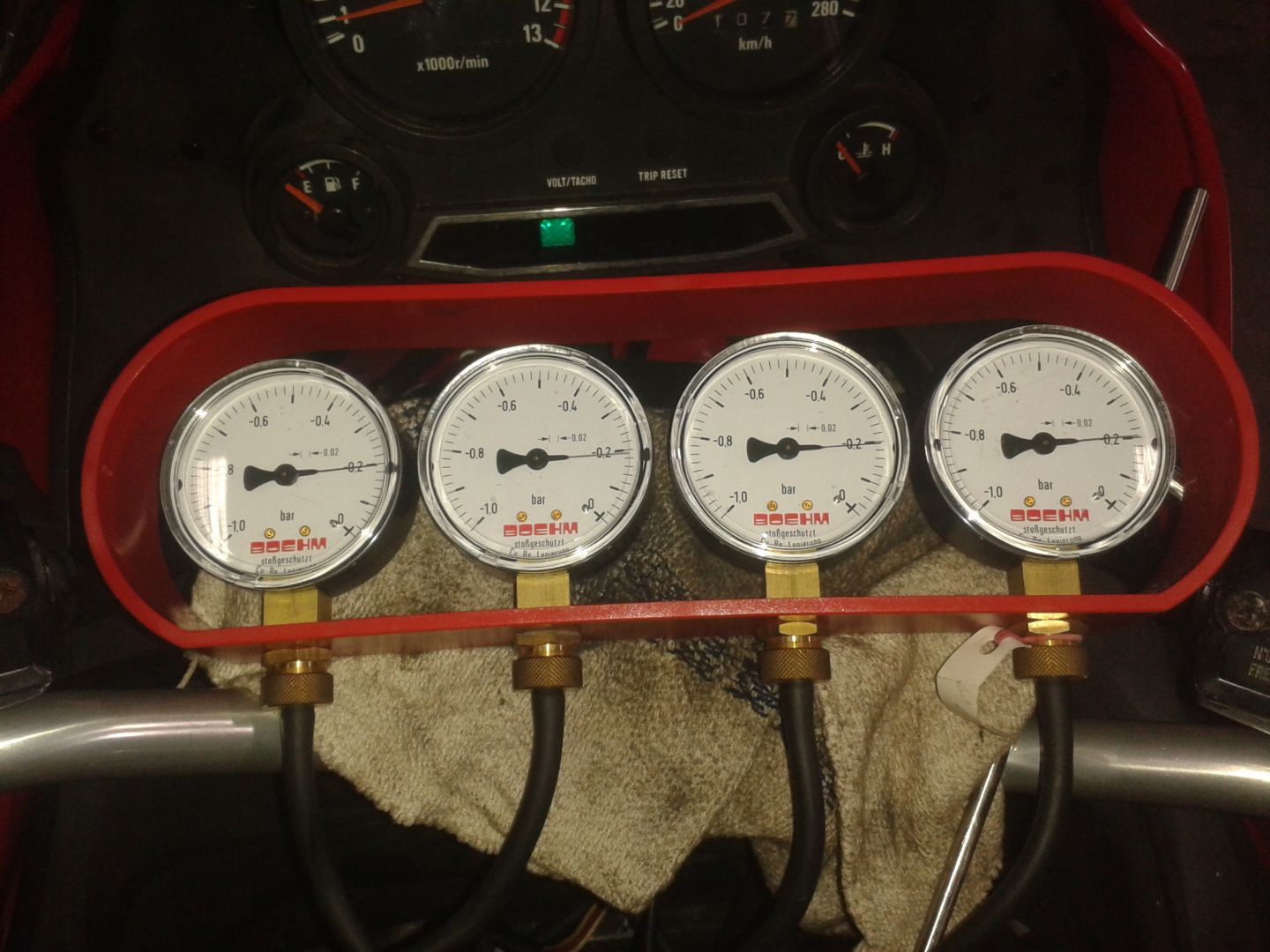

I have it running but now as I’m trying to sync the carbs I have an issue where I can balance the carbs at 1000rpm but the gauges read 12 in. Manual says should be 7.5-9.5 in. Is there a way to lower/raise the overall in? Does this higher reading indicate anything important?

No, it´s more important that all gauges readings should be equal for good carb sync.
And you have to check the gauges calibration first.
I don't think 12in. is correct. The factory manual says 19 to 24 cm (with airbox). That's 7.5in. to 9.5in.
The vacuum with airbox is not much different with pods.
With pods on a Gpz550 and Tk22 carbs, I think I normally see from 160mm to 250mm Hg at idle or with a slightly fast idle. That is 6 inch to 10 inch, very roughly. Probably closer to 220mm (8.7 inch) most of the time.

Thanks for the help. I got the carbs to sync at 12. I do use the choke to get it started but after a minute I shut the choke off. It seems to run fine. I made/installed new choke flaps as others had suggested.
