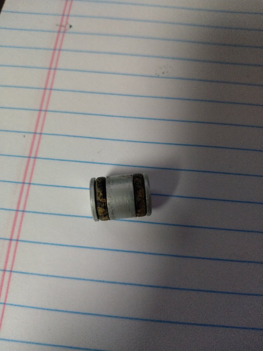

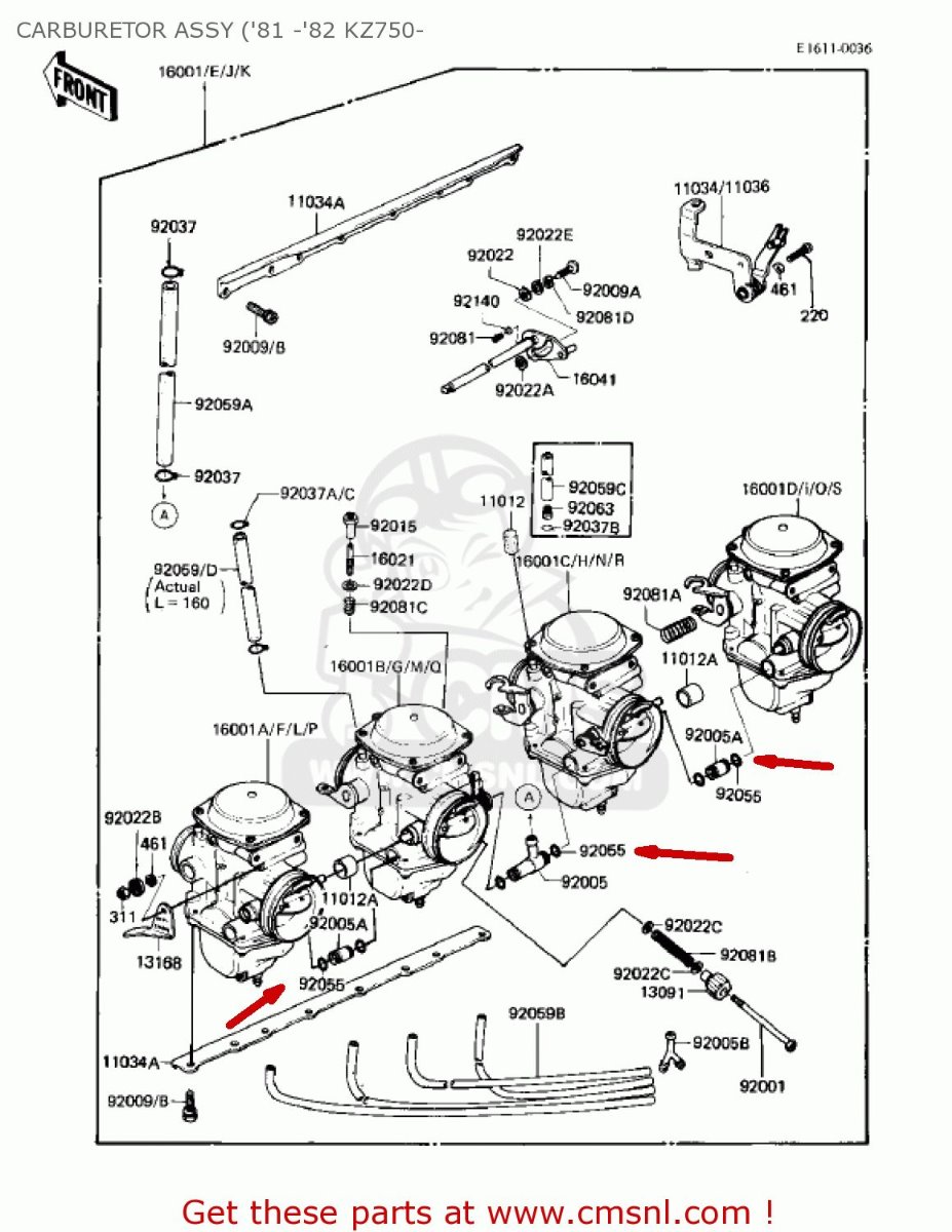

So, the bike started puking fuel all over the floor a couple of days ago. I thought it was a bowl o-ring, turns out it was not. Seems it is the little O-rings on the connectors that provide the fuel between the carbs. Any idea where to get these? The carb part listings I have found don't have any pictures.

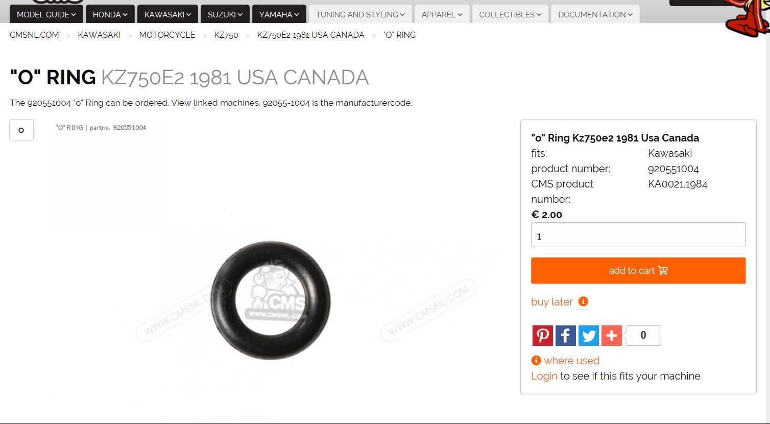

www.cmsnl.com/kawasaki-kz750e2-1981-usa-...551004/#.XO8yM7kUk_w
www.cmsnl.com/kawasaki-kz750e2-1981-usa-...44.html#.XO8zTLkUk_w

That is for an e2, not h2. Are they same?

If you look up the part on Partzilla, information on what bikes the part fits comes up.
To answer your question though, yes, the E and H bike carbs are the same, so the O-rings will interchange.
And if you have an O-ring store in the area these are the various sized to rebuild the entire set of CV34 carbs...
Pilot Screw: 1.2 x 2.6
Pilot Plug: 1.5 x 2.8
Fuel Transfer Tubes: 2.0 x 5.5
Drain Screws: 1.4 x 4.0
Float Bowl: 2.0 x 67
BTW, industrial standard measurement method for O-rings is T (thickness) x ID (inside diameter), in this case measured in mm.
