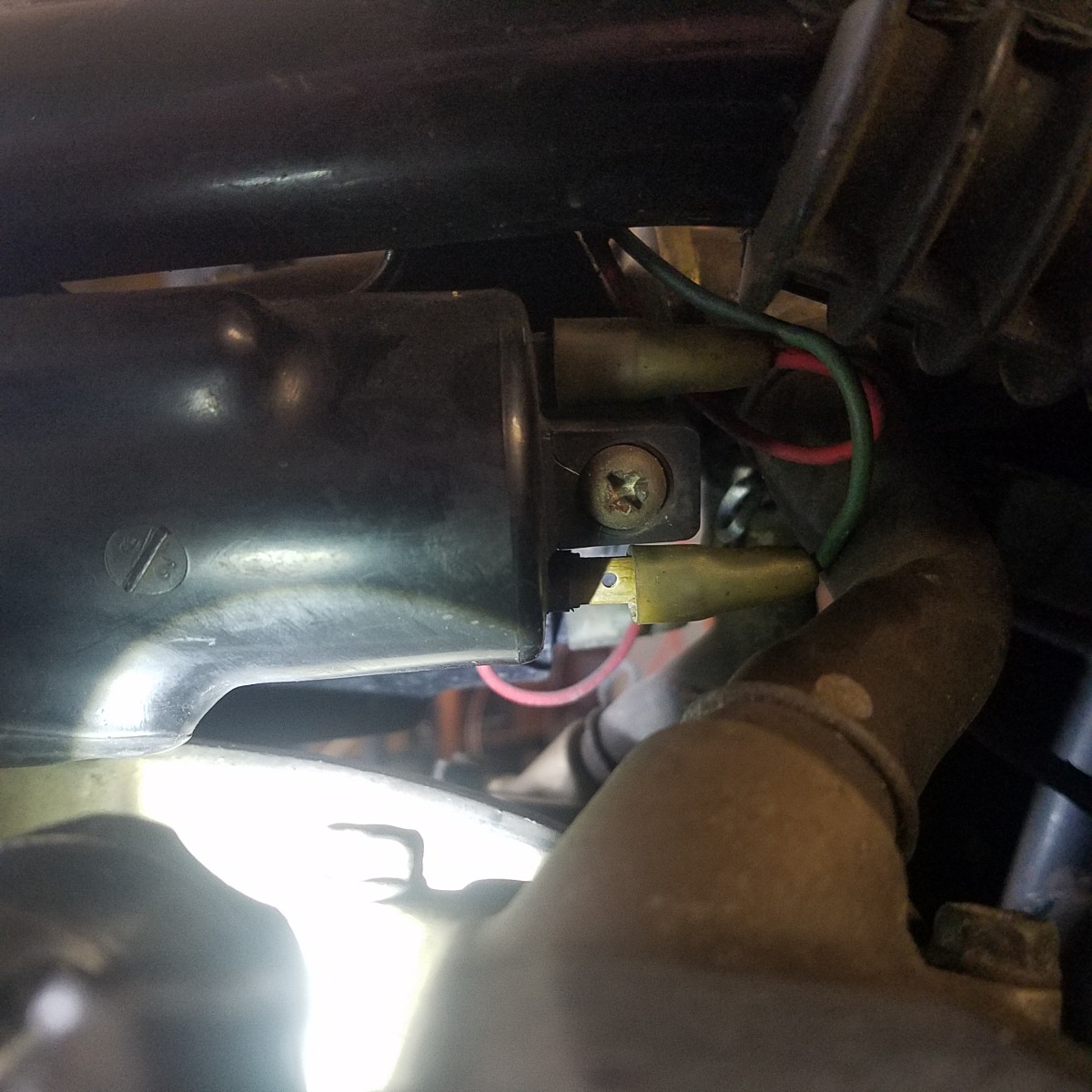

- tthunderdan
- Posts: 119
- Thanks: 15
Re: 1983 Spectre 1100
26 May 2019 09:38
So I figured I would look for another issue on the cutting out . I was going to check the coils this morning and this is what I found...a loose connection on one of the coils...it was just hanging there, getting contact most of the time...I will take her out n see how she behaves in a bit...
