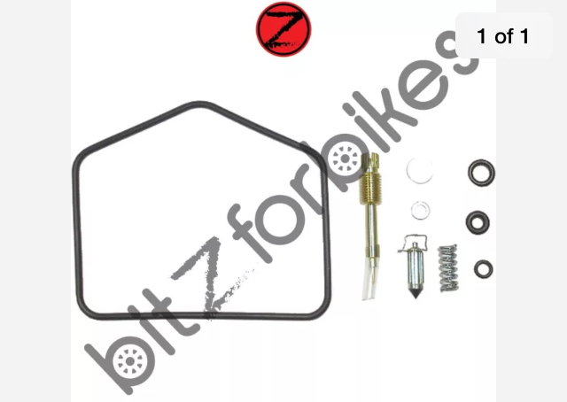

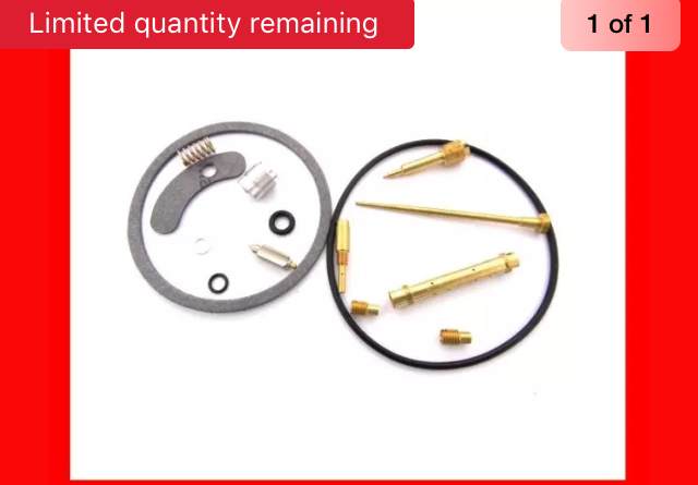

New to the forum - I’m trying to buy a carb service kits for my 400 LTD - rubber seals / jets etc but on eBay they seem to list two different types where the float bowel seals are round or kind of square like - I can obviously see what shape my carbs are but wasn’t sure if they’re different internally - also are kits for 79 models suitable for 83 models - I included photos of the two types available - Any help is appreciated

Carb Kits = imitation junk parts
You would be better off sourcing the soft parts like O-rings and reuse all the brass jets. If necessary, you can get float needles with the rubber tip.
The large O-ring for the float bowl can be either formed or round. If round use a few dots of super glue in the bowl groove and then place the O-ring inside with some tape until it drys.
I've rebuild scads of Keihin carbs like the 1983 440 uses. I've got records of the O-ring sizes, and should even have spare O-rings too.

For whatever it is worth, the ebay carb kits I bought came straight from japan. No issues with any of the gaskets, orings air needle or rubber tipped carb needle.
