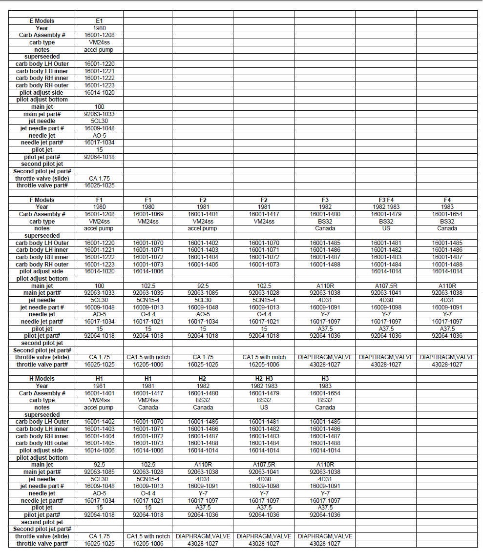

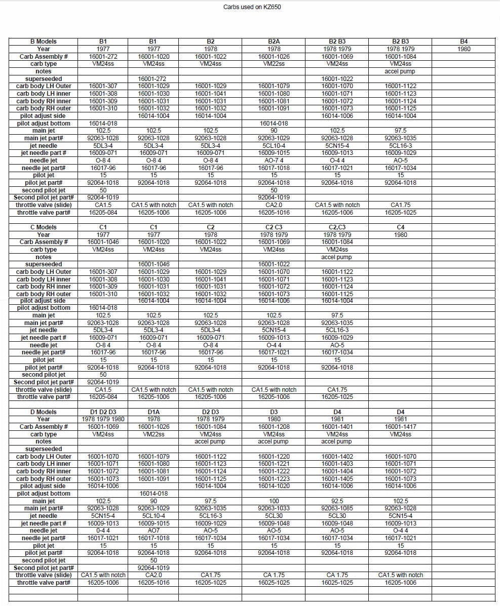

Also whats a proper main jet size for stock exhaust and airbox? The PO had 107.5s in there (it had pods), so while I was in there, I put 102s in. Will those be okay?

I didn't mean stock by proper, I know the stock jetting is lean, which I would rather avoid. I just want a reasonable size that won't foul plugs like crazy.

21 Apr 2019 16:52Cabbagio Redentor wrote: ...............
See below. Ed
The following user(s) said Thank You: Cabbagio Redentor

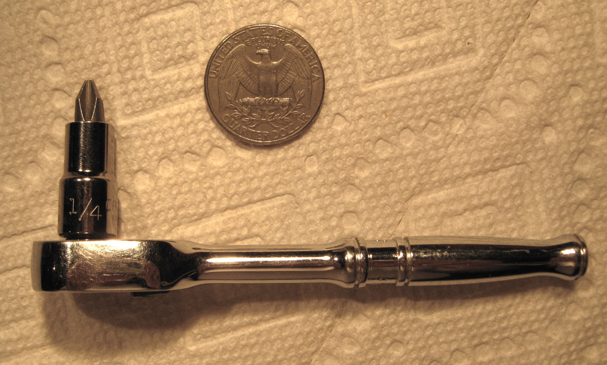

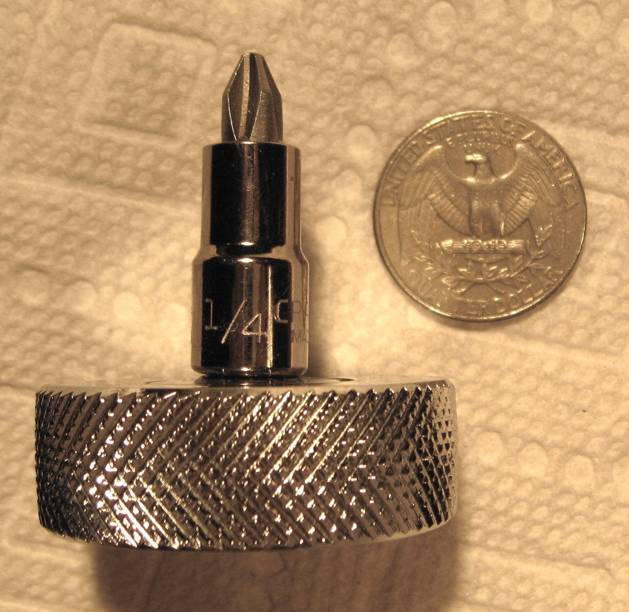

Re: kz650 carb overflow
18 Oct 2019 18:15
Taking the carb bowls off the carbs without removing the carbs from the bike is very easy, even with the JIS screws. Just use the proper tools (either type shown below with JIS bits); it really makes a big difference. Ed
