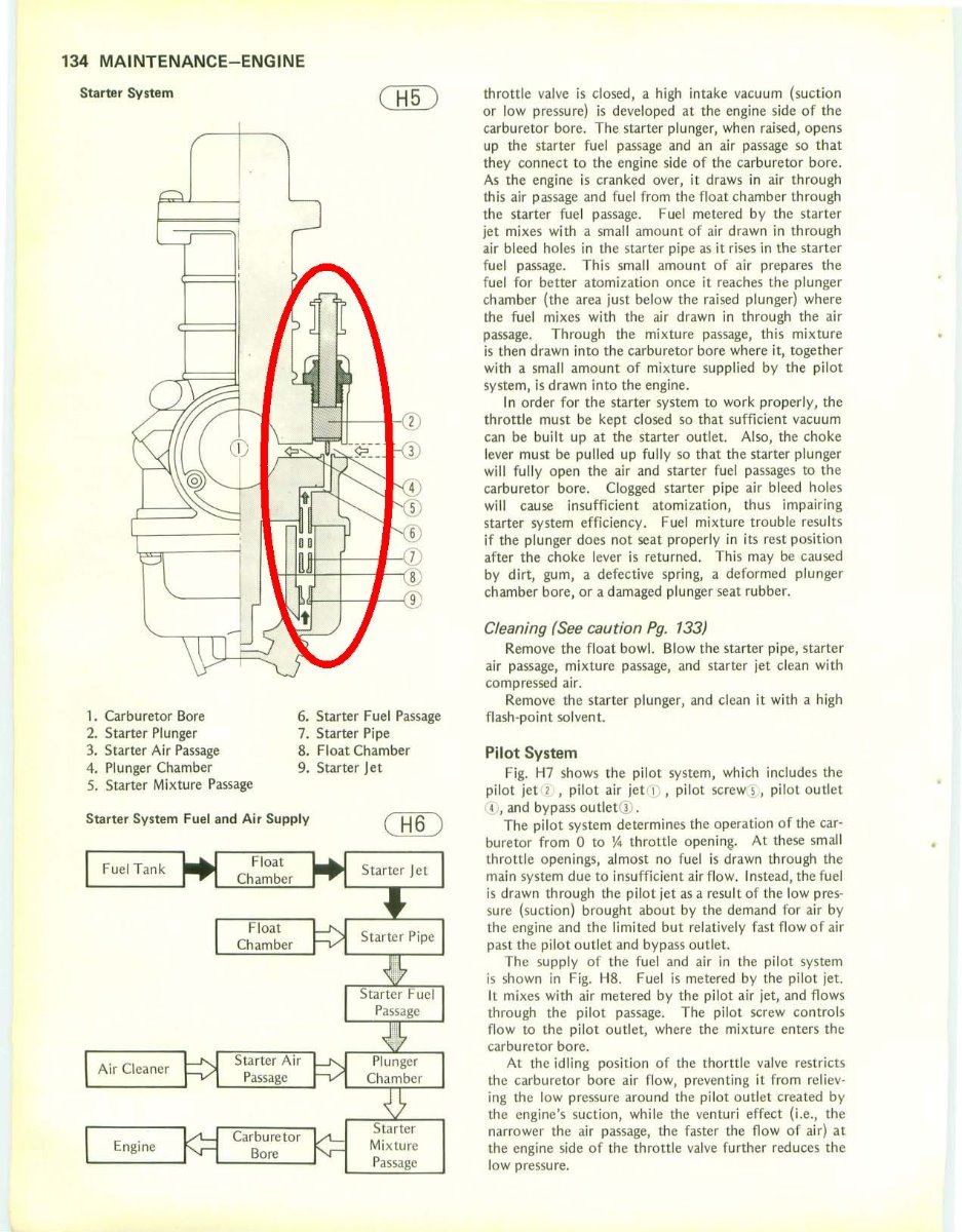

Ist not a choke system at cold start, it´s a extra fat air/fuel enrichment circuit/jetting.
Pull the carb bowls and clean the starter jet and starter pipe.
