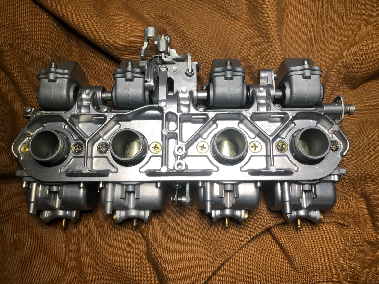

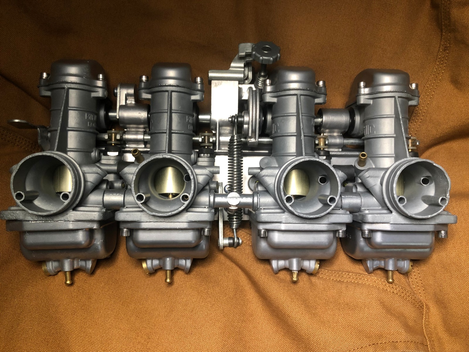

Full tune up has been done including valves and the works. My only problem is the carbs and I have bought a new set. A gentleman on eBay had for sale a set of vapor blasted KZ650 carbs 1977-1978. I bought them.
I noticed the main jets on the carbs i bought are 110 and the pilots are 15. Stock jetting on a KZ650 is main 102.5 and Pilot #15.
My sons say I should change the exhaust, and that it looks "old." I may change to a Kerker 4 into 1, but my sons, who are a bit hipster, tell me I should get pods. Im considering pods, since these beautiful carbs look jetted for pods.
What are your thoughts on this, and what were stock carbs on a KZ650? VM22, 24 or 29?

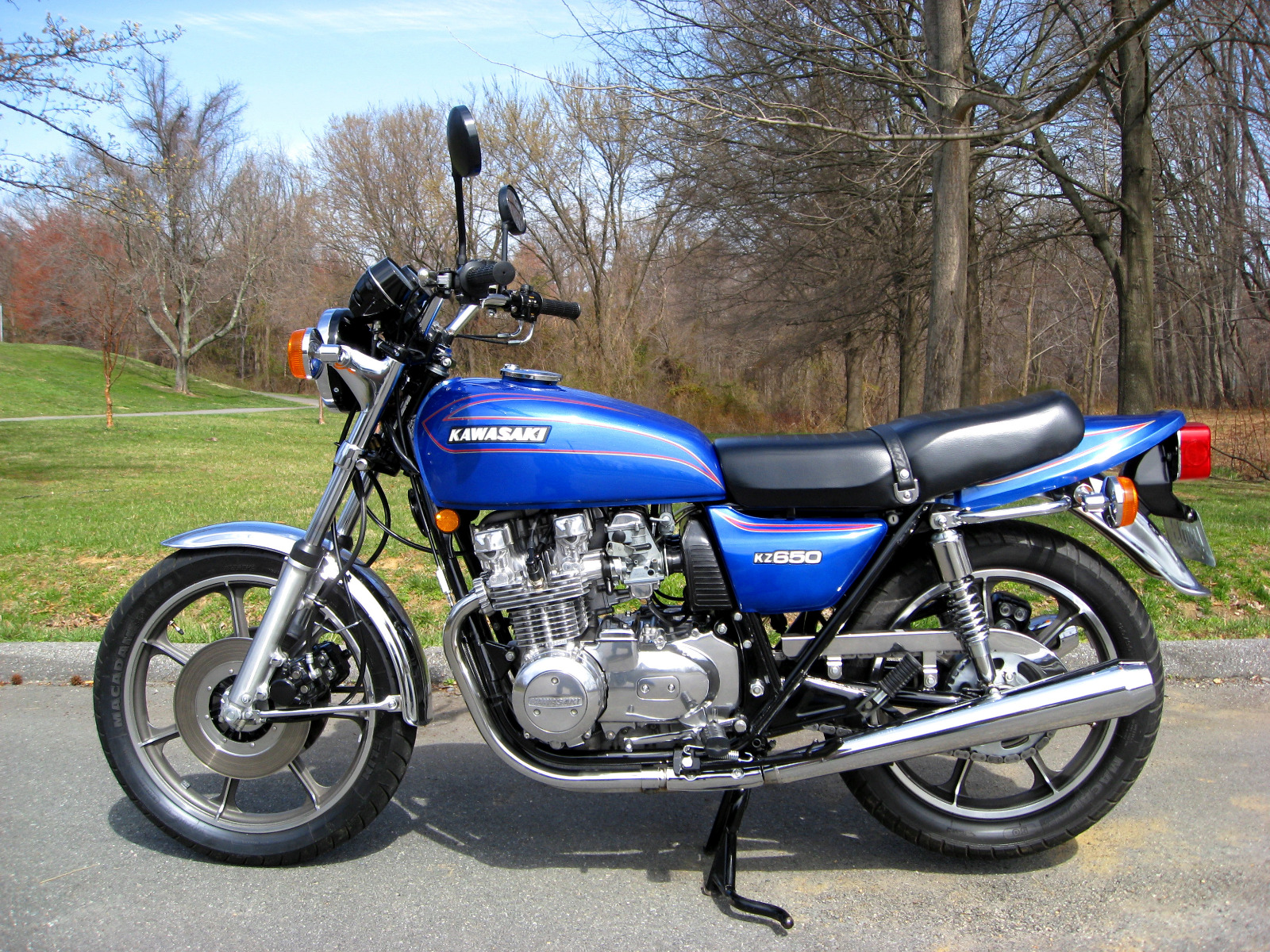

First advice – ignore your sons’ opinions! Your bike looks really great as is! Replacing the pipes would be a big mistake assuming your originals are in decent condition, and putting pods on it would make it look like every other KZ650 that has that mod plus it won’t run as well as it does with the stock airbox and air filter.
Instead – take a couple months and see how many stock 1977 KZ650’s you see on the road. Here’s a hint – the answer will be none! I know because I own the stock 1977 KZ650-C1 shown below and have owned it since it was new. I haven’t seen a stock one on the road in more than 30 years! You bike is an original classic and modding it at this point would be like modding an original 1957 Corvette – bad idea!
The carbs you show are Mikuni VM24SS carbs. They were the original, stock carbs on the 1977 KZ650. You are correct that the stock jetting for the 1977 KZ650 carbs was 102.5 main and #15 pilot. If that was my bike I would return the jetting on the new carbs to stock, install them with the airbox, and ride. Seriously, your sons are wrong in advising you to mod the bike – do yourself a huge favor and keep it stock!

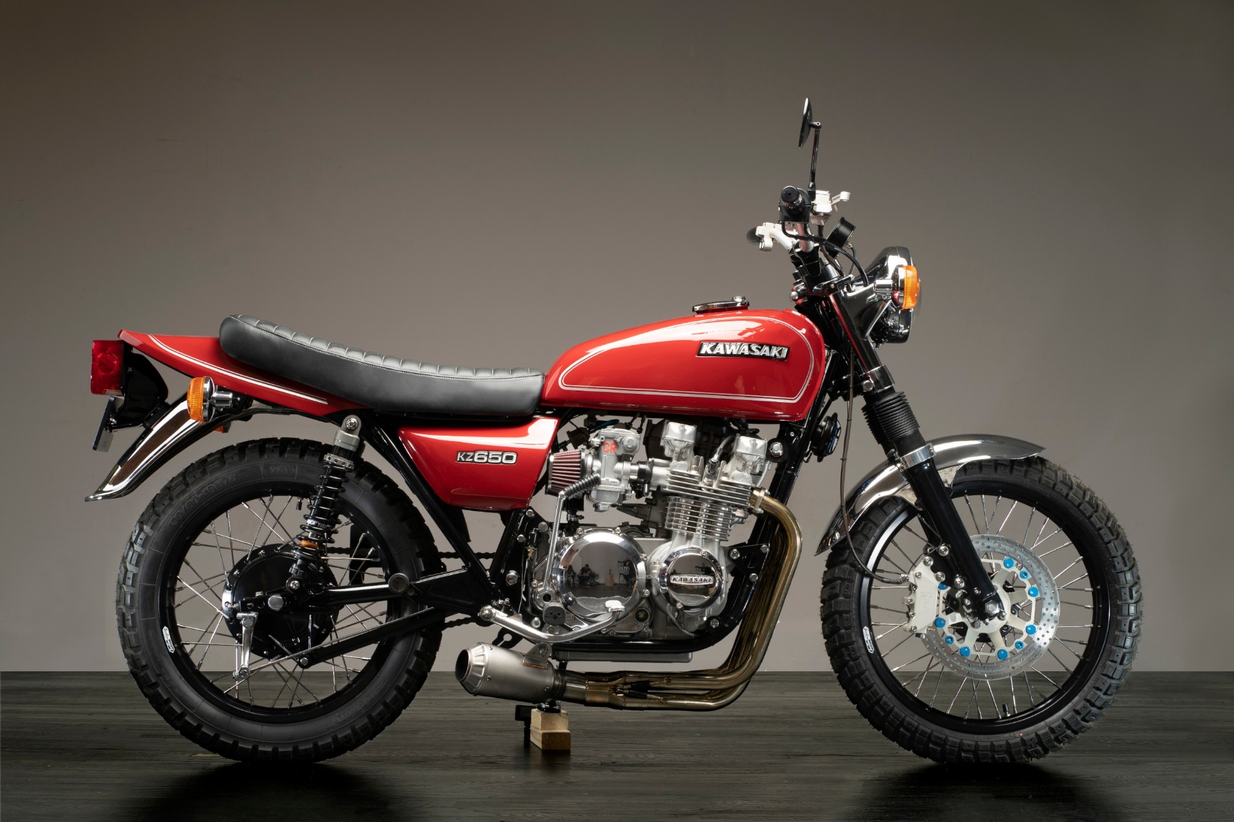

This is my son's kz650 that he had built. Hes a san fran tech gazillionaire and paid an outrageous amount, but it a beaut. As you can see he has CR carbs on it. He was urging me to do the same. I will have to think about this.
Also, what was the needle position in the carb's stock form? I think now its in the 3rd or 4th.

Your son's bike looks good, and I certainly have no bias against modding a non-original bike. However, survivor bikes like yours are extremely rare and in my opinion should be preserved - they are only original once.

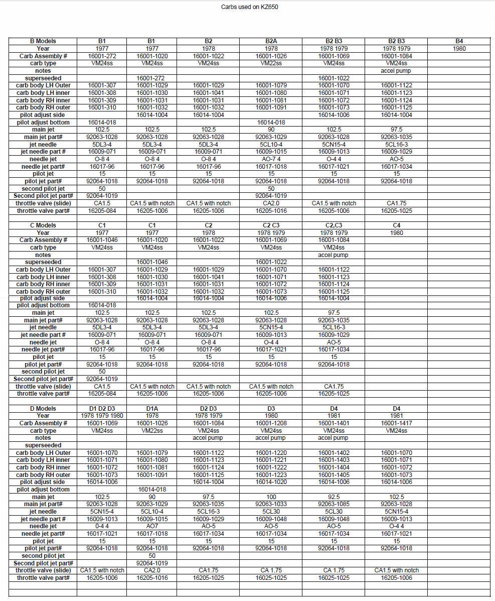

Here's a chart that shows carb info. Ed

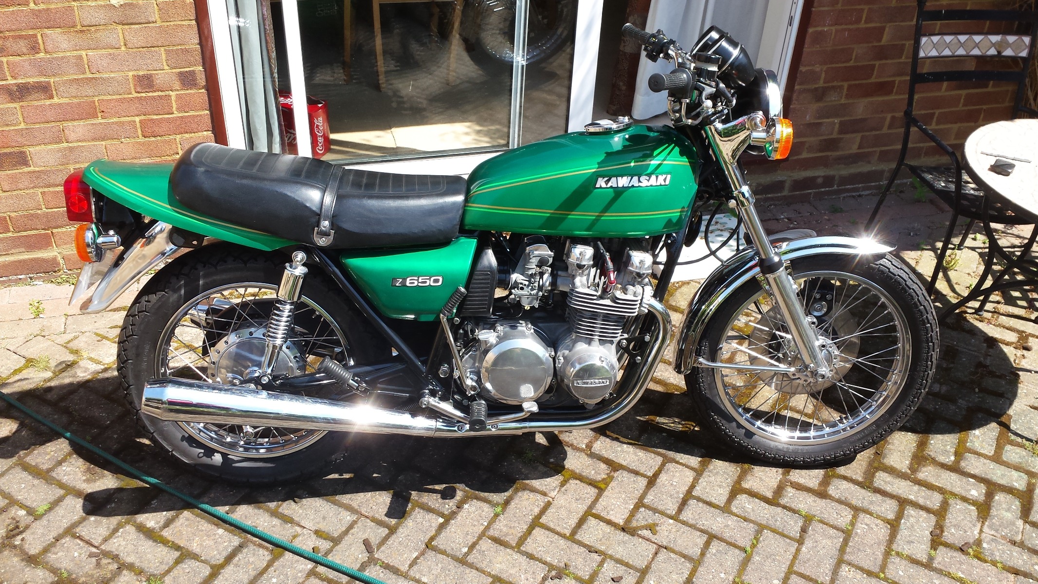

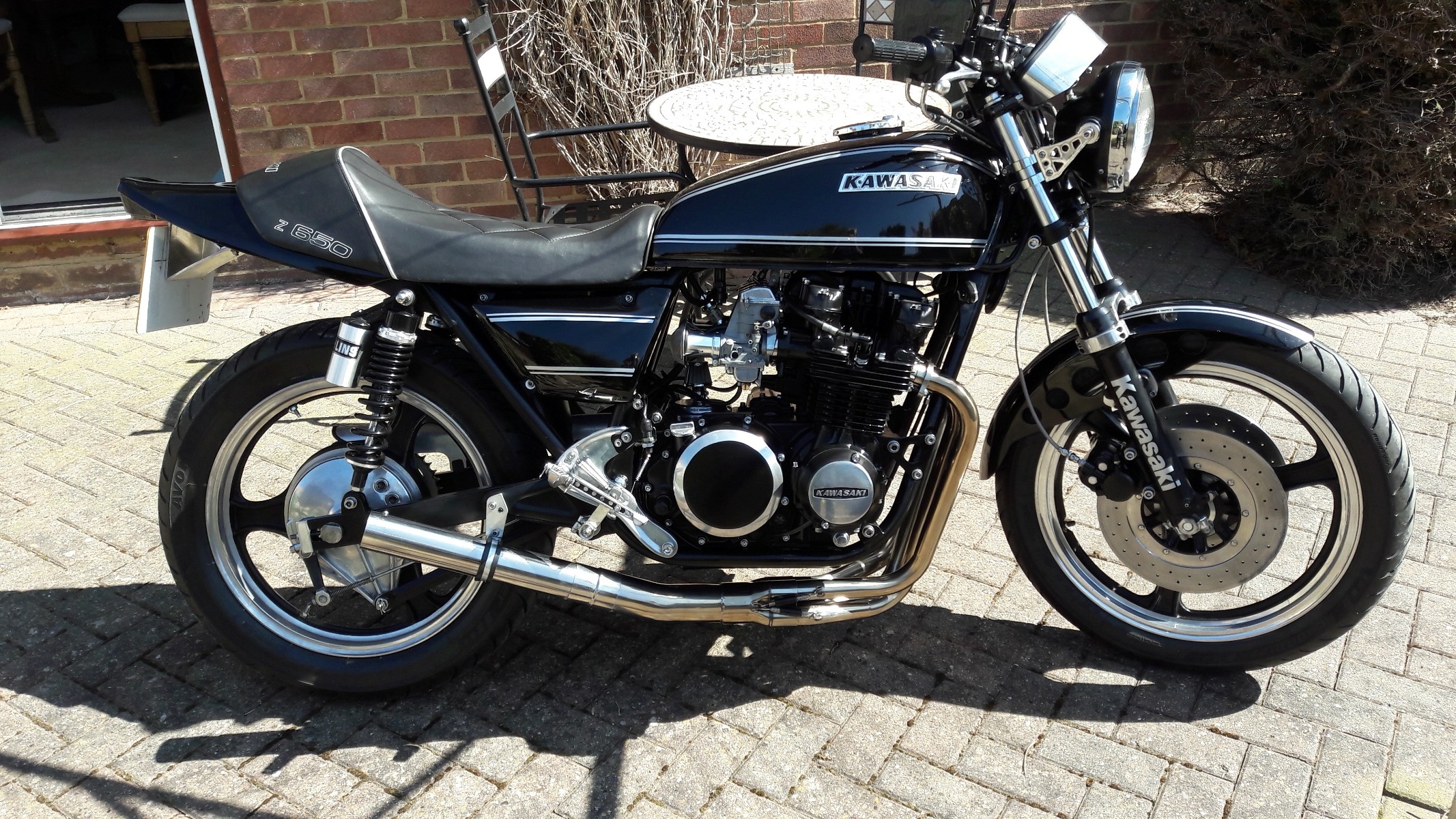

Keep it stock, it run better and look better and be worth more. If you fancy a moded one pick up a wreck for a few hundred and build what you want. Survivors are only original once.
Below is my stock one I bought new in 77 and one which I built to what I actually wanted in 77.

14 Feb 2019 12:24This is very helpful. Thank you.
I do have a question. Not having seen this before how can i tell from this diagram what position the needle should be in for a stock setup?

Stock exhaust, stock airbox, stock jets would mean the needle clip would be 4th slot from the top to be stock. As already mentionedyour carb pics are of vm24ss.

We do indeed it would seem. Not often I run into another. My green bike is 100% stock. My black bike has a 4 into 1, velocity stacks and high comp pistons and skimmed head runs pilotx + 2 sizes and mains + 1 size with needle still in slot 4. Pulls strongly well into the red on this set up and pootles around without issue also.
B7es is the correct ngk plug but I prefer denso equiv as they seem to be more tolerant of abuse.
