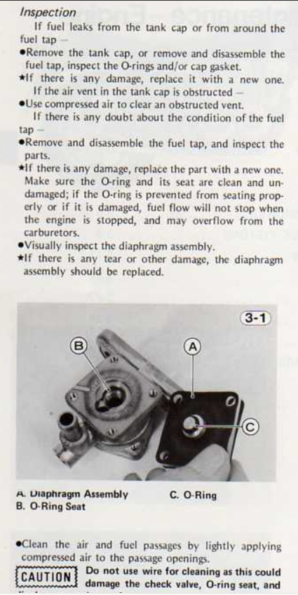

Re: kz650 bogging down after a few miles
10 Feb 2019 06:54
No eBay APP ID and/or Cert ID defined in Kunena configurationYou should put your bike info in your profile , it makes it easier to help
Do you have a Kawasaki shop manual?
if not here is the link to a 81, I don't know if it is the same as the 80 but it should be close
kzrider.com/modules/ServiceManuals/Kawas...l%20KZ650%201981.pdf
Page 3-2 shows the inside of the petcock, over time the wonderful ethanol added fuel we get these days will destroy the original O-rings also over time lacquer from old gas builds up if the bike sits.
don't worry about getting a syringe or vacuum gauge there are easier ways to check the system
