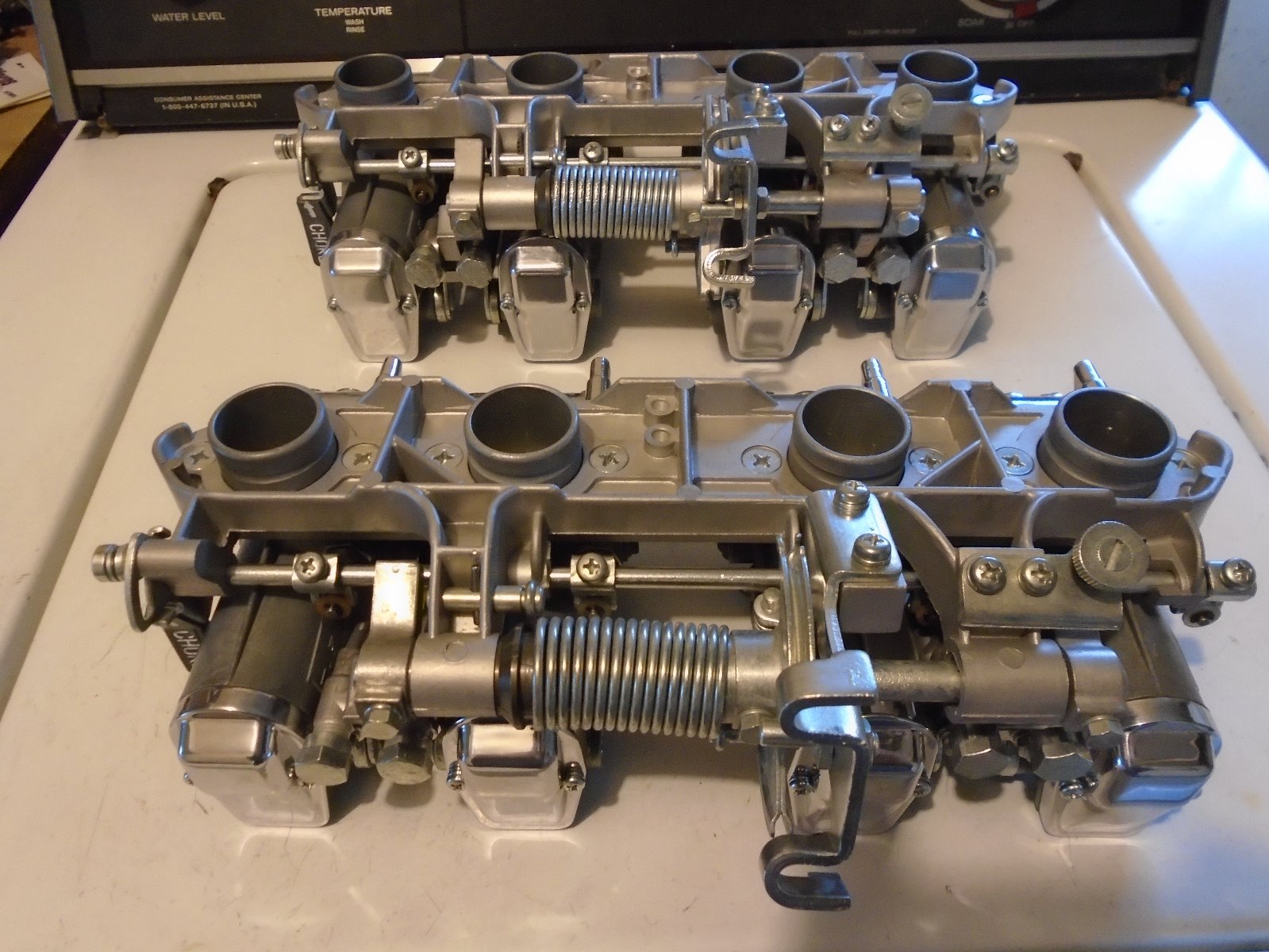

Does anybody know of a source for New
Genuine Mikuni 5J9 Jet Needles? I know they are NLA from Kawasaki. These are the stock needles for the early Z's. Thanks Clay
