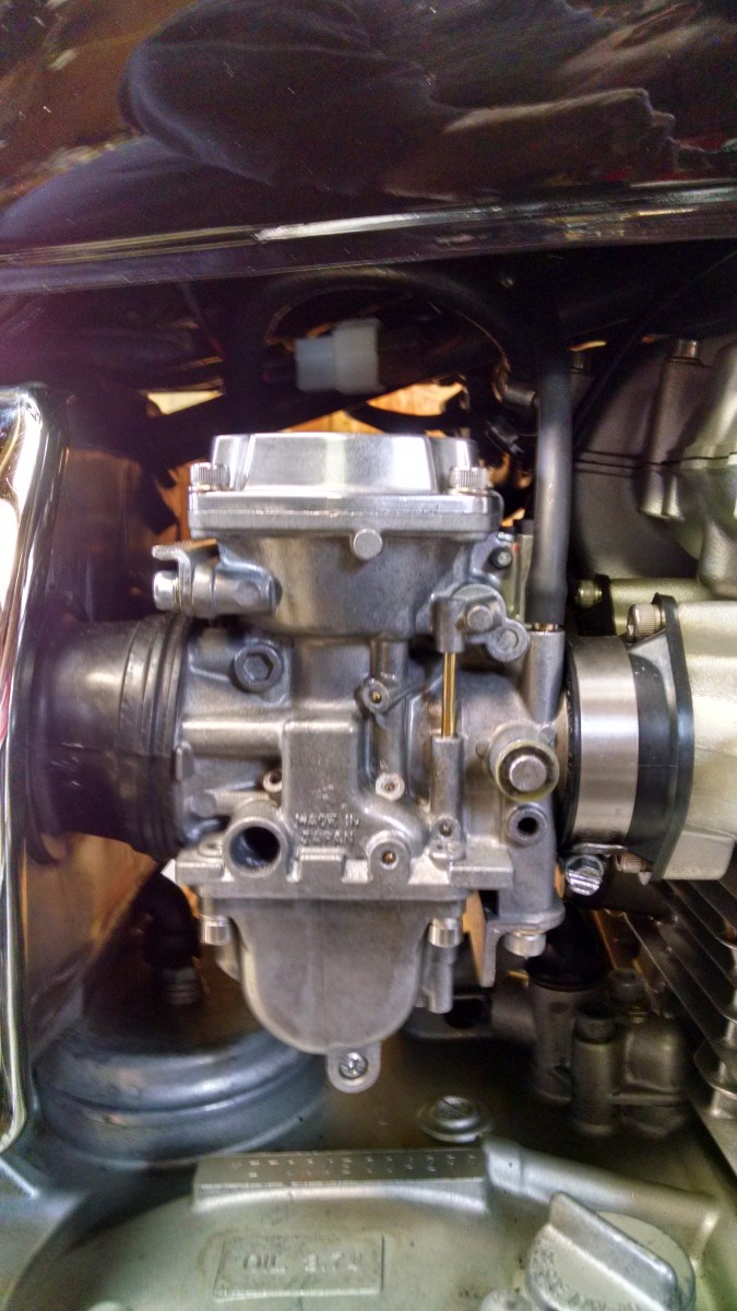

Hi all,
I recently did a lot of work on my kz750 (clutch, head gasket, valves, rebuilt brakes ) and also got married in the middle of all that work, so the bike was sitting for a few months. Everything is back together and riding pretty well *except* I have pretty bad hesitation when accelerating from low rpm. I'm pretty confident this is the pilot system not working as expected.
Now I probably should have dismantled the carbs while they were off, but since there was a lot of other stuff that needed doing, I wanted to make sure I actually finished it, and if it was running badly then I'd have a better idea what it might be.
Now reattaching the carbs was one of the worst parts of reassembly. I have large hands, and while the carb boots don't leak ,they're pretty hard and very difficult to get back into place. It took me almost an hour just to fit the boots. So I'm trying to avoid that. I'm pretty confident that I could take the float bowl off the bottom of the carb and take out the jets and put them in the ultrasonic cleaner to clear them out, but is it likely that the fuel channels and the pilot screw could be gummed up too? Is it even worth doing to just clean the jets, or is this something that really required the full set of carbs to be removed?
Or I might be completely wrong, and it's something else wrong with the carbs - what else should I be looking for? For now I've put some injector cleaner in the fuel and I'll run a few tanks through - it's improved, but still not what it should be.

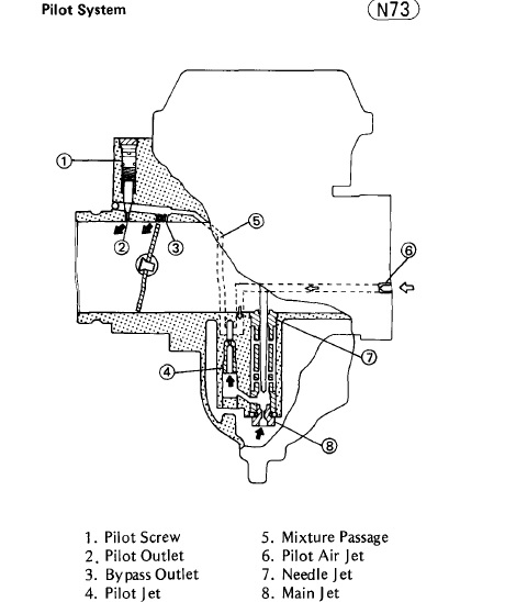

What year kz750 ? 4 cylinder ? what carbs? what rpm?
I had a pretty bad stutter/hesitation at about 2 - 3000 rpm caused by blockage at the pilot bypass - 3 small holes at #3 in the diagram below. Took me months to find the problem. Took a small wire bent at 90 degrees to poke the holes, lots of carb cleaner fired through the pilot jet and compressed air to blow it all out..
IMHO you would need to remove the carbs to do this. Like That GPzGuy said new rubbers are well worth it
