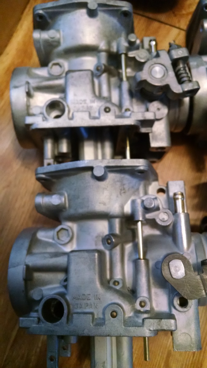

I got a set of 29mm smoothbores that I set it carb c leaner tryong to get them cleaned up for my78 kz 1000 ltd.
they have a little oxidation on them on the outside. anyone know what to put on them to get it off

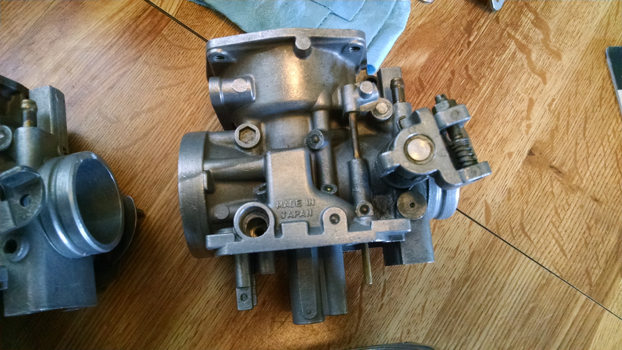

I use a cheap hand held blaster with my underpowered air compressor and baking soda from the grocery store to clean my carbs. It will wipe oxidation right off the carbs and will brighten the surface. (It also works stunningly well at removing carbon from aluminum heads and pistons.) Plus the baking soda won’t plug any passages in the carbs as it instantly dissolves when washed with water.
Don’t fall for the Pine-sol soak. It works, but it also etches the crap out of the aluminumn and your carbs will always look dark and dull. It also will strip any zinc coatings off of plated parts!
I soda blasted off black spray paint off these. (But not the spigots) If I had a better air compressor I could get even better results.
