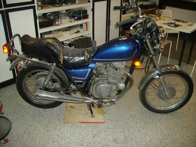

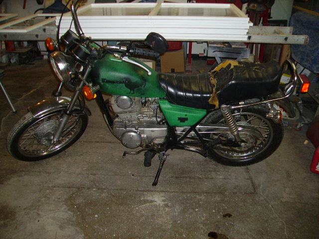

I have a 1980 KZ250 LTD single that has the Keihin CV32MM carb some how someone has cracked the overflow tube and the carb drips gas. I can not find one any one got one they want to part with o a good repair to the one I have. This is how I got it and how it looks now.
