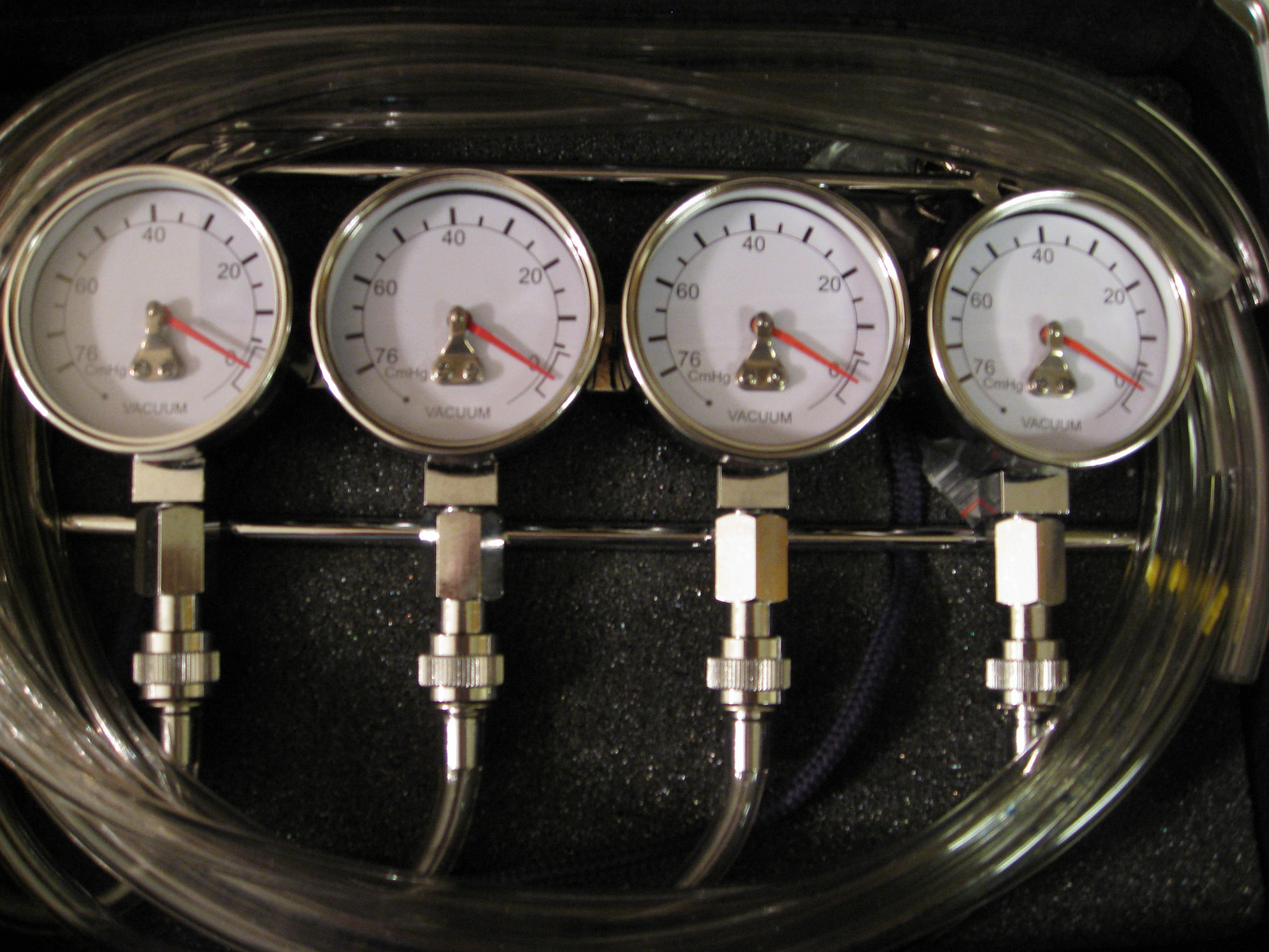

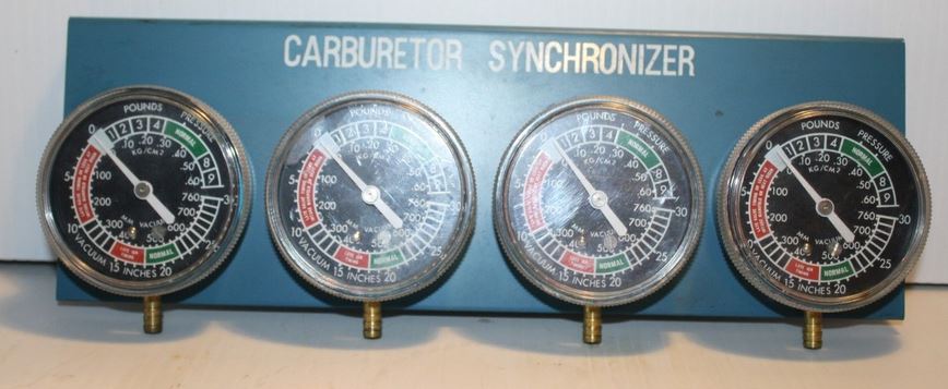

I use gauges for syncing my carbs. The good set (top image below) work very well. The cheap set (like those in the bottom image below) failed to work well - in fact one gauge was quite inaccurate. Whichever type carb sync tool you use I highly recommend that after you set all carbs so they are pulling equal vacuum you should then swap the vacuum tool hoses to different carbs and make sure you get the same readings. If the gauge or mercury type tool is accurate the vacuum levels should not change when you swap the hoses to different carbs. That is how I found out the cheapo gauges were not accurate. Ed
GOOD GAUGES
BAD GAUGES
GOOD GAUGES
BAD GAUGES
