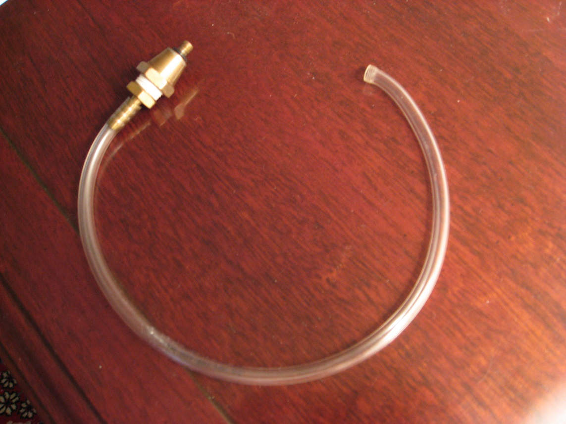

Also is the clear tube method the preferred method for testing the fuel level? If so where can you purchase one of these tubes/screw combos? I assume there is way to make one of these using parts from a hardware store...correct?

Re: What size main jets should I be using?
02 Nov 2018 13:44 - 02 Nov 2018 13:48jadkins91 wrote: .............Also is the clear tube method the preferred method for testing the fuel level? If so where can you purchase one of these tubes/screw combos? I assume there is way to make one of these using parts from a hardware store...correct?
The clear tube method is the only accurate way to test the fuel level. Before the tool was available from anyplace except Kawasaki (for $100.00+) I made my own fuel level tester using an extra carb bowl plug screw, two brass pieces from a hardware store, and some tubing (see image below). It cost me about $20 and a bit more than 1 hour of work. Not long afterwards you could buy the tool already made for less than I paid to make one. Considering that you can buy one now for less than $10 I would suggest simply buying one that’s already made rather than making your own; it will cost less and be a better tool. For sure, if I could have bought one at a reasonable price I would have instead of making one. Ed
TOOL NOW AVAIABLE FOR $8.95
www.z1enterprises.com/fuel-level-gauge-t...kawasaki-suzuki.html
OFFICIAL KAWASAKI TOOL $104.83 (Part Number 57001-208)
www.z1enterprises.com/fuel-level-gauge-tool-kawasaki.html
MY HOMEMADE TOOL
