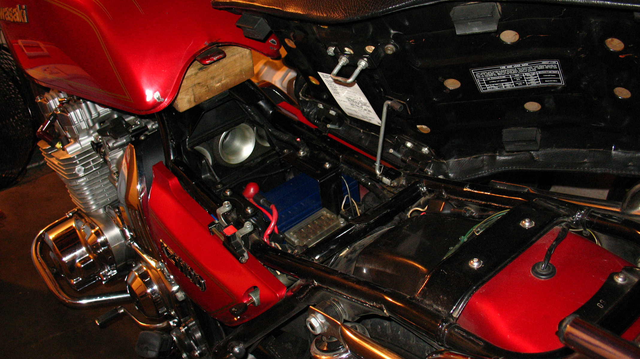

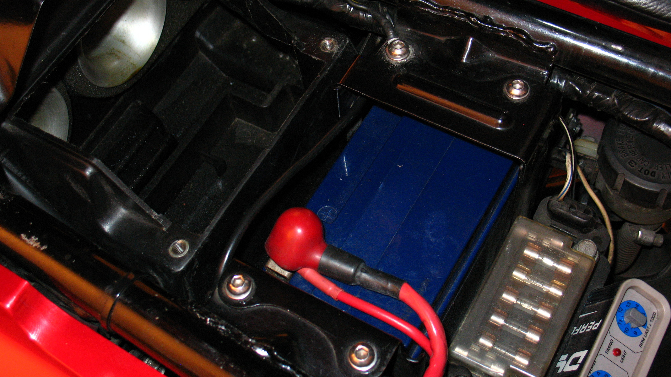

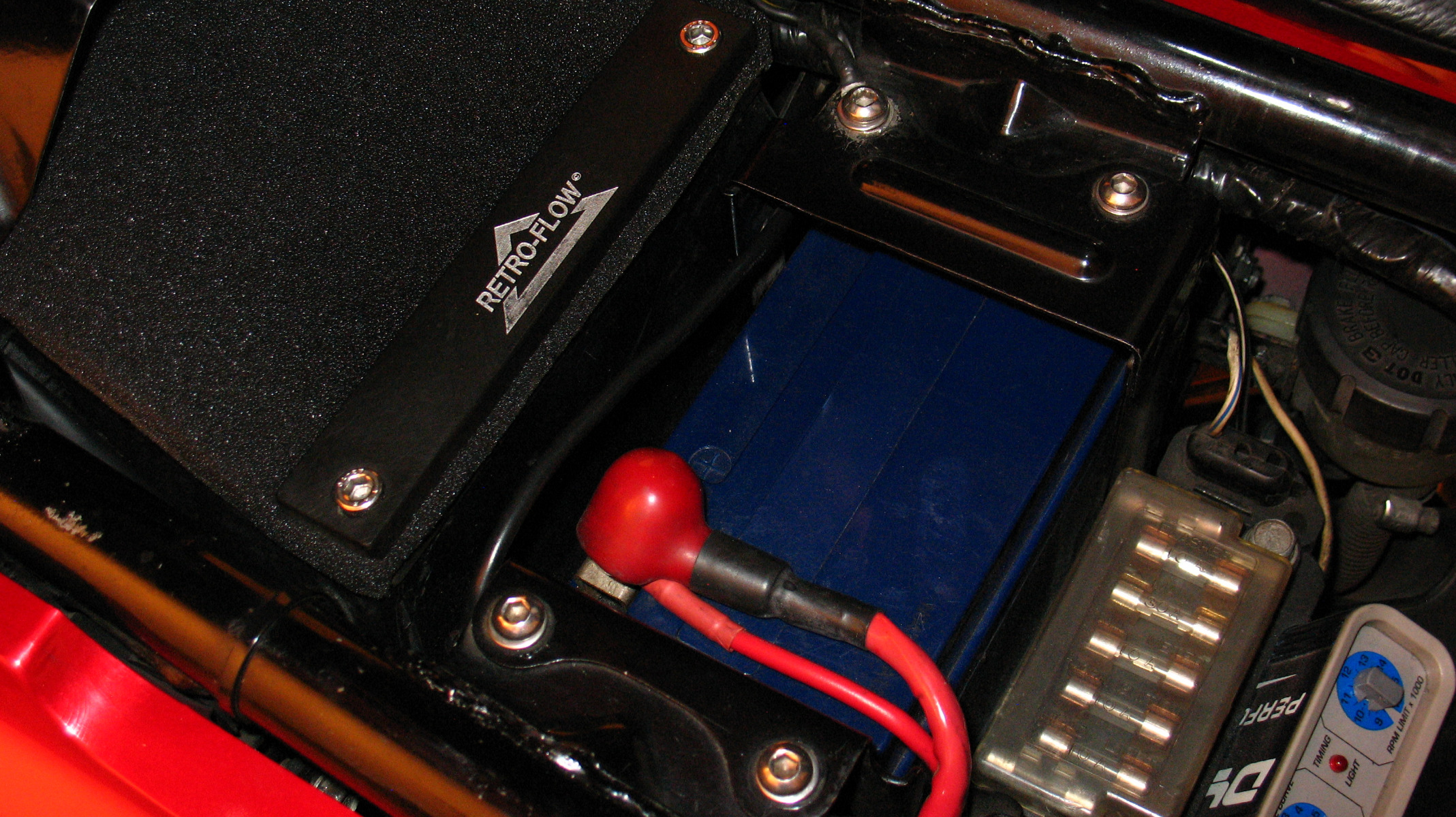

23 Sep 2018 22:05SWest wrote: You've been doing fine. That plug color is worth shooting for.
I think the color should be better after new rings. Considering that project in my basement after pulling the engine, and hauling it down the stairs. Not sure about that one yet.
Here's a couple air box pics with a view from the back. Seeking input how I might improve this modified air box which accommodates Mikuni velocity stacks instead of stock rubber air boots.
1982 KZ1100-A2
- Posts: 8034
- Thanks: 2571
Re: How To
25 Sep 2018 18:28
What needs improving in the air box?
I think it is a brilliant bit of kit that I may copy one day.

25 Sep 2018 19:00TexasKZ wrote: What needs improving in the air box?
Nice complement, thank you...It maintains the sleepy stock look. :whistle:
Perhaps the open interior might accommodate a variable-speed blower regulated by current pulses from the coils or ignition system to control the rpms and maintain constant positive air pressure to the carbs. Probably not a practical concept, but the thought seems simple enough.
