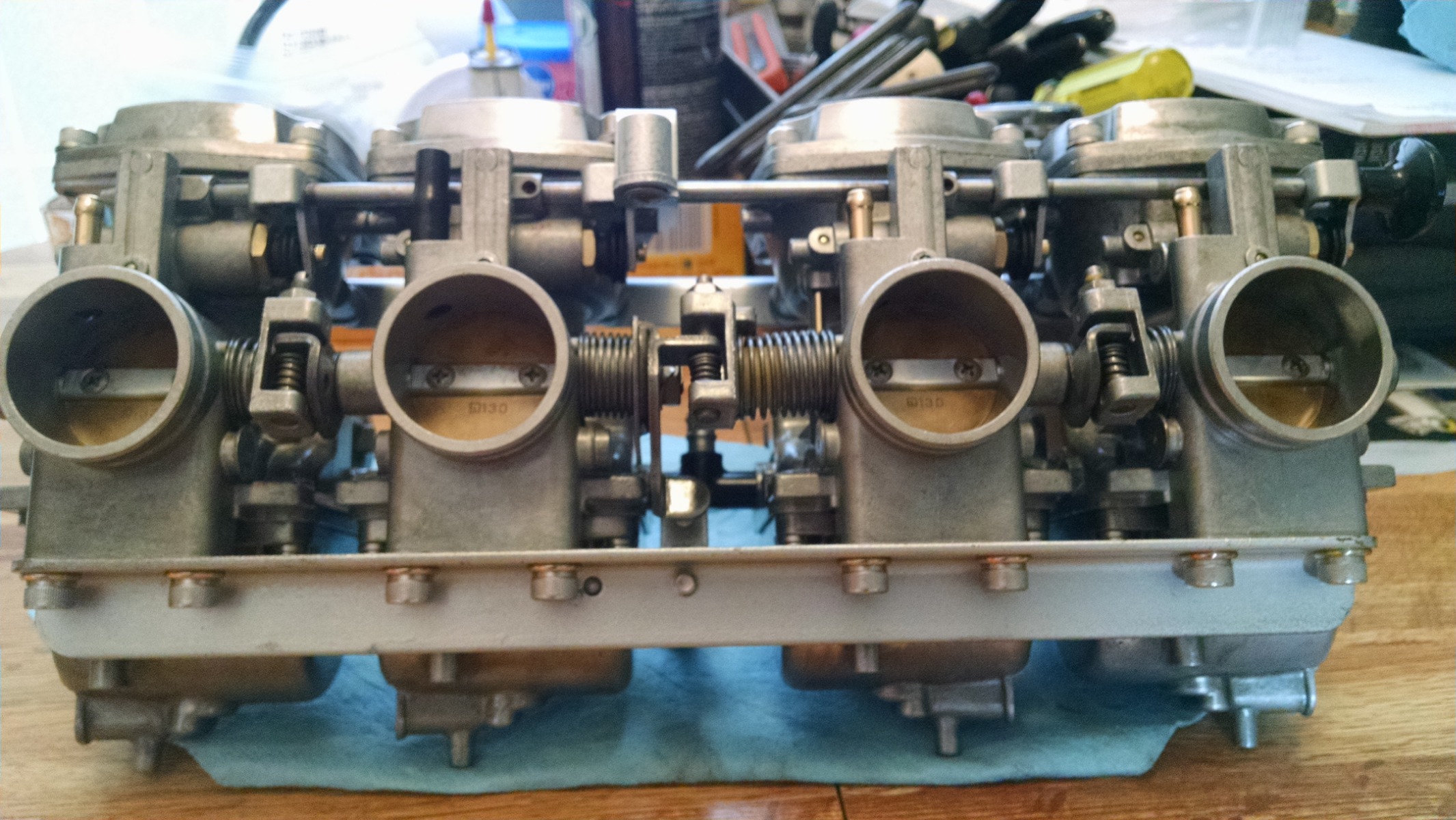

I recently got a 1981 kz1000 k bobber on a trade its a non running bike but i cleaned and rebuilt the carb but i dont think the line coming from the tank to the carbs are right can anyone tell me how they are supposed to be. The why they are set now if you are sitting on the bike the far left being one and the far right being 4. One has one ling running to it and 2 has no line but instead a black cap over the nippel and 3&4 share a line with a t ine the gas line it doesnt make sense to me to run them this way but thats how it came any help or picture would be very much appreciated

First photo is how its setup now and how i got it second is a video of someone talking about the carbs

They look right. The fuel, as others pointed out goes into a "T" between carb 2-3. The vac hose on mine was and still is on carbs 2-4. The vac lines went to a and emission hose EGR setup, which is probably no longer on the bike,
