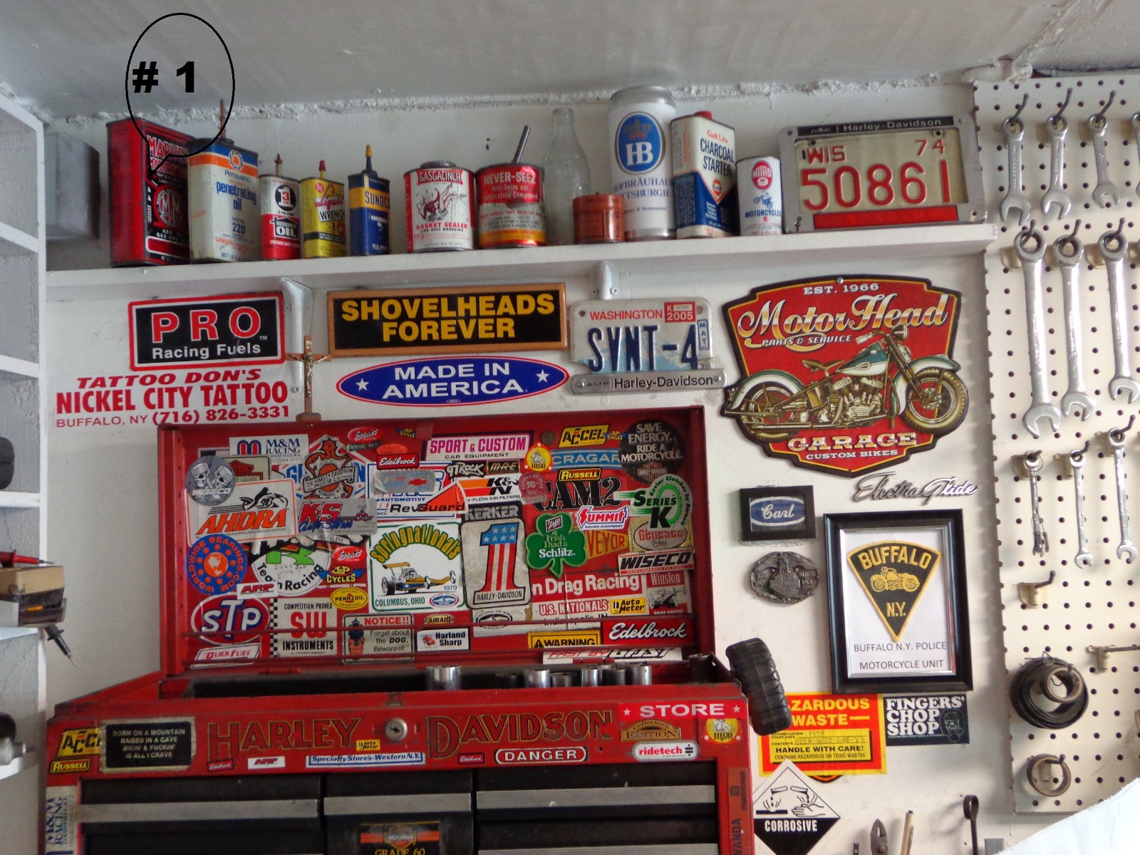

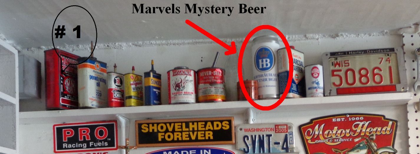

14 Sep 2018 12:21 - 14 Sep 2018 12:23
Last edit: 14 Sep 2018 12:23 by Scirocco.

I use Marvels for a few things, as a gas additive to help clean the carb (maybe twice a season) , as a solvent mix with motor oil to clean transmissions and I dump some in with my oil for the last ride before an oil change. I like it!
Never tried that Mystery beer before but I think I should
