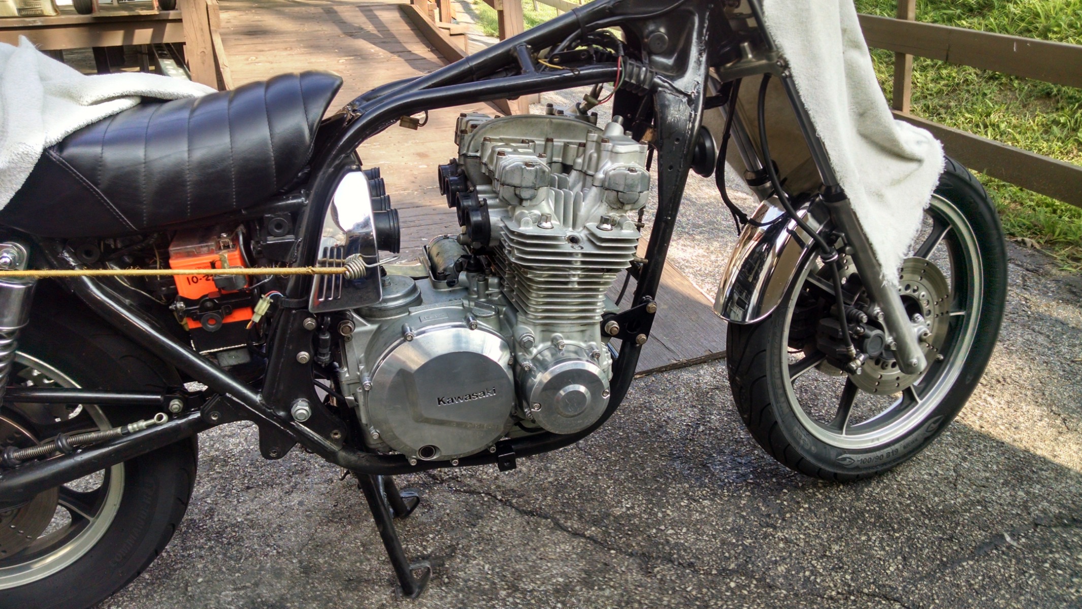

I am am quite sure everyone has their own methods for installing the carbs, while using the stock air box, but I used what works for me. I have the spring clamps already in place, rolled back , away from the installed position rubber groove.. I removed the battery box bolts and take the bolt out of the rear master cylinder reservoir, then pull the battery box and air box back as far as I can, until it is tight against the frame tubing and hold it back with a bungee cord. After reading how it is actually supposed to be done in the manual, I want to try pulling the boots into the air box next time.

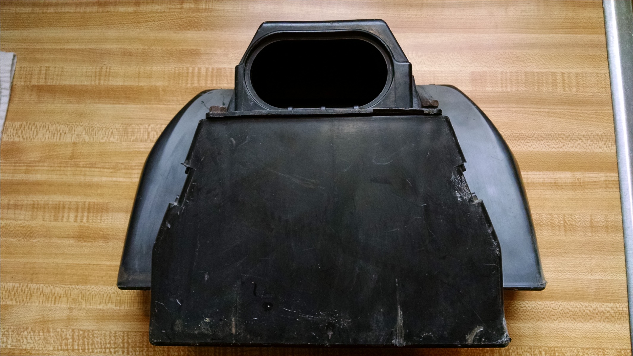

I am guessing the difficulty of installing the carbs would be one of the main reasons people go to the pod air filters (or no filters) and just remove it. Mine was already gone when I got my bike, after inquiring at Archway >international< Motorcycle Salvage, after being quoted $150.00, I bought two on eBay for 40 bucks each. (I have 2 spares if anyone needs one) blatant plug here. lol

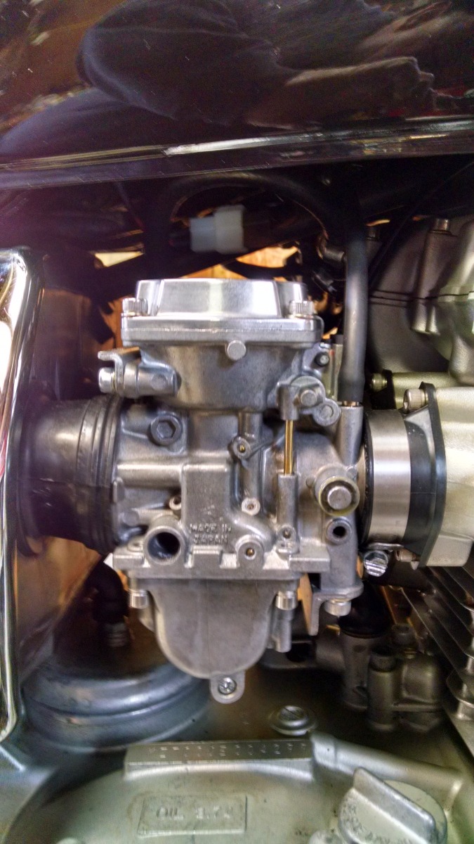

After reinstalling last January.

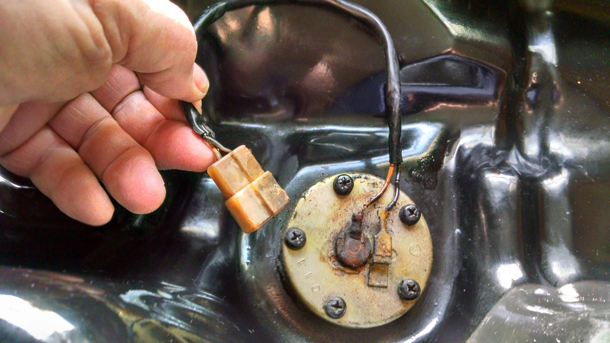

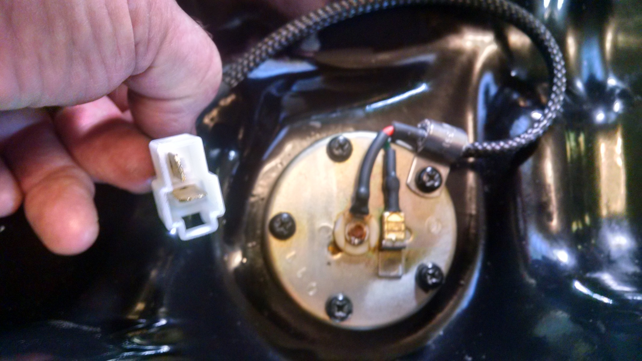

I also noticed the fuel gauge sender had seen better days.
I found a new plug and fittings at Gateway Electronics. I replaced the blob of glue over the riveted fitting with some JB weld prior to installing the tank.

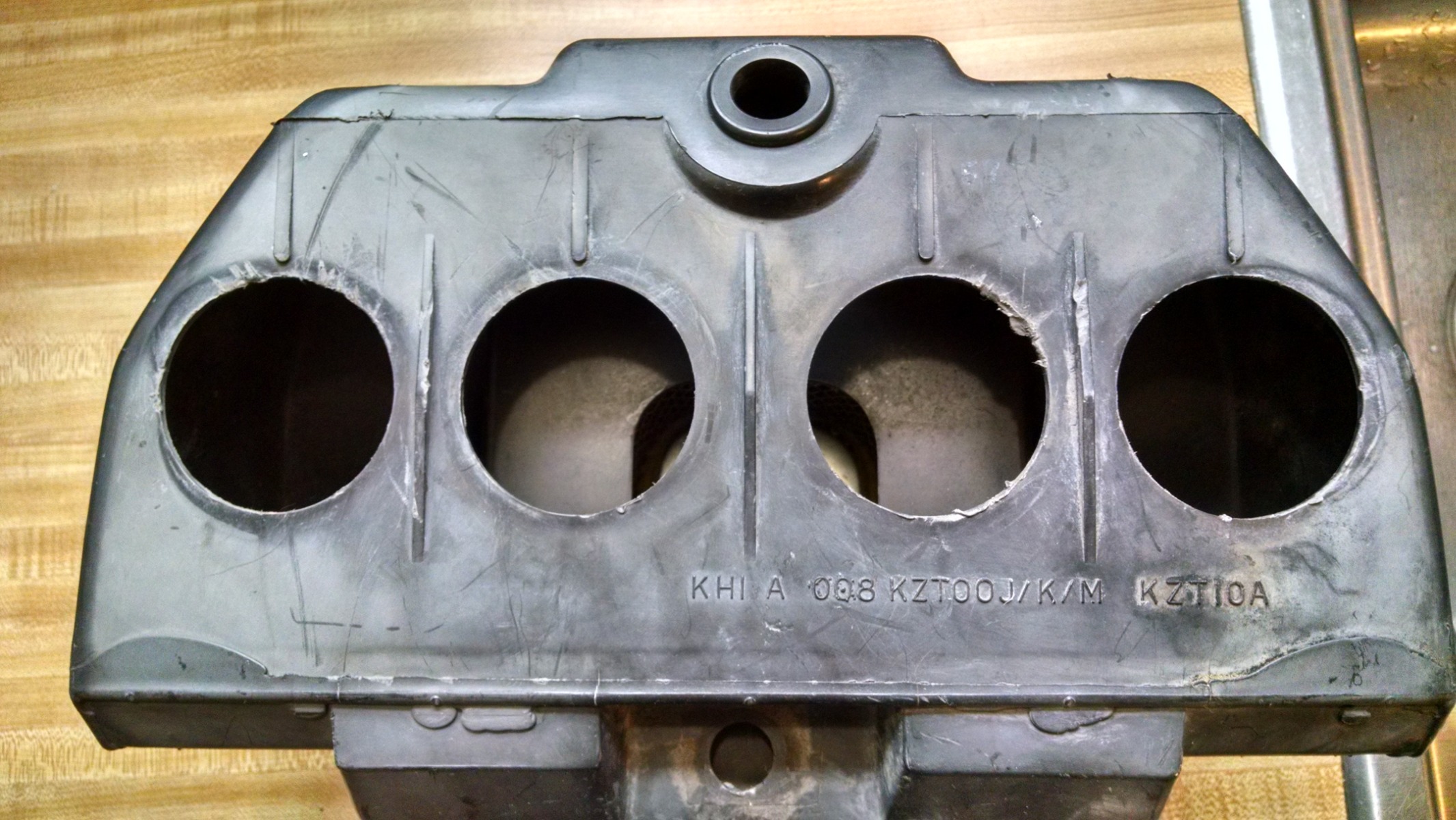

Except, the CV carbs need the air box restriction to function properly. (from my understanding) AND it changes the fuel / air ratio and requires re-jetting. Soo, in effect in order to eliminate a little bit of frustration in installing the carbs with the air box, you create a whole LOT of frustration trying to figure out why your bike sputters and pops, and no longer runs right.
Not really a fair trade off IMHO.

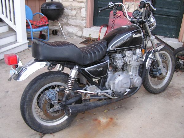

This is a spare I got off of eBay. If one is good, 3 is better. lol (I had another 81 Kz 1000 at the time that also ran like a bat out a hell)
Needs rubber boots.
I had to loosen the calipers to get this one to roll onto my trailer. Notice the rust stains underneath and no air box. Another screwed up title with screwed up lien release from Kansas.
