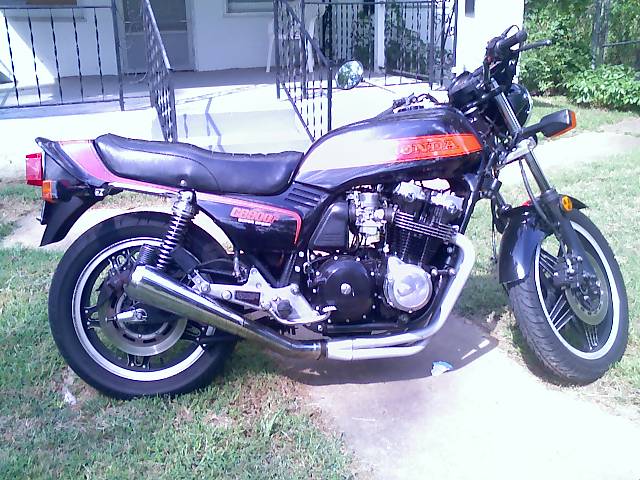

Here is the pick of the bike.
I went to see a friend and he said to put the pods back as it was jetted with them and should improve performance, we noted that the joshimura exhaust is getting yellow in the union with the baffle so he we think that the exhaust is to narrow for the engine and also that the carbs might need to be 33 or 36 mm.
Wich carbs are the best option to go for carbs and header keeping in mind budget and street ride.
He said that the Keihin are more for racing and it will not make me happy for street use

Absolutely gorgeous bike! You should insert the attachments into your post so they show as you scroll through the thread.

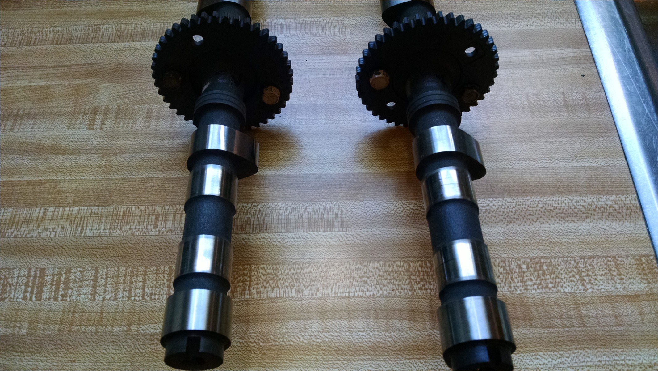

Well one of the more experienced tuners probably can recommend carbs, if you are looking to toss more money at this bike. If you want this bike to be more streetable, more and bigger may not be a good thing, and possibly could turn into another thing to deal with. In adding almost 400cc's to a 1000 cc motor, the cylinder sleves are also paper thin at this point. (100cc per hole?) This bike will also have dependability issues, besides frequently running poorly in normal riding. My 900cc Honda had thin sleeves with only a 200cc overall increase in engine displacement. it will be fun to ride in between those frequent repairs, though.
Maybe instead of looking for bigger carbs, a more streetable top end / cams might be a better thing to look into.
Also, why does it run like it does? It is probably his reasoning for selling it. Just my uneducated guessing here. Bone stock works best. Those bikes were fast and dependable completely stock. One thing people don't seem to notice, or remember, that racers also overhaul their motors after either one or a few races. High performance = enjoy it while it lasts.
The 2 rings next to the cam gears are the "cam identifiers" on my stock 81 Kz1000 cams, as an example.

Do you have closer pics of the engine.
It's hard to tell but it doesn't look like a big block from the images ?
Maybe it's the paint finish.
The stock block will only accept 1260 liners at the max and 1395 would need a big block and they usually have a cast identifier of the maker on the ends, APE, Wiseco, Orient Express etc.
Maybe i'm wrong but the PO may have "detuned" the engine dropping on a stock block with a mix of the ex race parts that don't want to work together.
If you have drag spec cams fitted they will probably be too long a duration for the street, hence the fuel blow back at low speeds and you would be better either fitting a good set of stock cams dialled in or something like the PSP3's from Pitstop performance..
You need to get the bike to someone who can really tell you what you have and let them sort out the good from the bad.
It will save a lot of costly mistakes in the long run if you don't really understand which parts are actually suitable for your requirements.
