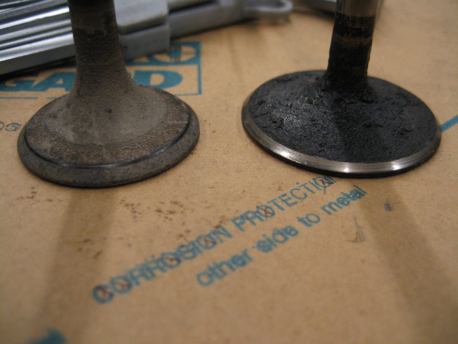

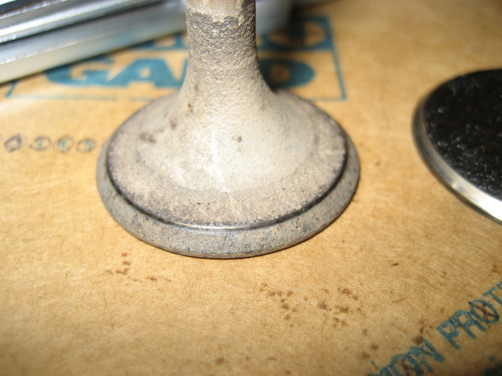

It looks like you need a valve job to get a proper valve to valve seat ring sealing. A carbon build up on the valve/valve seat is a PITA
I don´t know the engine history/milage but an insufficient intake valve sealing can cause a back firing into the inlet ports/carbs.
A compression/leak down test tell you the truth about your engine.
