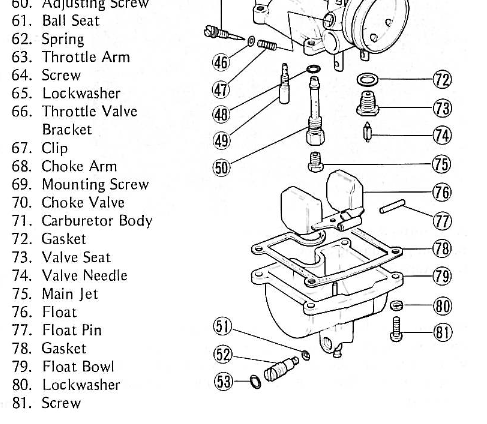

Have you polished the valve seats and valve needles yet?
73 and 74 on the diagram
They are what stops the fuel from flowing if the floats are set right, a little bit of crud will keep them from seating properly .
I use a Q-tip with some metal polish to do the valve seat and a cotton T-shirt for the needle , make sure that spring thingy moves in and out freely on the needles
I suggest taking the valve seats out to do this and wash them in soapy water after you are done.
