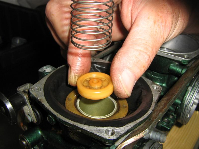

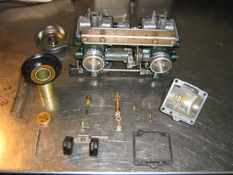

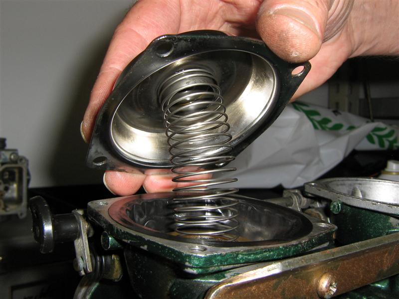

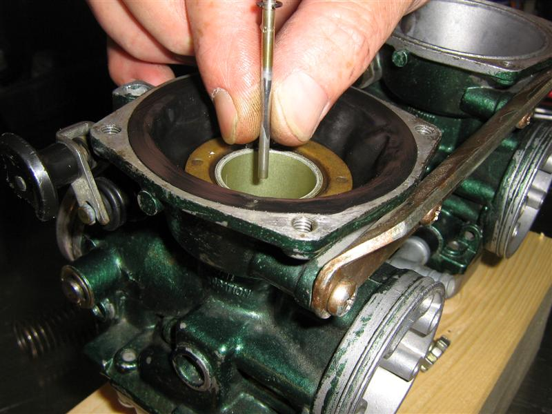

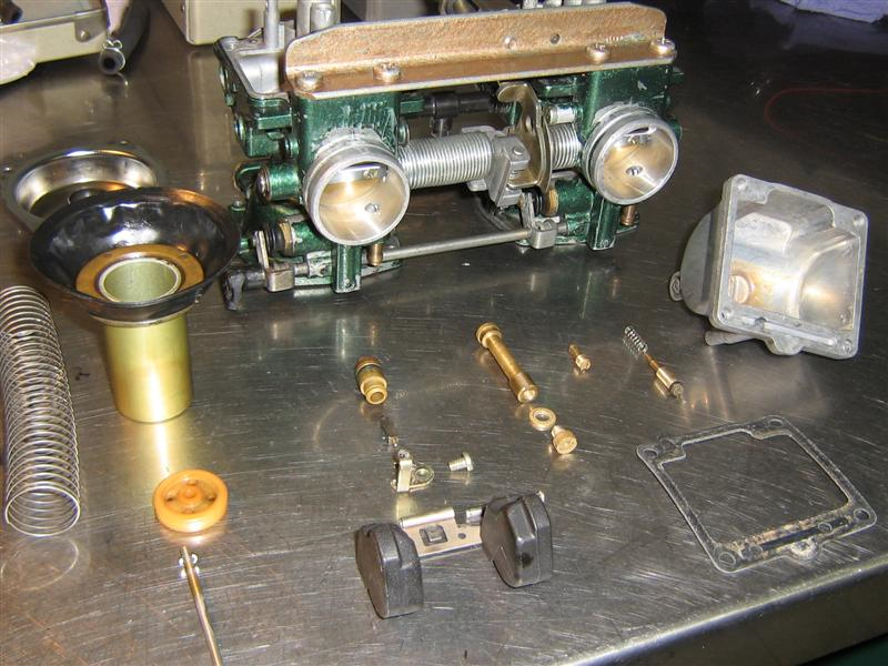

Here is a web side that shows the installation of the needle and plastic washer in the slides. Technically impossible that the needle lift up 10 - 15 mm in the slide with the spring/washer on the E-Clip!!! Missing E-Clip or weak spring ???
www.z750twin.de/vergaser.htm

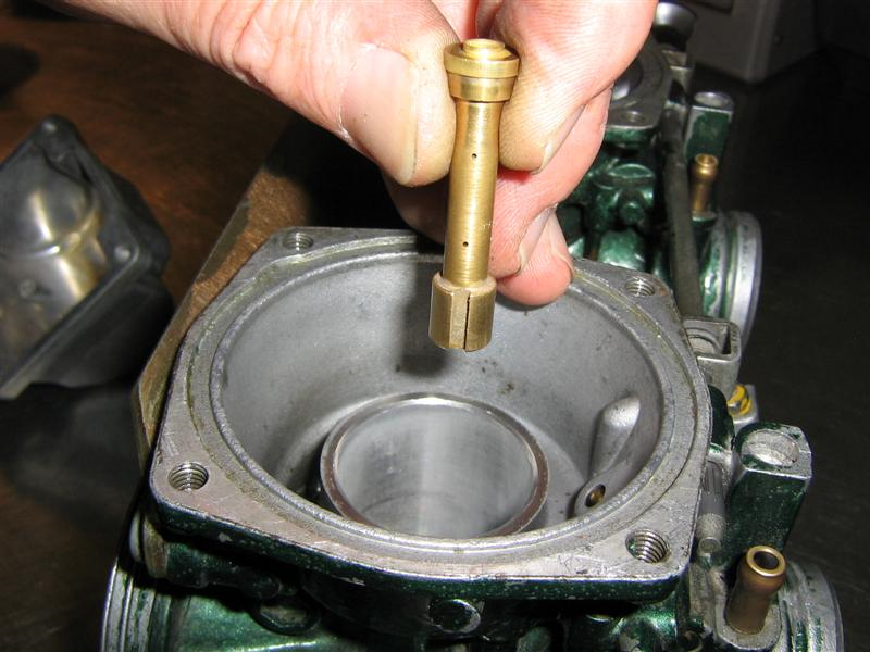

I would pull the needle jet if something is in there that let the needle not get full in.
Could it be that the needle is a little bit bent???
