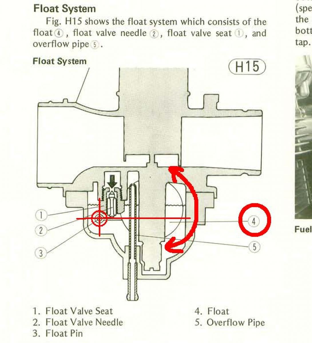

This reminds me of an carb rebuild some days ago here on KZR where the float was installed upside down. Same symptoms (Gremlins???):whistle: :whistle: :whistle:
