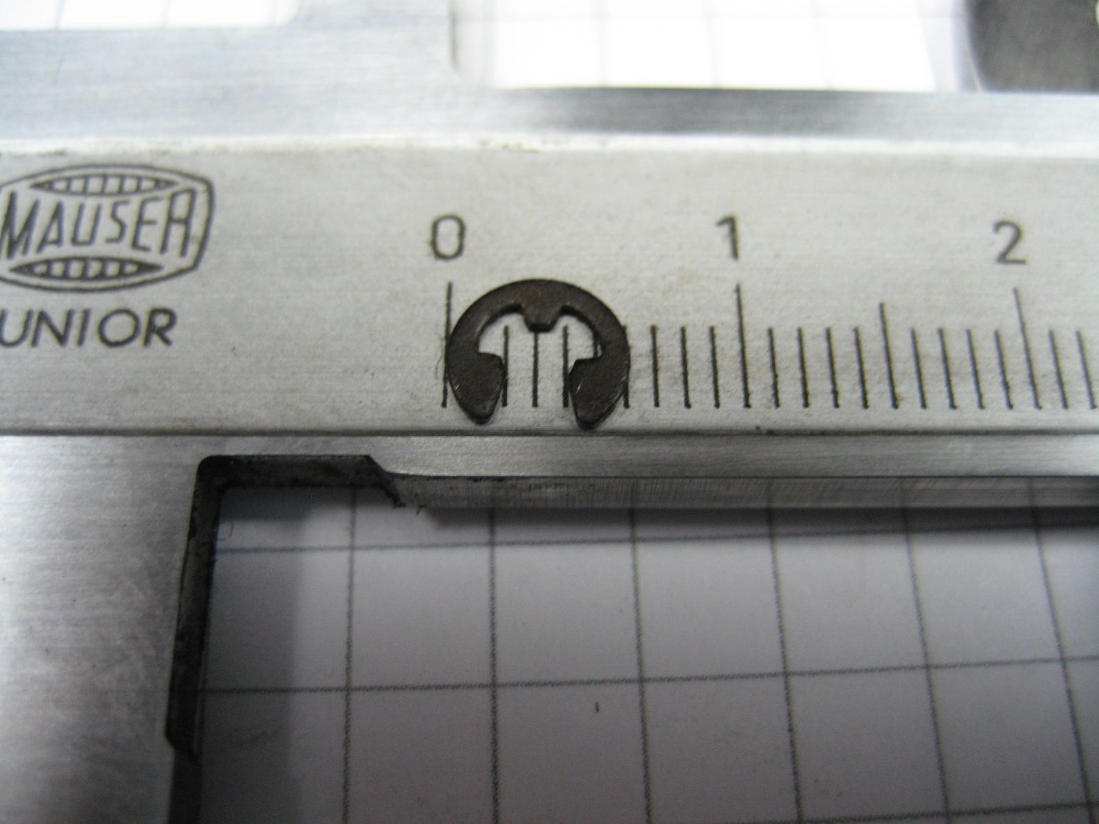

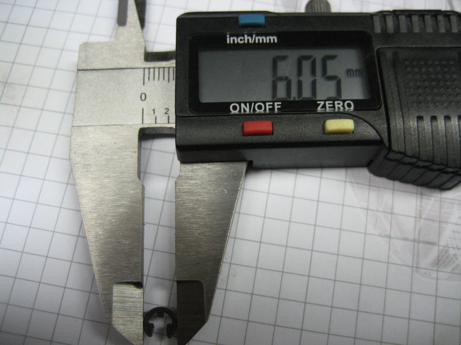

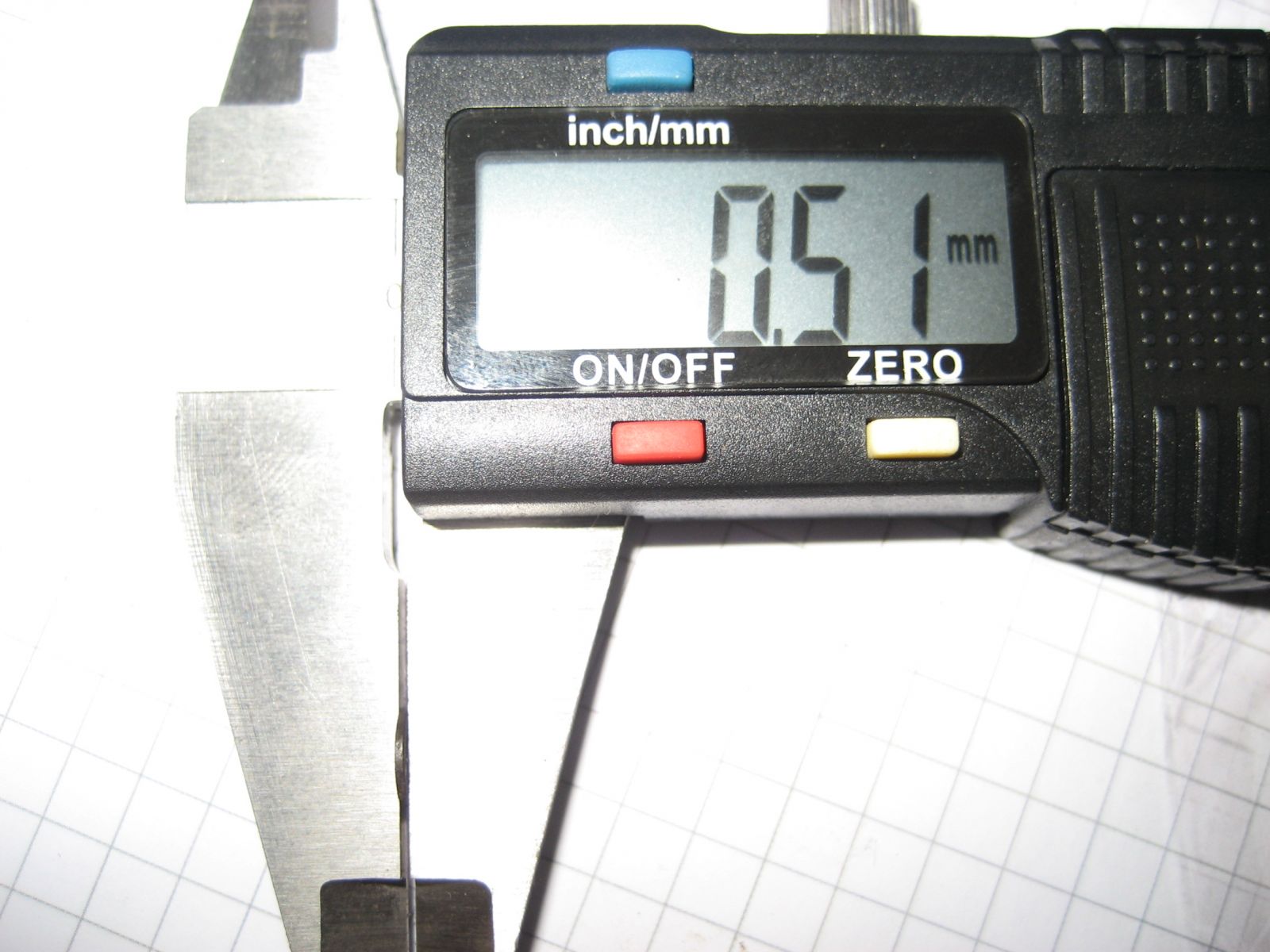

Hello Warren3200gt
E-clips OD = 6,05 mm = 0,238 inch
E-clips opening = 2,00 mm = 0,078 inch
E-clips thickness = 0,51 mm 0 0,020 inch
Michael

Perfect, thanks Michael.

The eclips are called 2.3mm (ID is the measurement used to buy eclips)

Great, ordered and on their way. Cheers.
