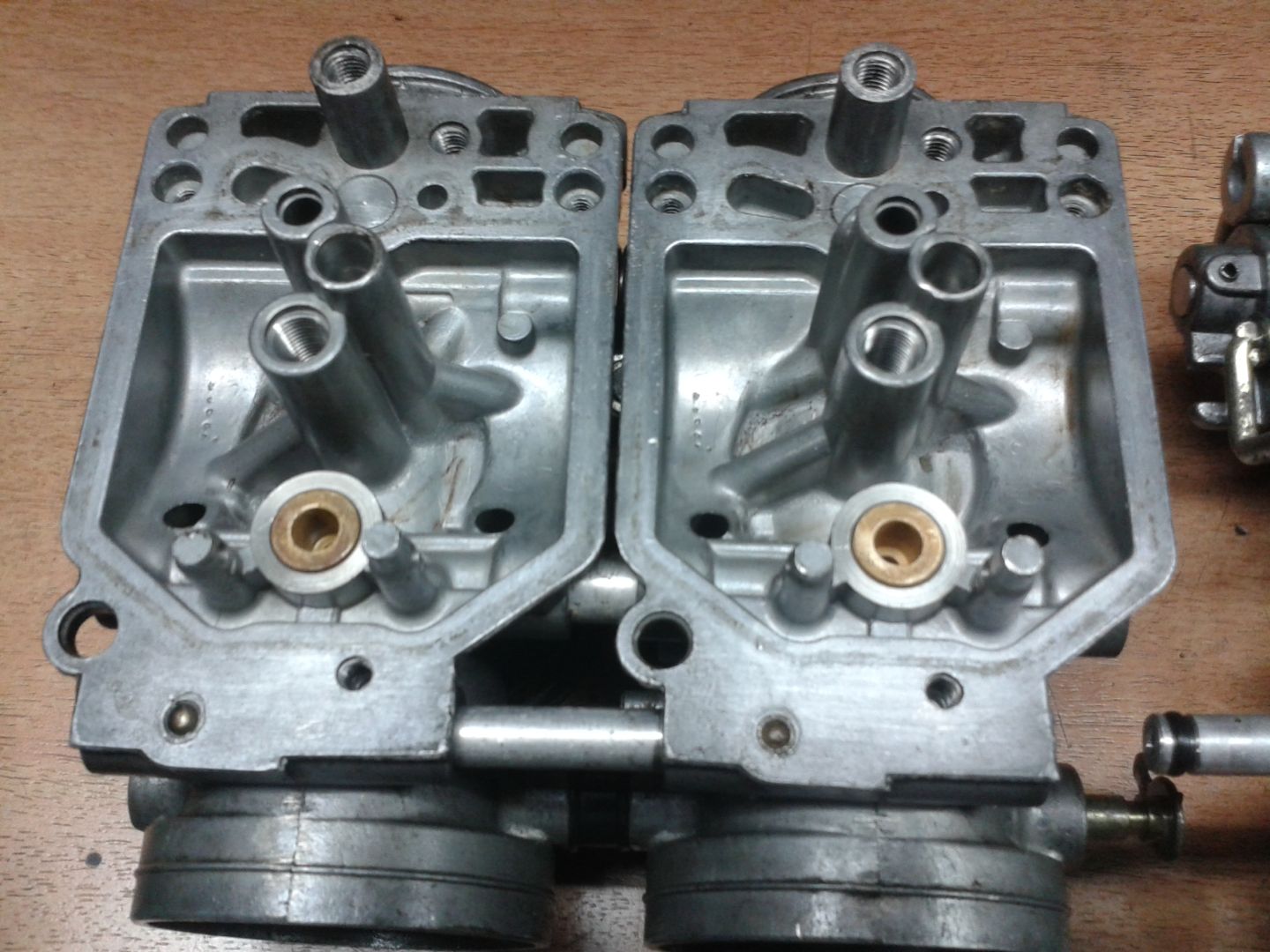

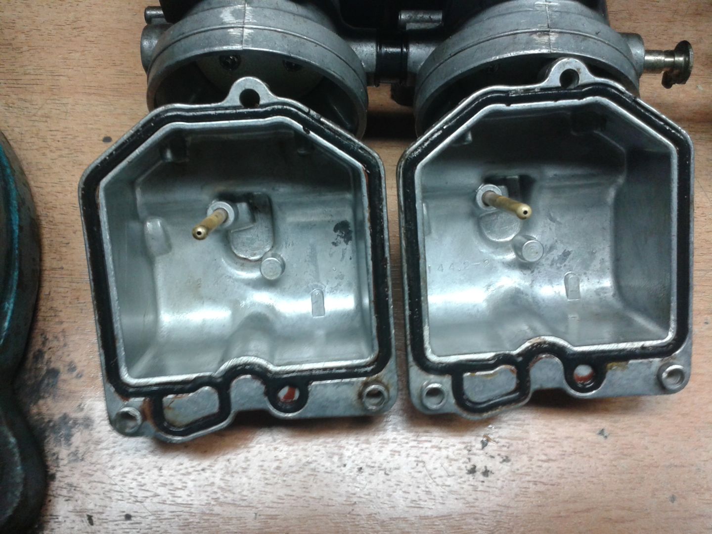

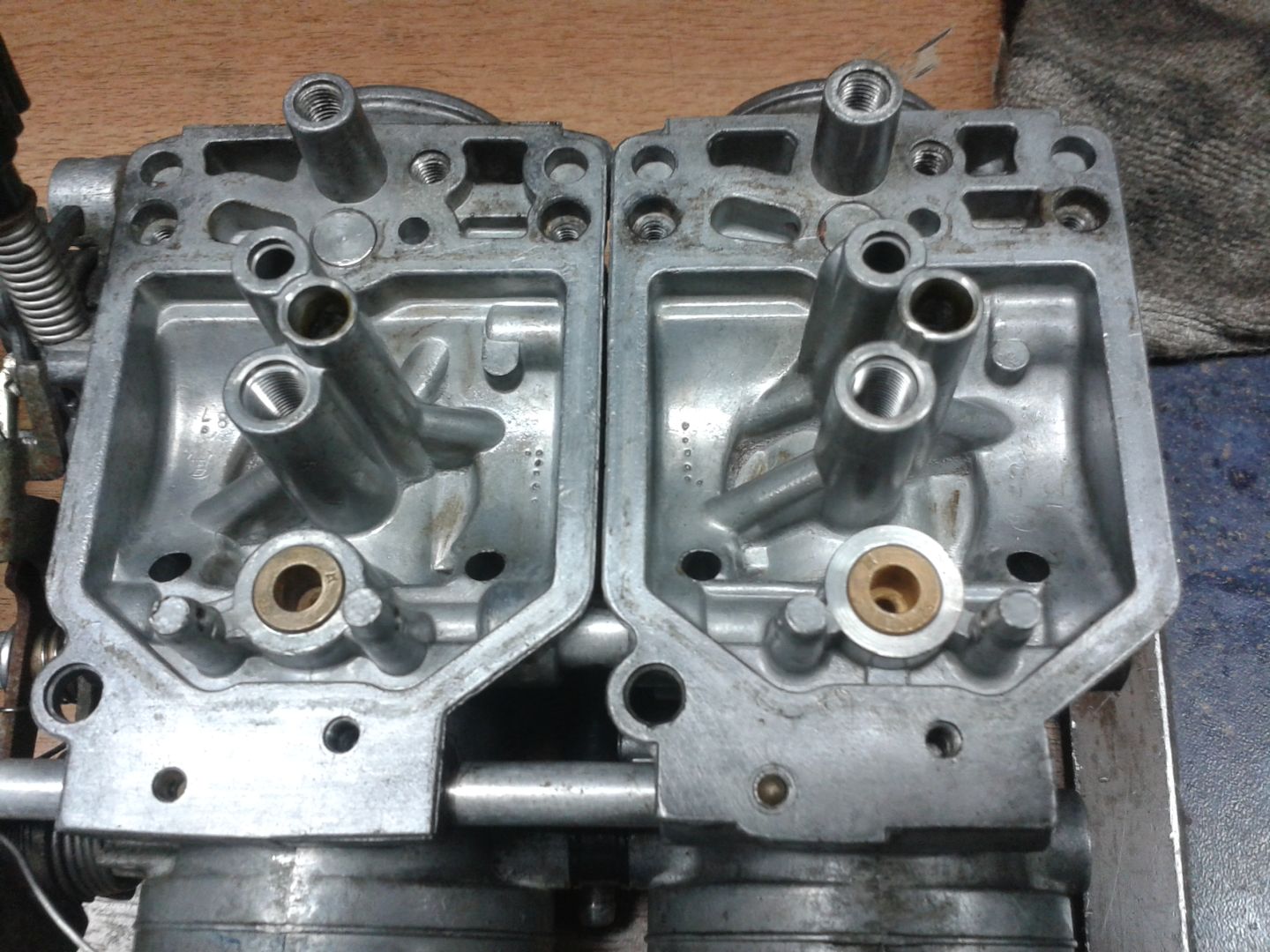

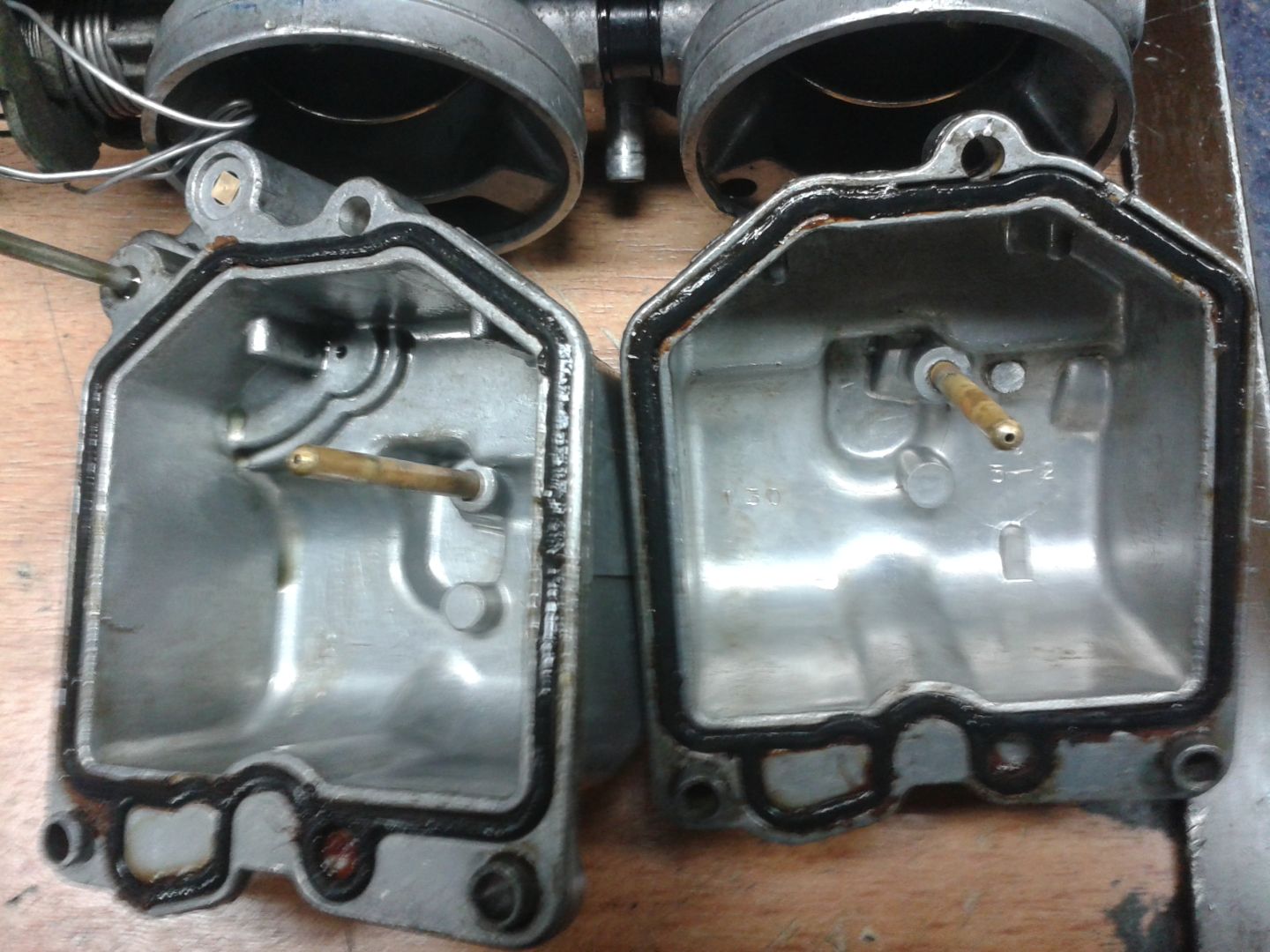

I cleaned a all my/friends carb sets with ERC carb dip.
This Honda carb set was full of brown and green brass oxid/fuel residue.
All parts separated 24 hours in dip let all part looks like new without an ultra sonic cleaner.
The carb cleaner is reusable and can be diluted with fuel.
Michael
