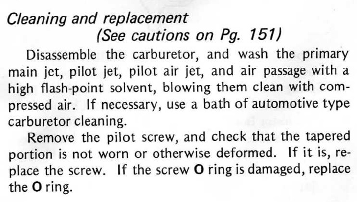

You shortcut the carb cleaning process. You can download a copy of the factory manual for free from this link...
www.750turbo.com/manuals/
Get the file titled GPz750 Base Manual
Check page 150 for details about the carbs.

17 May 2018 20:29Nessism wrote: You shortcut the carb cleaning process. You can download a copy of the factory manual for free from this link... www.750turbo.com/manuals/
Thanks for the link! i did all this besides removing the pilot screw. do i need to drill the small plugs on the top of the carbs to get to the screws? what really confuses me is why would the one cylinder that does not work be different every time i mess with it?

The Pilot Screws need to come out in order to clean the pilot circuit. Also, the Bleed Pipes need to come out for cleaning because they have a very small orifice on the end.
Further, in my experience having rebuilt more than a half dozen sets of those carbs the O-rings on the fuel Tee and the fuel transfer tubes will be hard and brittle, which is why unganging the carbs is always best (so the O-rings can be replaced).
