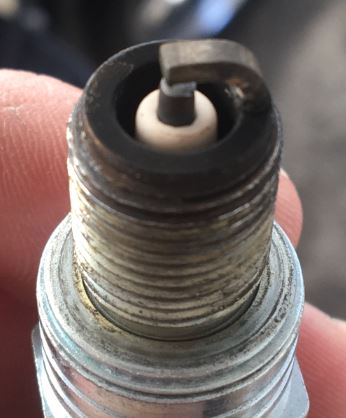

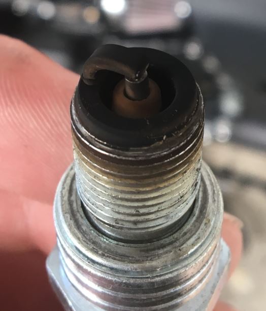

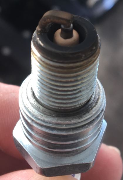

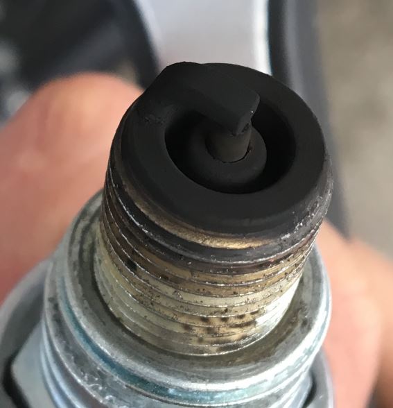

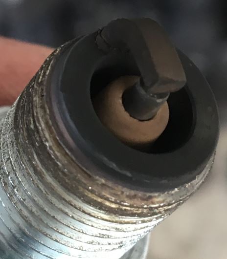

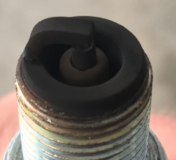

I took photos of the spark plug today, they are now from the startup of the engine 1-2 weeks ago.
Cylinder 1:
Cylinder 2:
Cylinder 3:
Cylinder 4:
When I got the petstock working and can start up the engine, will it be a good idea to use start gas around the inlet to sett if the RPM change
Cylinder 1:
Cylinder 2:
Cylinder 3:
Cylinder 4:

Plugs 2 & 4 are way too rich.

Not burning as they should. There's your clue.

2. Figure out why 2 & 4 is to reach, properly the air / mix screw incorrect position, can be something else?
Is there a big possibility these is the reason for the off idle problem also?
Can these also be the problem with middle range?
Is there any problem cleaning the spark plugs with patrol, so its easier to see what happens when I take them out after start up?

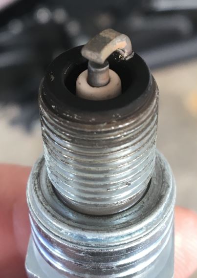

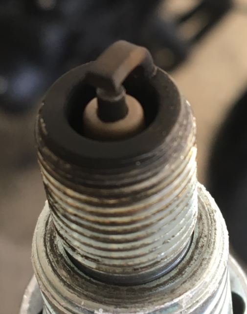

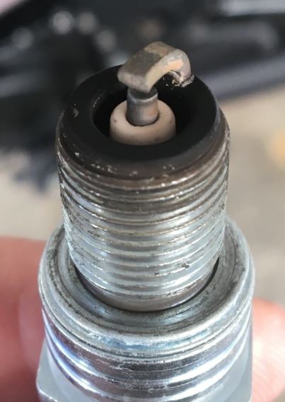

I have cleaned the plug and was running for 1,5-2 hours yesterday. Today have I taken out the plugs for investigation, please see picture below.
The only thing I have done on the engine since last time we was checking the plug is the bolts for the carb. holders, now I`m 100% sure the hose clamp are tighten.
When I was out driving I was thinking these it maybe good enough for a while, have some fun on the bike the next week, and then try to optimize more...
I have a feeling its better now then before, but I still have problem with the middle range and off idle, the off idle is maybe some better now.
But the bike is good enough to be used, but not perfect, lets say 80% ? will try to get to 90%....
If you look at the picture I will say all looks good accept for the cylinder 2 ?
I have new plugs, new coils, and new plug cabels, I have good power on the coils almost the same as on the battery.
