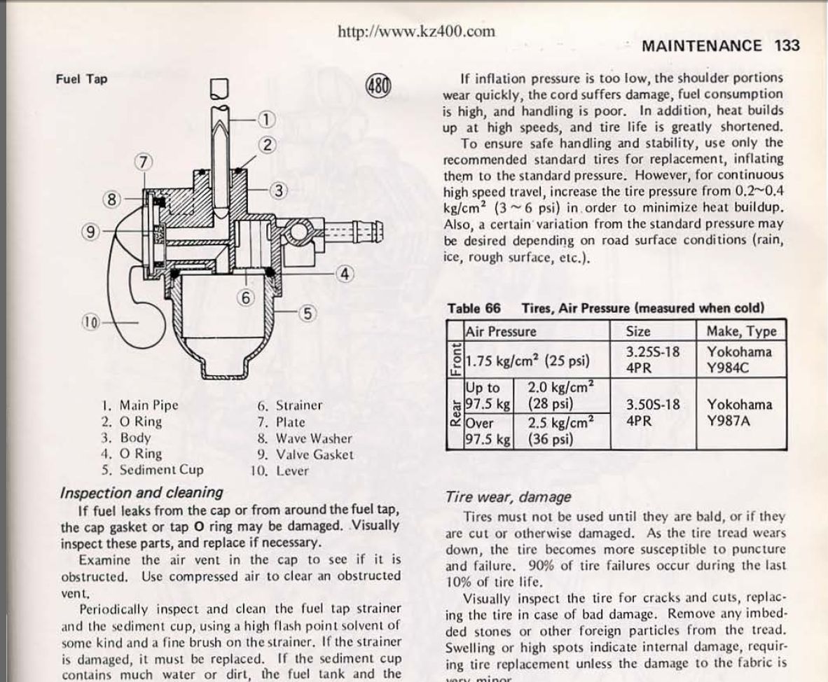

Here are the pics of what I am looking at. I found a four-hole packing on ebay that said it was the original oem part number. It seemed to fit. I previously bought one that was the completely wrong size. Any help would be appreciated. I am looking forward to riding, but need to figure out fuel leak first. ThatGPzGuy, you said that the CB750 packing would work?

If you are going to take the time to disassemble the petcock, you might as well replace everything that could be old or worn out (gaskets etc). Most likely there is some dirt build up on the strainer and the gaskets are worn out. My strainer had a hole in it, which little pieces of dirt started building up on the gaskets and started leaking.

I dont currently have a strainer in mine. I put an inline fuel filter on. Cant find the screen for sale anywhere.

I finally got it to stop leaking. I was missing the framing of the old screen. I put that up in there along with the o-ring from the cb750 rebuild kit and no leaks. Thanks for all of the advice. I will definitely come here when I have other issues.
