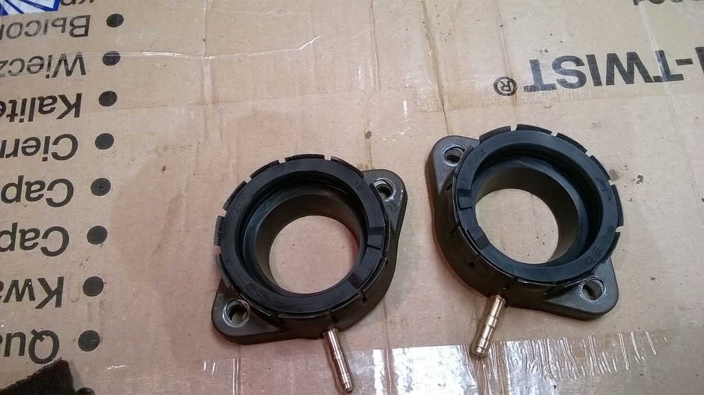

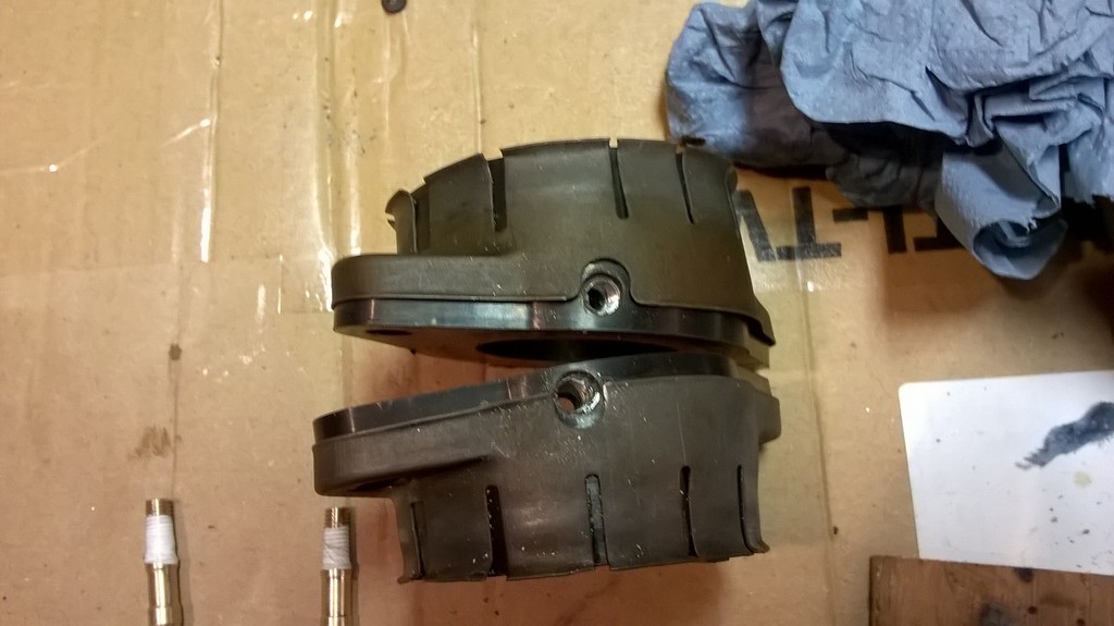

The carburetor holders with the vacuum plugs issue was cleared up by the other members of the group. I also found, ‘’through their help’’, a synchronization attachment port, and these would also serve to attach the vacuum lines, which operate the Air Suction Valve.
I am going with the OEM airbox for a 1980 Kawasaki KZ1000 B4 LTD.
These ''New'' carburetors are Mikuni RS34-D21-K. and I believe to the best of my knowledge, they are not constant velocity, as there is no butterfly valve in the throat section. These are flat slides.
The engine is not installed yet, so it’s difficult to tell how long the boots should extend between the airbox and carburetor. I don’t think anyone can help, until the correct measurements are confirmed.
In the meantime, I’m trying to get an idea of what’s available in 55mm, which is the out side diameter on the carb’s. From the possible matches I can then, focus on length.
I know in the end, I will need to modify the airbox openings to accommodate the larger duct boots.
This airbox is a rare part to be found, and will hate to change it, from OEM spec.
The Kawasaki 750 (early 80ties’) has the diameter I need, but not sure of the length…these look kind of short.
Suzuki GS 1100 G, GL, GK also have the proper outside diameter, which is 55mm

Daveo has a similar build. You might want to check it out. I used large hose as ducts. When I get home I'll measure the ID of the carb holders.

I was also thinking about this Radiator hose modification, but I'm looking to see if there is something out there with the least modification , for a clean result
This was my back pocket default plan.
There was a place on the web , that has all the stuff to mold your own, using silicone casting molds....and when finished is an exact replica of the part
