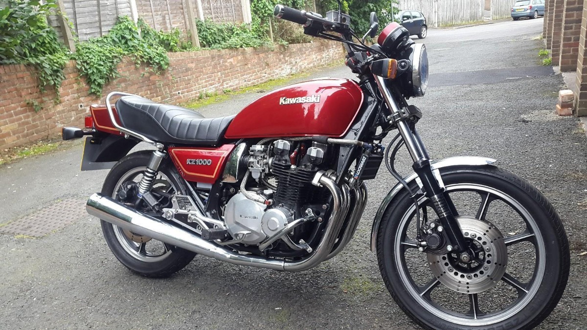

I have a Z1000 J1. All four carbs should be the same. The J1 came with two slightly different carbs. One type had the coasting enricher, the other didn’t. It looks like a previous owner has replaced one of them. That said, I wouldn’t think that would make a lot of difference provided mixtures were all set up correctly. On my bike the vacuum comes off two carbs onto a “T” piece then to the fuel tap. The other two are blanked off with rubber caps. Make sure all your float levels are properly set, and make absolutely sure you blow carb cleaner then compressed air if you have it, thru every orifice these carbs have. I think I once posted pictures of my carbs on here, although that was a while back.

- McZed
- Posts: 45
- Thanks: 12
The following user(s) said Thank You: aquaholic
