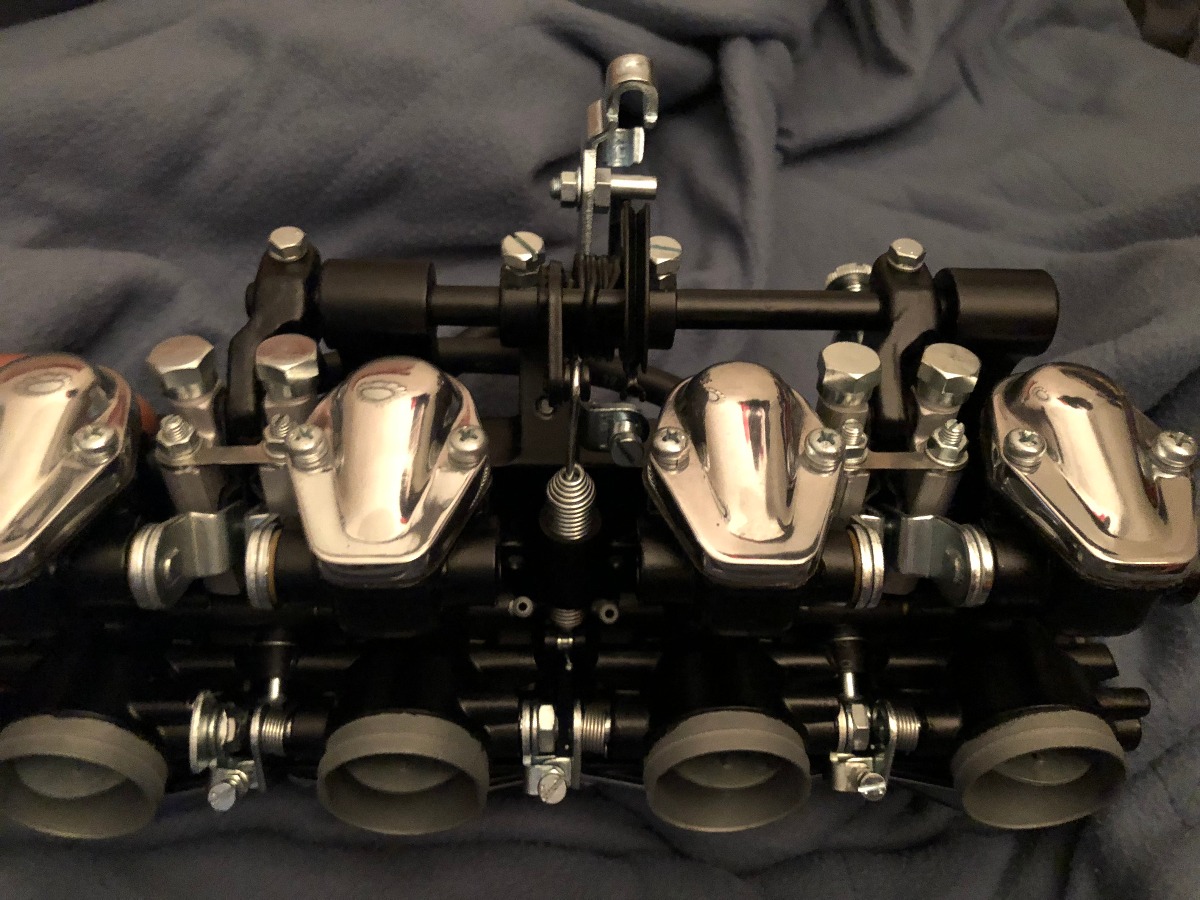

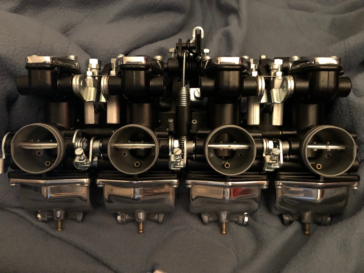

On the particular bike I have, stock carb jetting is 100 mains 40 pilot. I have Lossa engineering 4 into 1 pipes on my bike.
Theres a guy on ebay who sells rebuilt carbs. By all accounts, he does an amazing job. I bought carbs from him and he said he woudl rejet to accommodate my 4 into 1.
He sent the carb rack back and it looks great but the stock jet are still in there. Hmmmm. Thoughts? These are the carbs

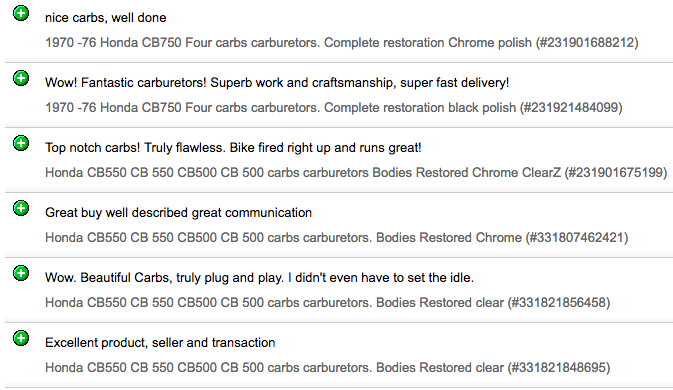

31 Dec 2017 09:32zed1015 wrote: Anyone who claims they can jet some carbs off the bike to suit your pipe is talking crap which is probably why they came back stock.
They can guesstimate but they will still need to be on the running bike to get right.
May as well start with stock settings and go from there.
If it's just a less restrictive pipe then go for a few sizes up on the mains ( say 115's ) and work down.
You will probably end up closer to 105 or 110's
Also may also need a tweak on the air screws to fine tune the pilot mix.
I guess youre right. But the reviews from customers made me a believer. See below:

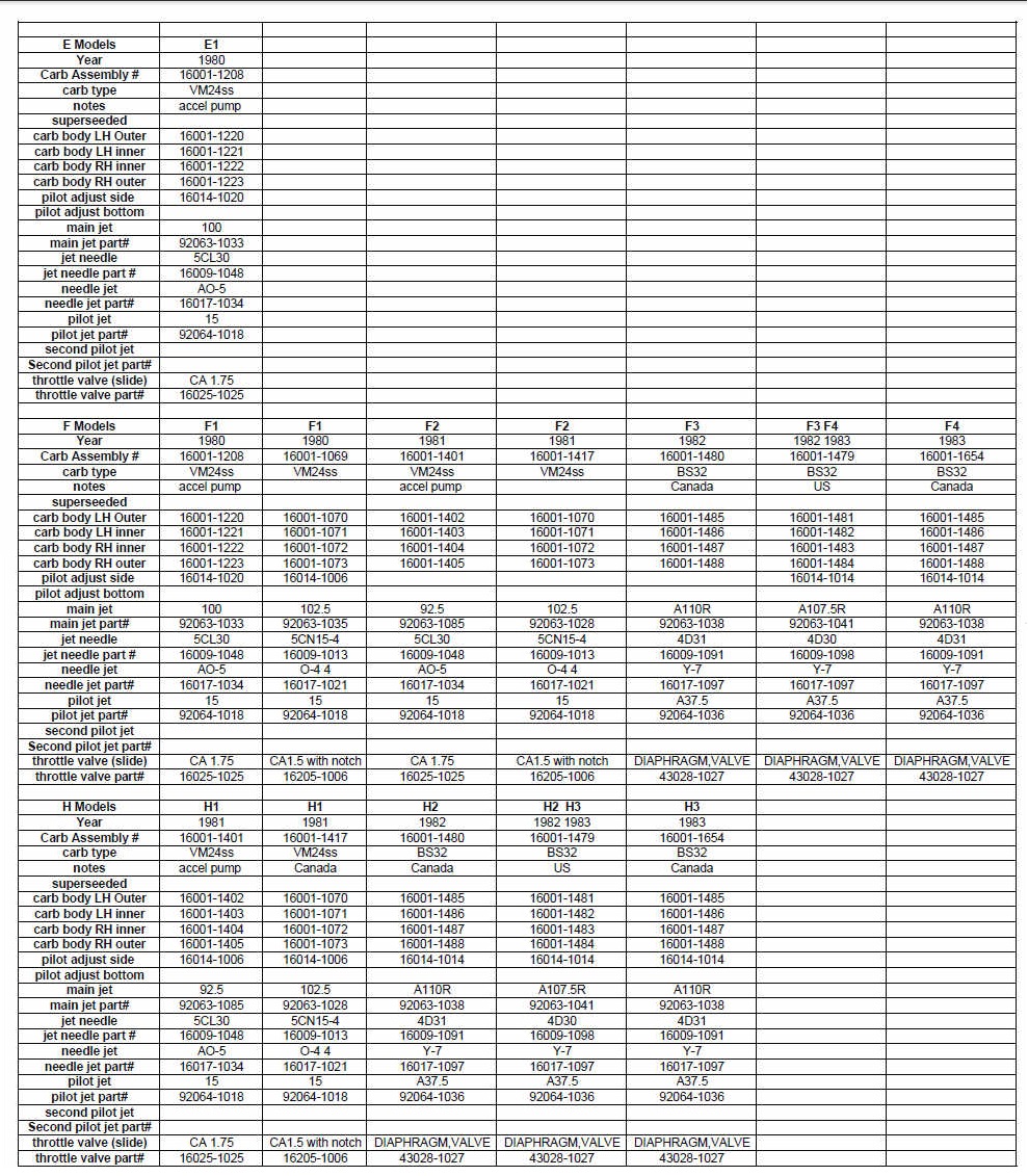

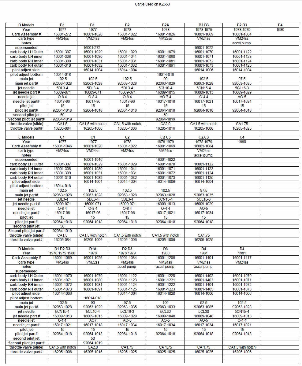

01 Jan 2018 05:51650Dude wrote: On the particular bike I have, stock carb jetting is 100 mains 40 pilot. I have Lossa engineering 4 into 1 pipes on my bike.
What model bike are you talking about? KZ650 models did not come stock with #40 pilot jets. See charts below. Also, please add your bike's exact year and model to your signature line as that helps avoid confusion. Ed
