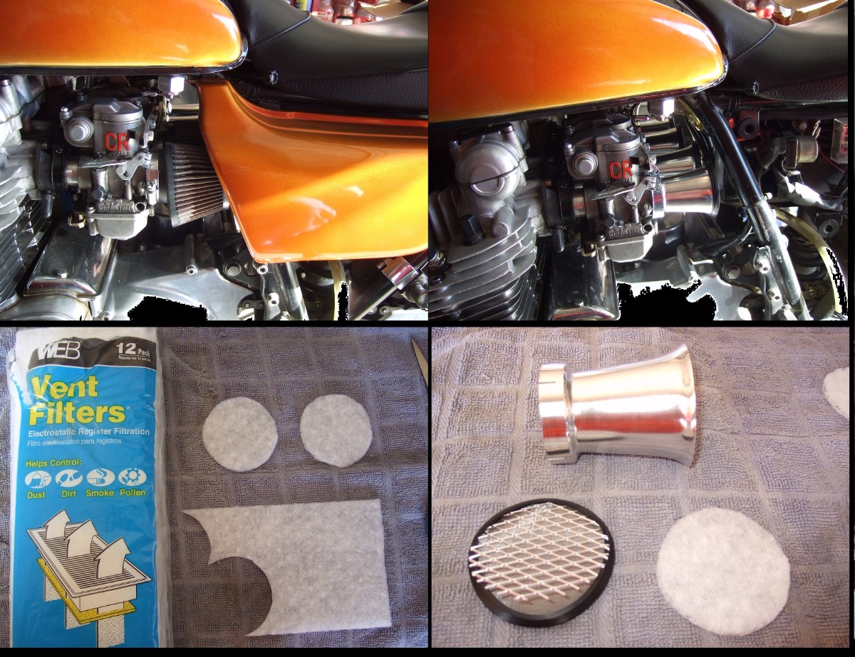

We’ll see how these vent filter additions hold up….
They come with fine and course metal mesh but felt needed dust fiber mesh so came up with these filters.
Have to admit, looks pretty sweet!

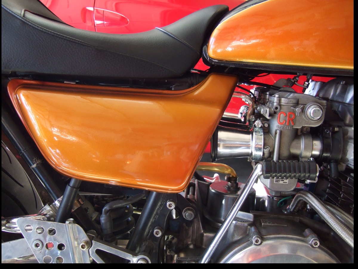

The fit is really nice and the clamp widths are perfect for the small intake lips on the CR's that was always a PITA using K&N filters.... Mine are the 60mm (2.3")....
Just got back from a 50 mile run, pulls real nice mid range and the idle seems smoother....
Due to our heat, I normally need to idle ~ 1200-1300 but with these puppies, down to 900-1000 no issues, stumble etc....
