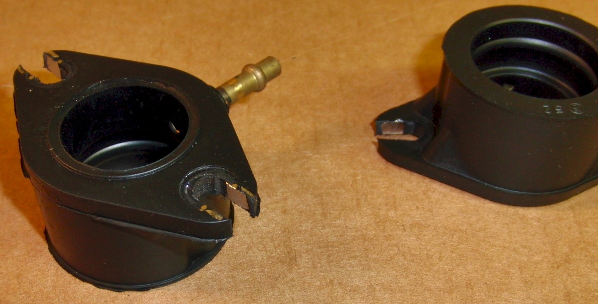

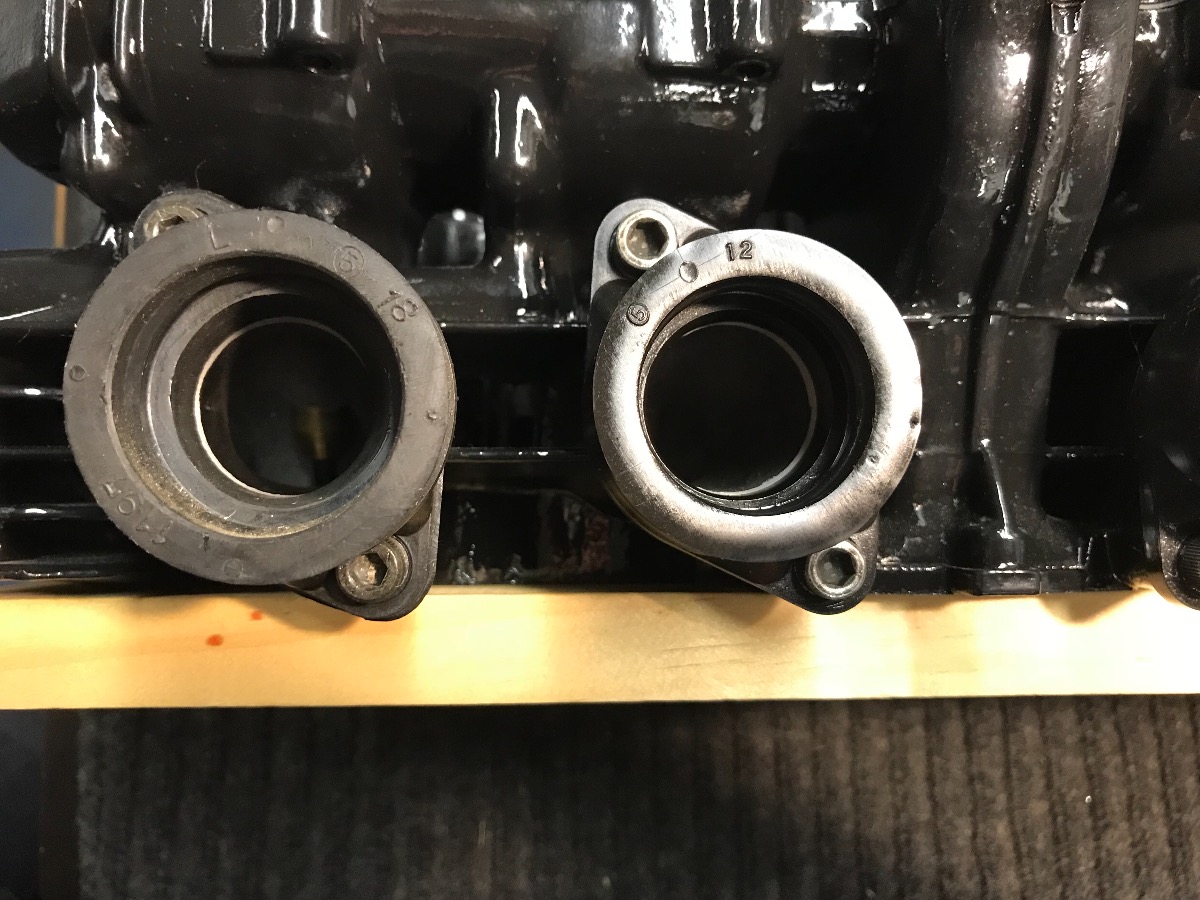

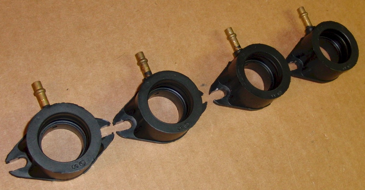

Re: Modern carb for z550 1980
18 Nov 2017 10:28From what you've posted before, I don't think the Zephyr intake boots will mount to his early Kz head. The later Kz intake boots don't mount because the bolt spacing is different. The later intake boot bolts are farther apart to accommodate the larger diameter boot. He would have to get some custom made intake boots, but they would be tricky to make since the bolts would be interfering with the cylindrical part of the boot.Daftrusty wrote: ...
Zephyr zr550 cvk30’s are the proper size but are becoming difficult to find and expensive if you do.
You will need the offset intake boots from the zr550 as well as they are totally different size and offset from stock 550 carbs.
Running pods on the first generation Tk26 CV carbs is not hard. The Dynojet kit makes it pretty simple. They run about $100 ~ $150. The Emgo pods don't interfere with the breather ports on the TK26 and work without much trouble. But none of this really matters to the original poster since he won't easily fit boots to the early head that can accommodate the later carbs.
The original TK22 carbs on the early Kz550s are about as simple as any carb can get. There are only four variables to play with: main jet, pilot jet, needle position, and air screw setting. I really don't think you would get a simpler carb for that bike.
I think a set of CR's might fit if you can get the right outlet spigots for those carbs. But that's a lot of money.

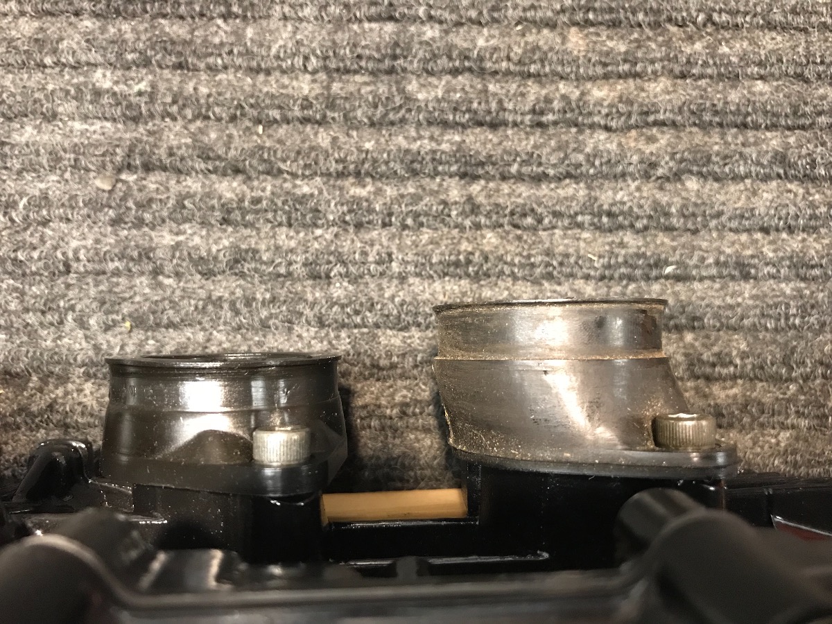

18 Nov 2017 16:07loudhvx wrote: From what you've posted before, I don't think the Zephyr intake boots will mount to his early Kz head. The later Kz intake boots don't mount because the bolt spacing is different. The later intake boot bolts are farther apart to accommodate the larger diameter boot. He would have to get some custom made intake boots, but they would be tricky to make since the bolts would be interfering with the cylindrical part of the boot.
You make a good point that was unknown to me. I wasn’t aware the intake boot mounting bolts were differently spaced than the 84-86 gpz550’s. I know the zr550 intake boots bolt right up to the gpz heads, but I did not realize that the early 550’s had tiny intake ports.
Important information to know!

21 Nov 2017 09:13 - 21 Nov 2017 09:22
I didn't get a precise measure, but the bolt spacing on the first gen. Kz550 is nominally 46 mm c-to-c.
In order to use first gen manifolds on a later Kz550 motor, I have to cut slots because each bolt is about 5 to 6 mm further outward. The mating surface contact from head to boot is also reduced a little, but still seems pretty reliable.
