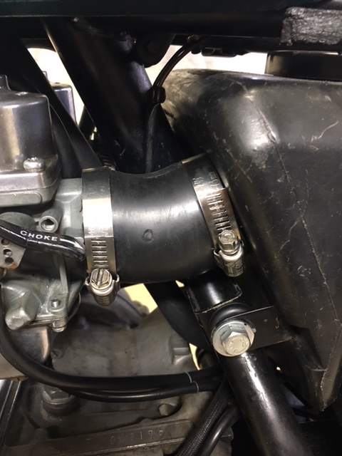

I had trouble finding a set for my '76 KZ400 also. I made a pair from 2" 90* Fernco plumbing fittings which were about 6" long. I cut the hubs off the fittings using only the softer inner section trimmed to an angle to match the airbox. They're a little stiffer than stock but worked perfectly. They're available at HomeDEpot for around $8

Follow up pic of what boots look like. Clamps are temporary, narrow band ones will be used when i'm finished. Right now I'm just trying to get this running correctly before I do a complete tear down to frame and restoration
