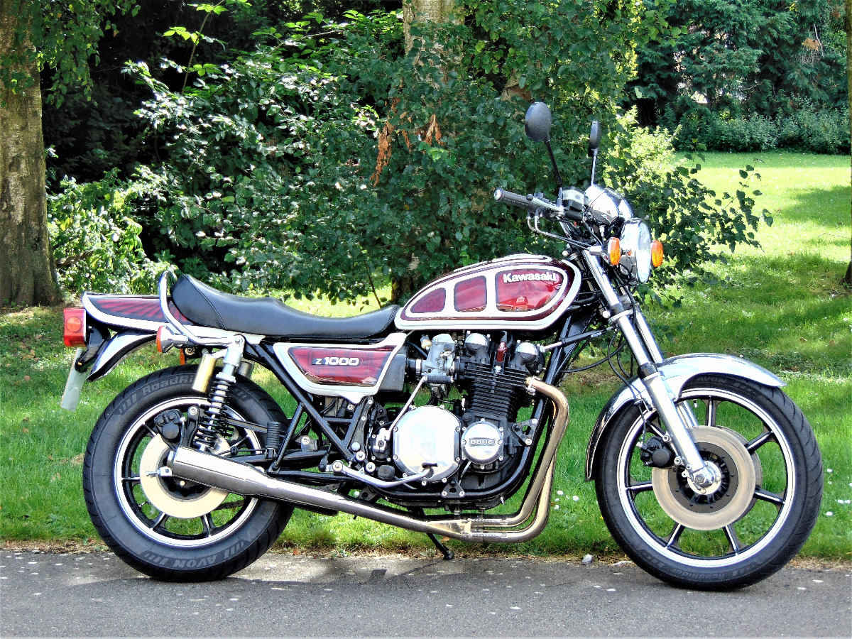

Will you be running with a baffled pipe or open if baffled it may need to have the jets go up a size or two, i have B2 with stock carbs and air box also a one off stainless exhaust with a norman hyde harris road baffle not the quietest, and my jetting is mains 107.5 pilots 20 needle 5cn7 on groove 3 pilot screws 1+1/4 turns out,, it runs seemlessly right up through the rev range, as you can see it looks a little different to a standard ltd.
